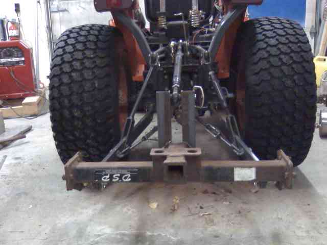

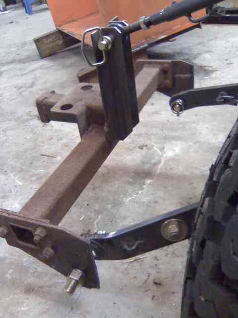

I wanted something that I could pick my trailer up off its jack and move it around so built one that attaches to the 3pt. Actually just got it together yesterday so haven't tried it out yet. I did stick an 8 ft length of square tube into the receiver and went and stood on the outer end and nothing gave at all so I think it will be strong enough to move my trailer around empty.
I got the receiver off an old truck for free so really only out of pocket for the lift arm pins and a couple of feet of angle iron.

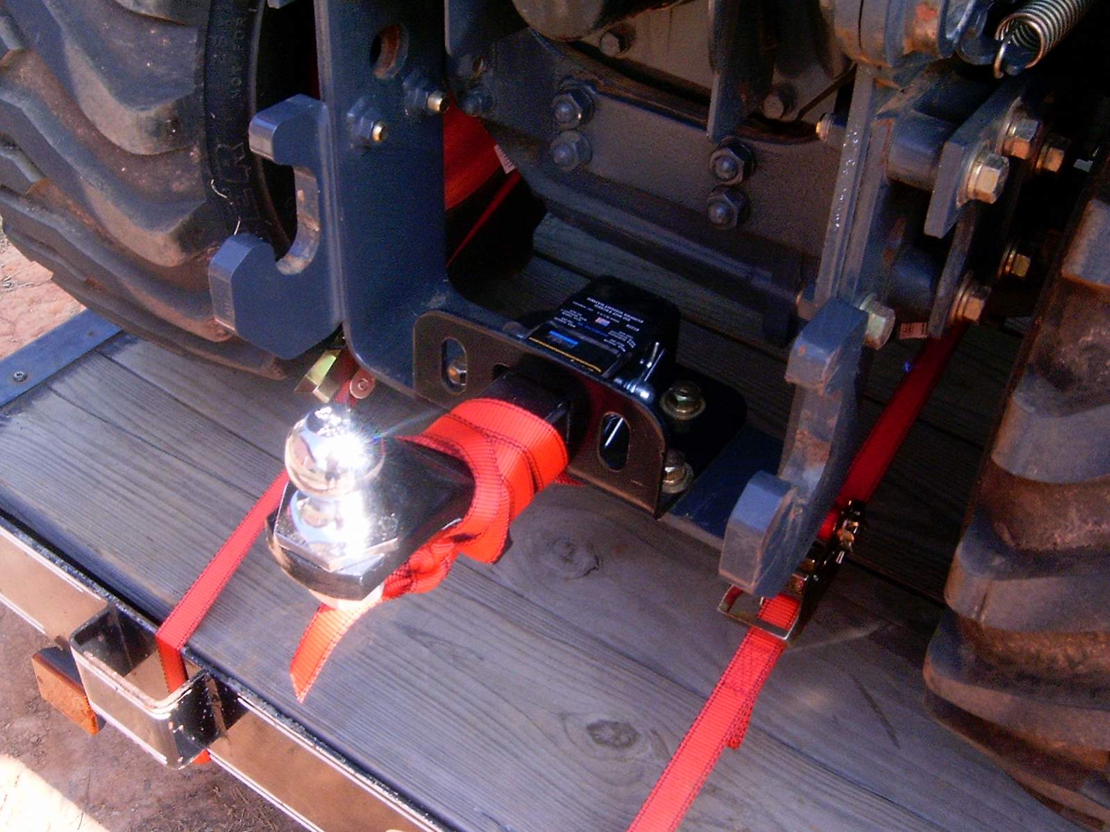

Here are the pictures of the BXpanded.com hitch installed, nice tight fit, just the way I like it!!!
Stuarth, doesn't that arrangement put a lot of rotational force on just that one pin, and wouldn't that cause the whole hitch mechanism to tip downwards, as opposed to a situation where, say, there are two vertical pins, one behind the other? Also, what is the rated hitch weight for the hitch?
   / BX25 2" Receiver Hitch #14
I'm not Stuart but I can answer:
The hitch incorporates structural members other than the pin, that prevent rotation in any plane. The pin prevents the hitch from pulling off the back. The hitch capacity is limited by the tractor's stated towing capacity.
