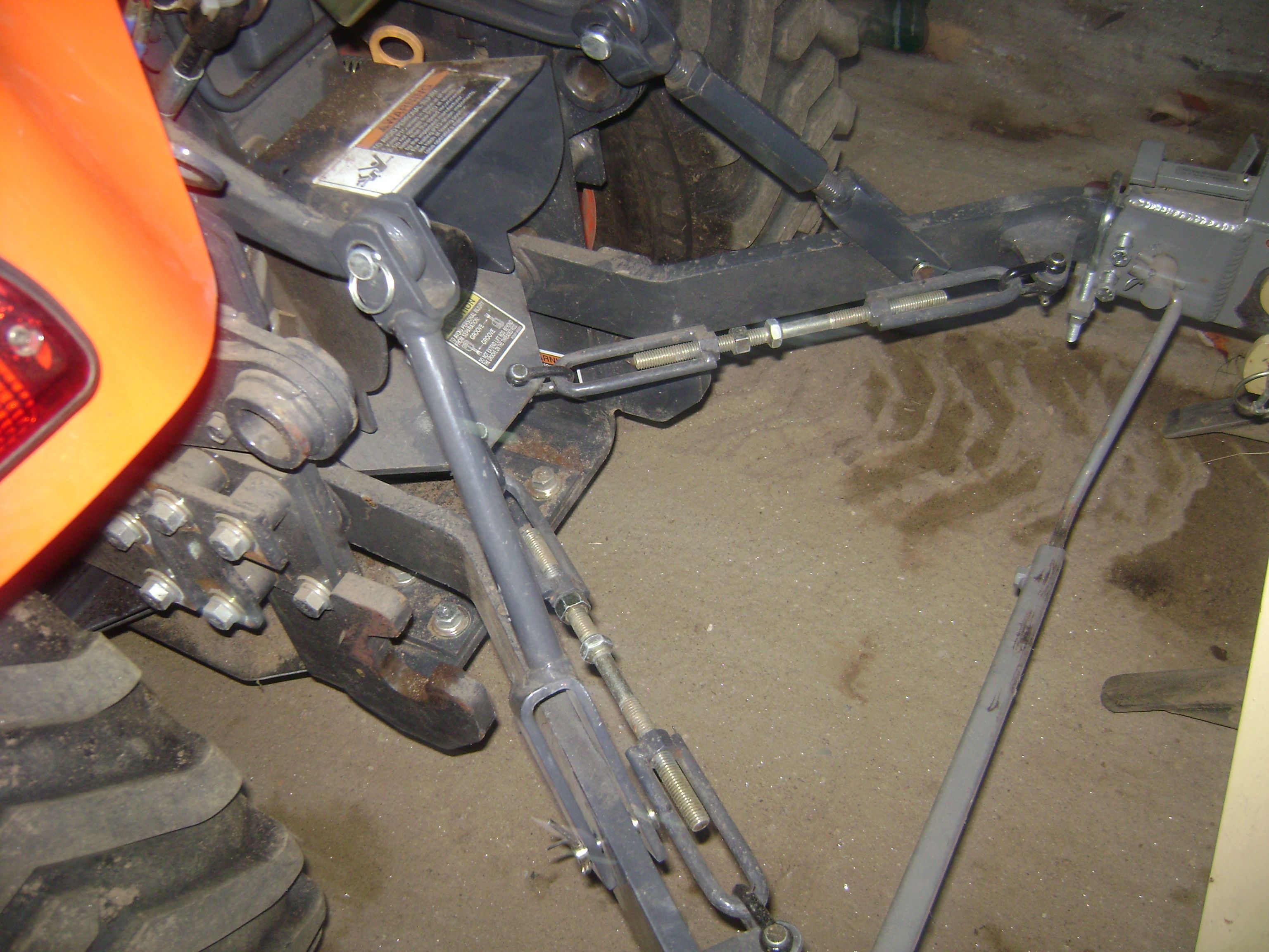

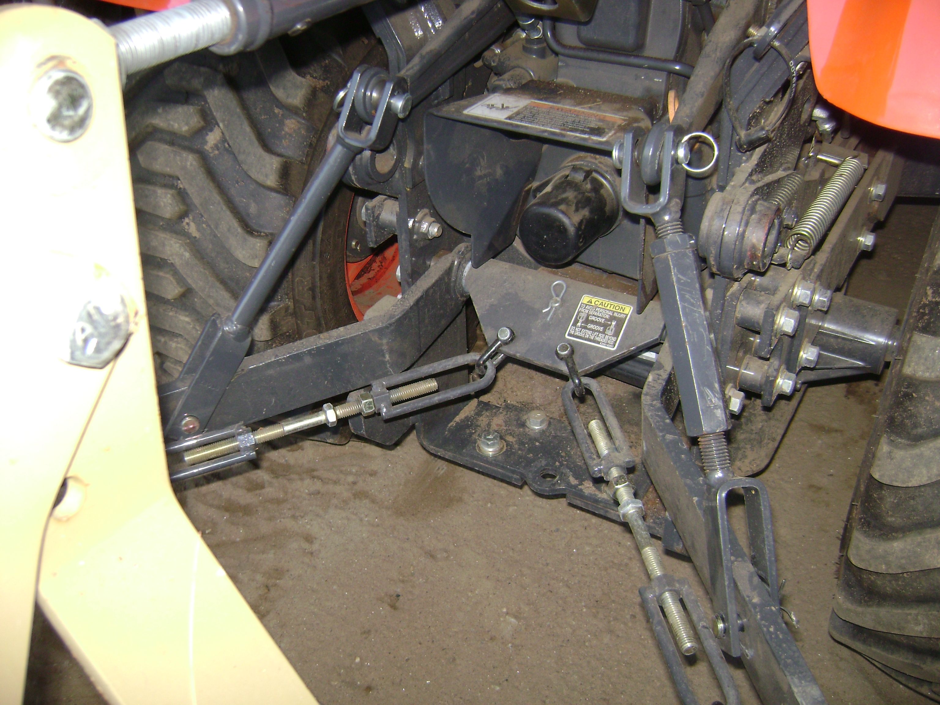

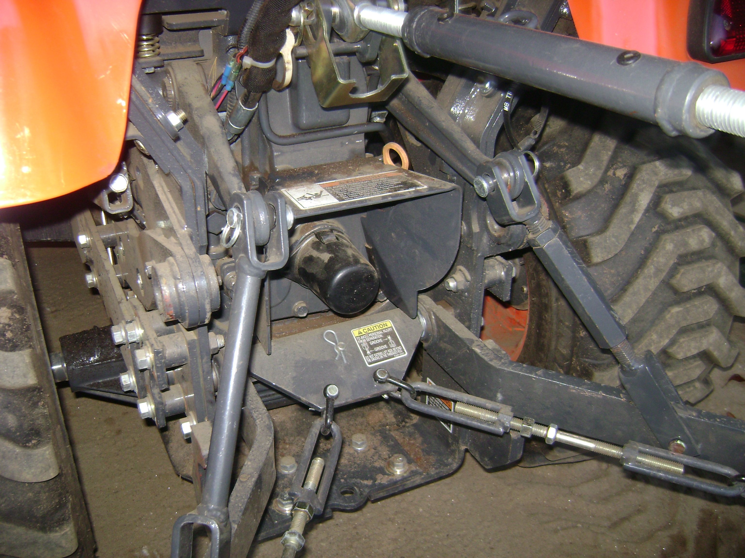

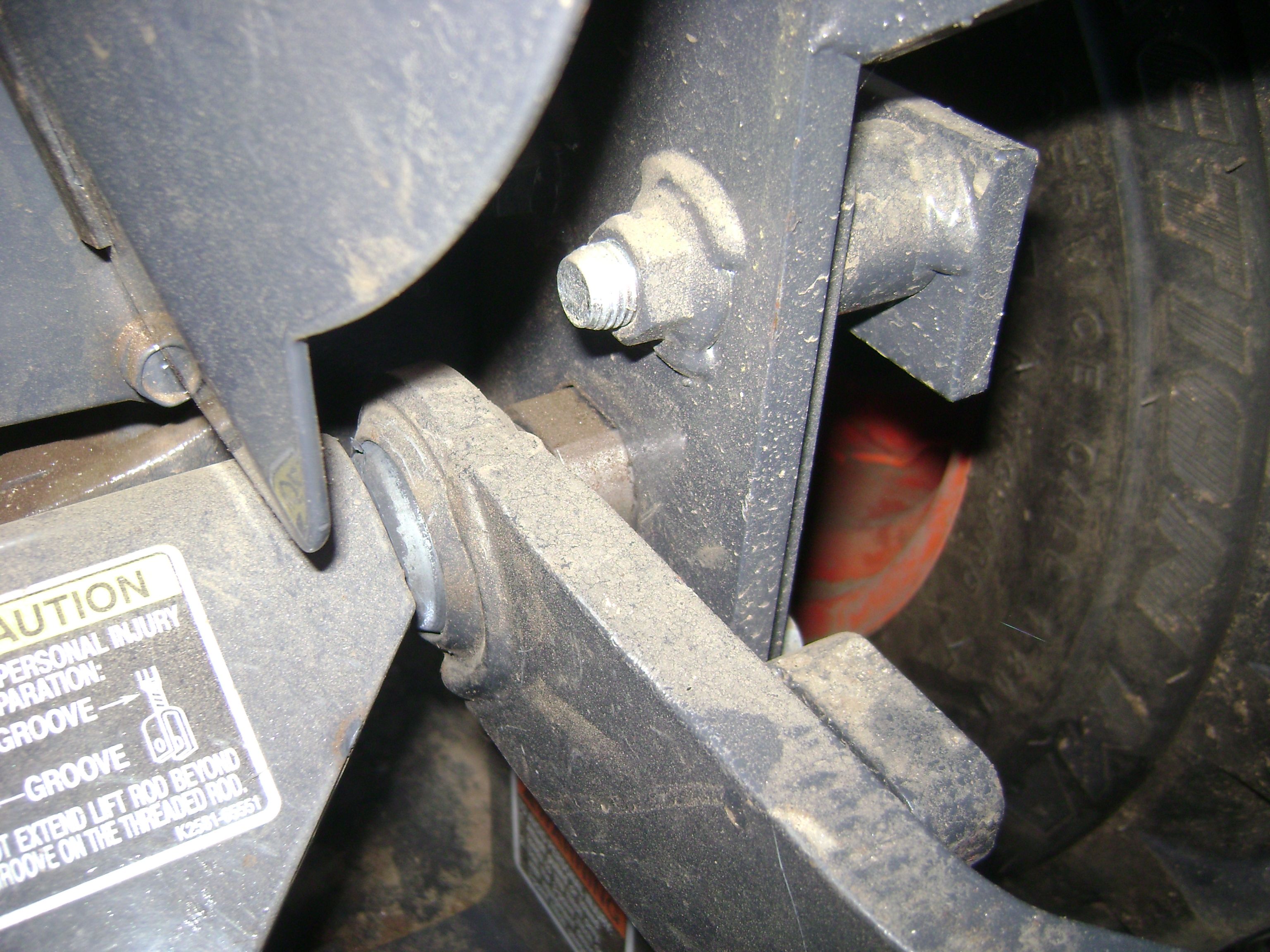

JT, Hope these pics help!
1. Shows 3PH installed on BX25. Note parts in your box!
2. 3PH shown attached to back blade. Key is placement of large metal rod held in place after install by pin and cotter pin. When removed the part with the caution label {Grey} can be placed over the rod after the rod is in place.
3. Rod is held in place by two oblong shaped (note flat sides) inserted into side frame holes with a similar shape. Rod slides through center hole until {Grey} part covers the rod. Key installation step is putting rod in place as shown.
4. This shows view from above including right and left arm connection. Adjustment threaded rods are tightened as required for the attachment being used.
JT, Any questions? Need more pics? Good Luck! :thumbsup:
