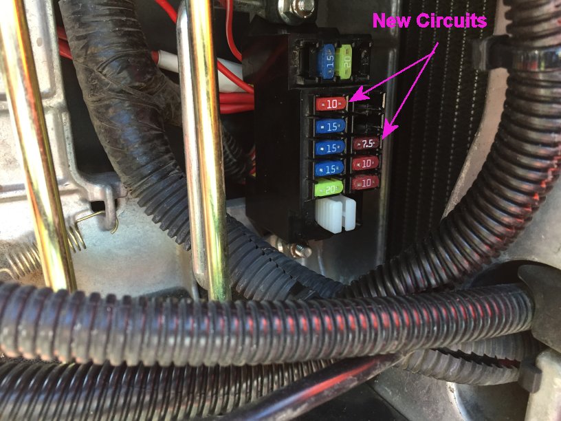

So I get what you are trying to do. You will have a neat installation, but couldn't you have done a quick and easy thing like this?
snip
Ahhh grasshoppa'! You have learned how to think like an Artisan!
Alas this EXACT thinking was a miserable failure. This is exactly
what I did, I kid you not, THEN I realized the silly cover will not go on! BLAST!

Get this figured out? I put an auxiliary fuse box in my new L4060. Have everything all wired up except for tapping into the OEM fuse box to power the relay with the 60@ fuse up next to the battery. Have the last bit of wire ran & dangling there. Planning on tapping into the 5@ radio wire as that's ignition switched. Really hate to do that cheesy vampire tap again. Hoping somebody has figured out what connector is used so I can pop the existing one out & either do a nice splice, or use the connector itself to crimp both wires.
   / BX25 FUSE BOX Wire Connectors ???
#23
Get this figured out? snip
Yes,
Fuse boxes and fuse box terminal ends are built out of unobtainium.
Read my details in this thread it explains what I had to do to find
terminal ends. (I found a whole fuse panel for sale w/ all the feed wires
cut on Ebay and used those parts
.) Be sure to take notice of the different
"FEED" terminals, you can have one wire "IN" and 2-3 "OUT" off the one feed wire.
This pic shows the finished product, the cover snaps on OE style now.
