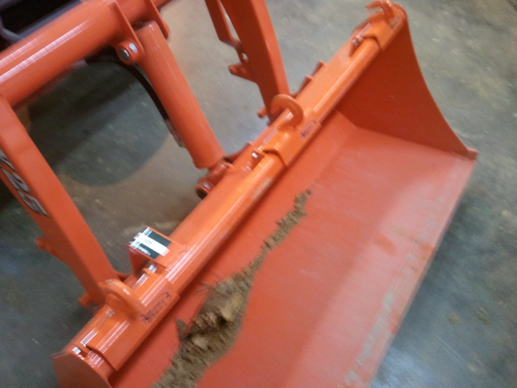

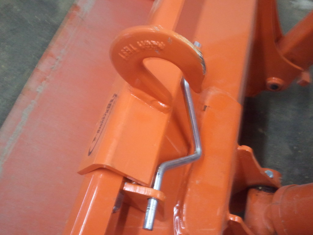

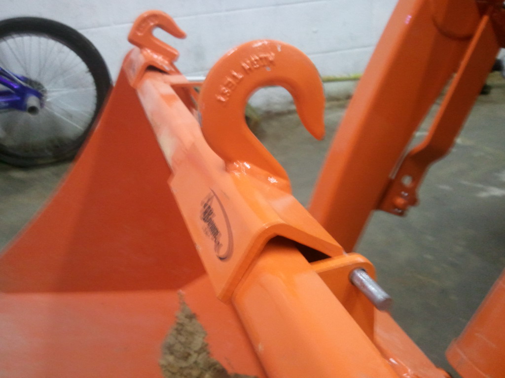

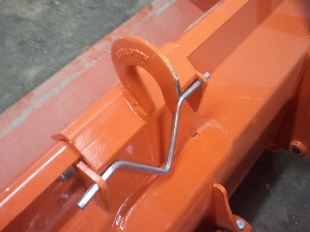

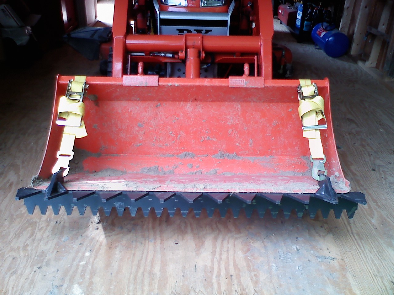

I can't speak to the Hydraulic Test & Adjust Kit, but I've got some of the Quick-On Bucket Hooks for my BX-25. Love 'em! :D I've got two of the 3/8's chain hooks and one slip hook. Already worn the paint off of them and haven't had them two months! Photos enclosed, you can PM me and I can send some hi-res if you want?
Only tricky part about 'em is that there are different bucket lip sizes for the BX. :confused: When you place your order, Harry will be in touch to get you straight on what size you have. And speaking of Harry, good people right there! He's answered emails from me at 6 in the morning and 7 at night... :thumbsup: Can't argue with that customer service!

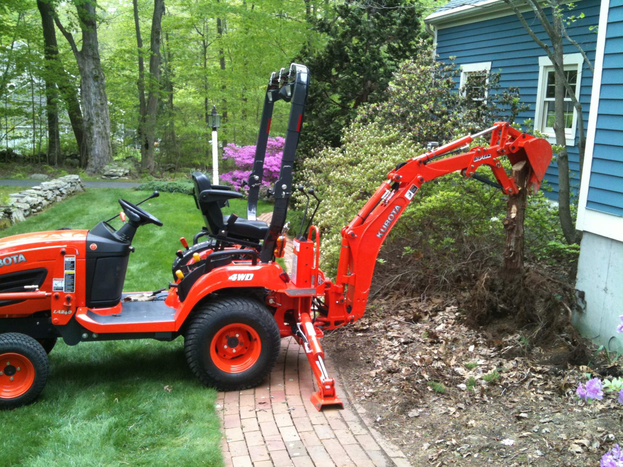

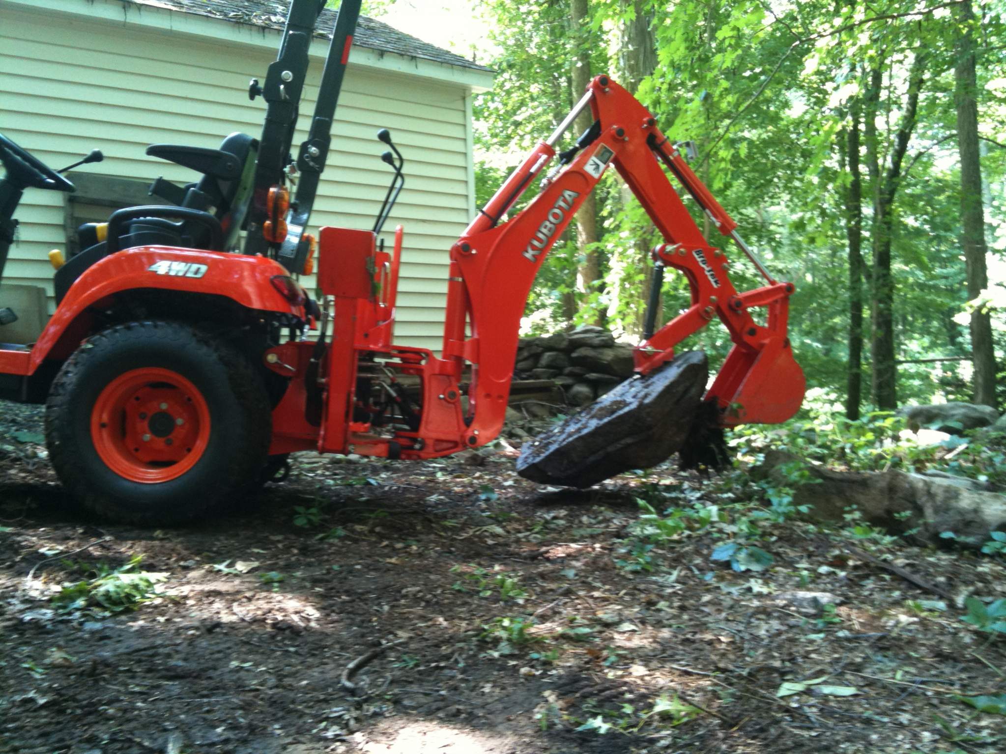

Lots of good advice already and I'd agree on getting a 60" rear blade vs 48". That's what I have and it just covers the tractor's wheels when angled. Don't think you'll find the 60" too big at all.
I'd also suggest a thumb for the backhoe. I bought the Bro Tek version but there are other choices as well. Really helps for picking up rocks or for small tree removal. I leave about 4' of trunk after cutting small trees, then use the FEL to push in several directions, then the thumb clamped on the trunk to push/pull it. Loosens them up better than digging them out alone. Take a look.
