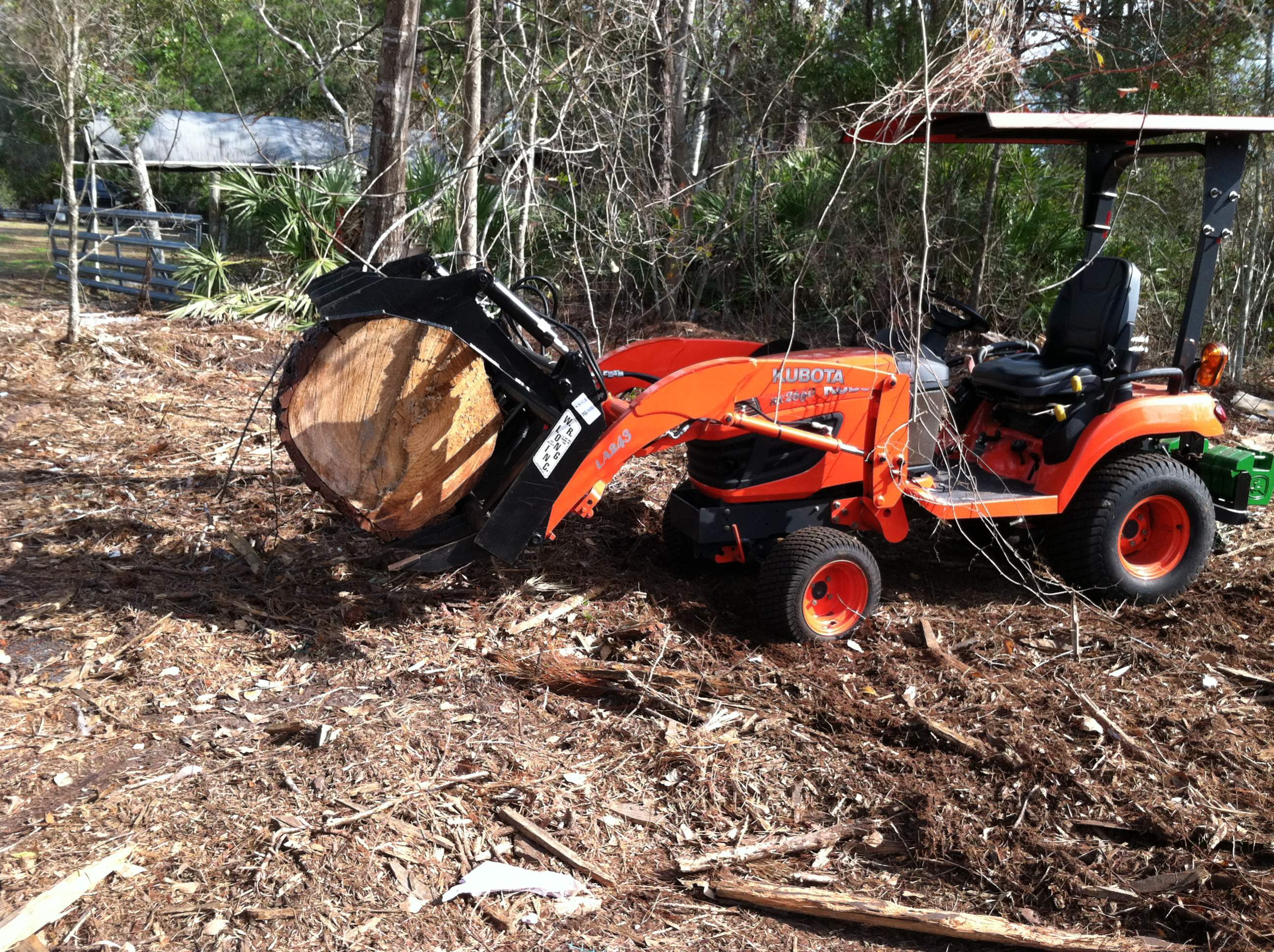

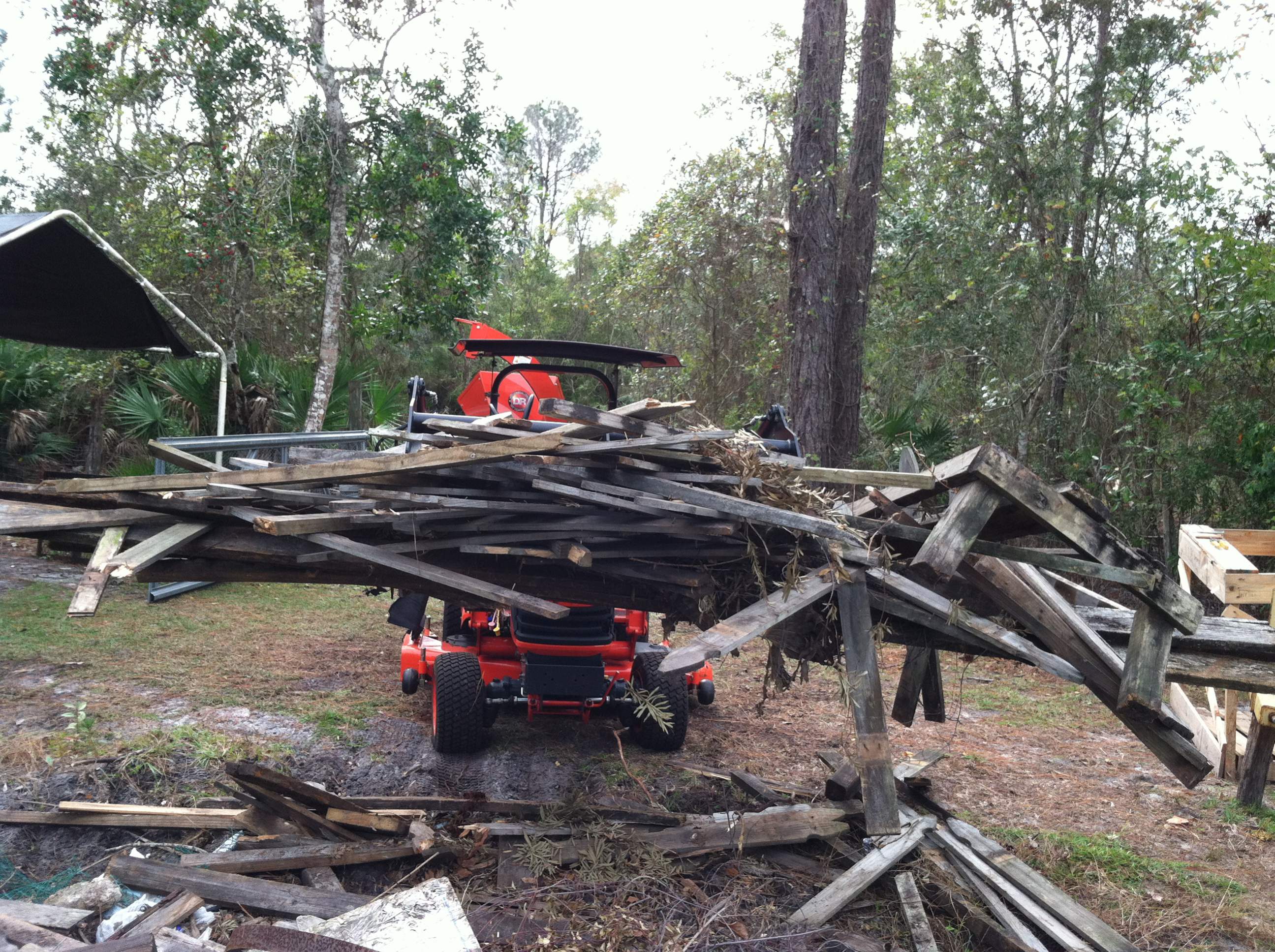

They make a rear remote kit for the BX but for some reason it will have to be modified to fit the ones with the BH. I got one installed to run my grapple on a BX2660..amassing what these little tractors can pick up..
Astanton how do you like the B3030's cab? I'm thinking about up grading to the B3000 or B3030 not sure what the difference is..

Hey Zook, What does your grapple weigh? Looks to be on the + side of 200#.

Zook - I am amazed the little bx can lift that grapple while carrying a load. That grapple looks awesome... and BIG! :cool:
