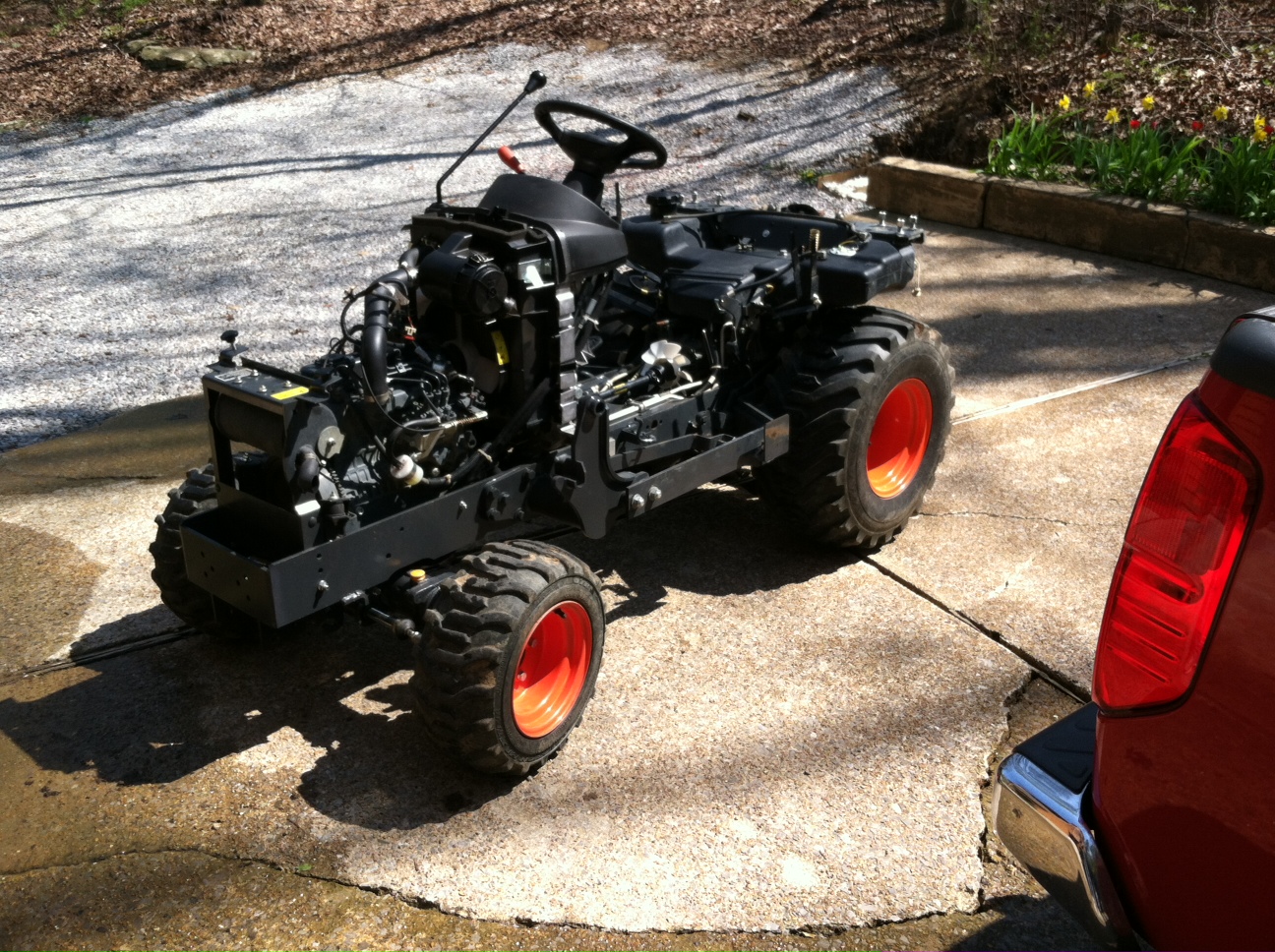

Well I completed surgery and installed a new fan today. I took my time and got it done within 5-6 hours. The only trouble I had was where the bolts thread into the grab handles in the back on the rear fenders. One of the inner nuts came out so I epoxied it back into the plastic. A lot of work for that little fan...sure wish someone like Multi-Wing America could come up with a metal version for us. I put my hand behind it and it does give of a good bit of air. Don't forget to keep the fins behind clear of debris.
Here are some picture of her naked with the new fan installed:

I think I posted this some years back, but if Kubota sticks with the fan for cooling the HST, they should make that "hump" or "bubble" just under the seat a removable panel rather than part of the floor board. Would make it a whole lot easier to get to the fan, though you'd still have to disconnect the drive shaft to RR it. Anyway, nice work, and it do look clean under your BX. Did you wash it or something once apart?
Thanks. Yep I cleaned her up good while it was apart. A cover over the fan would have sure made it easier!

Good job, after looking at the "naked" shots, I can get a much better idea of where everything fits under her coat.
