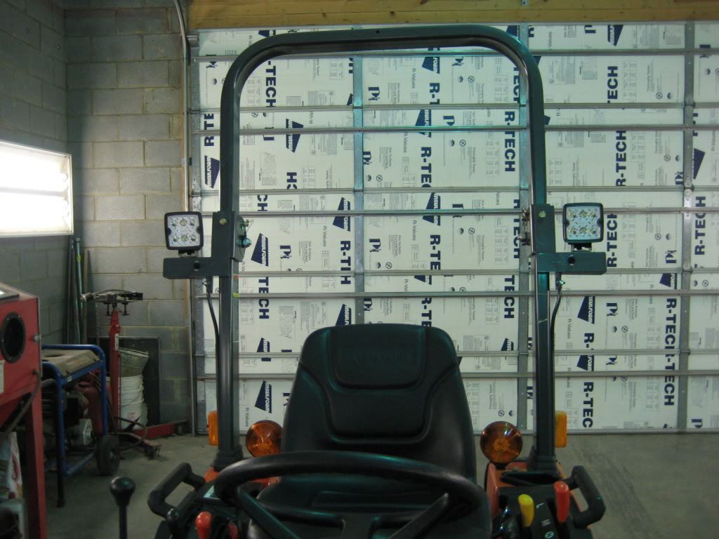

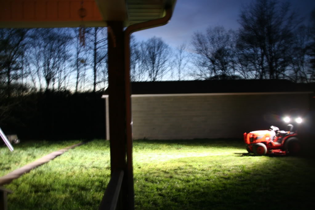

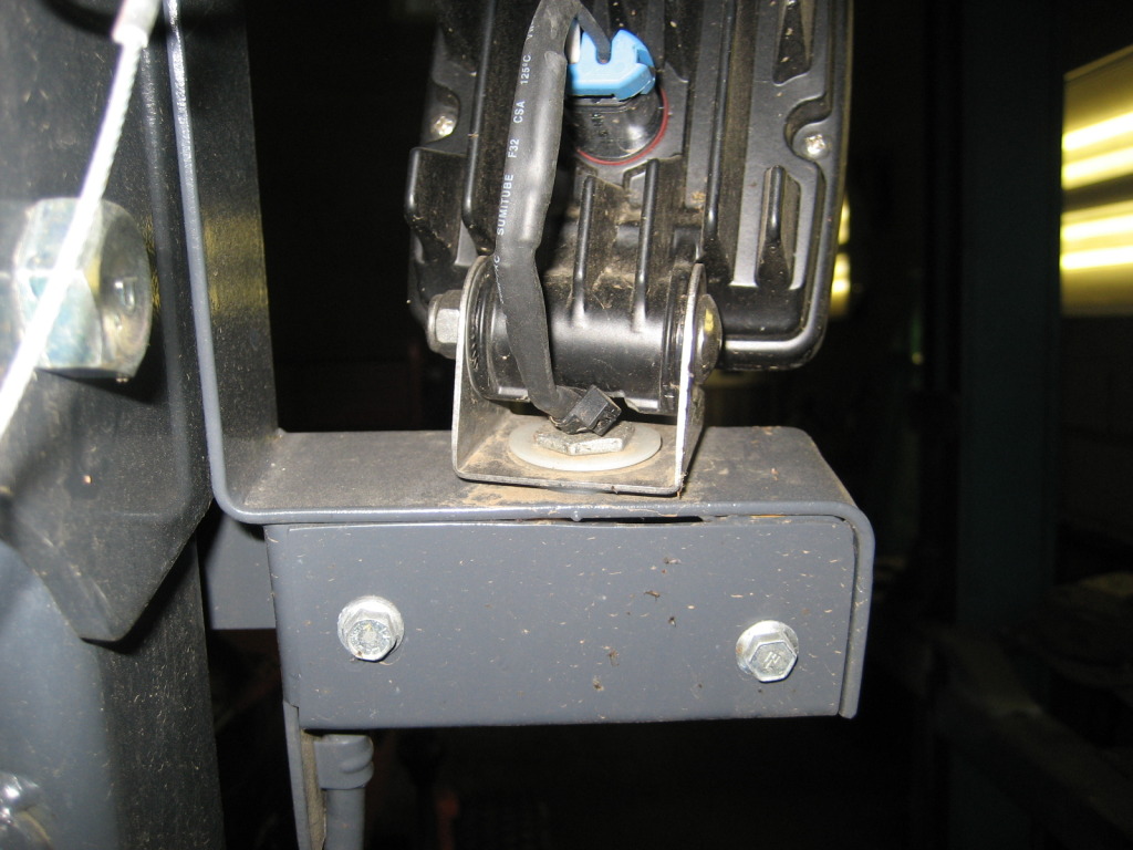

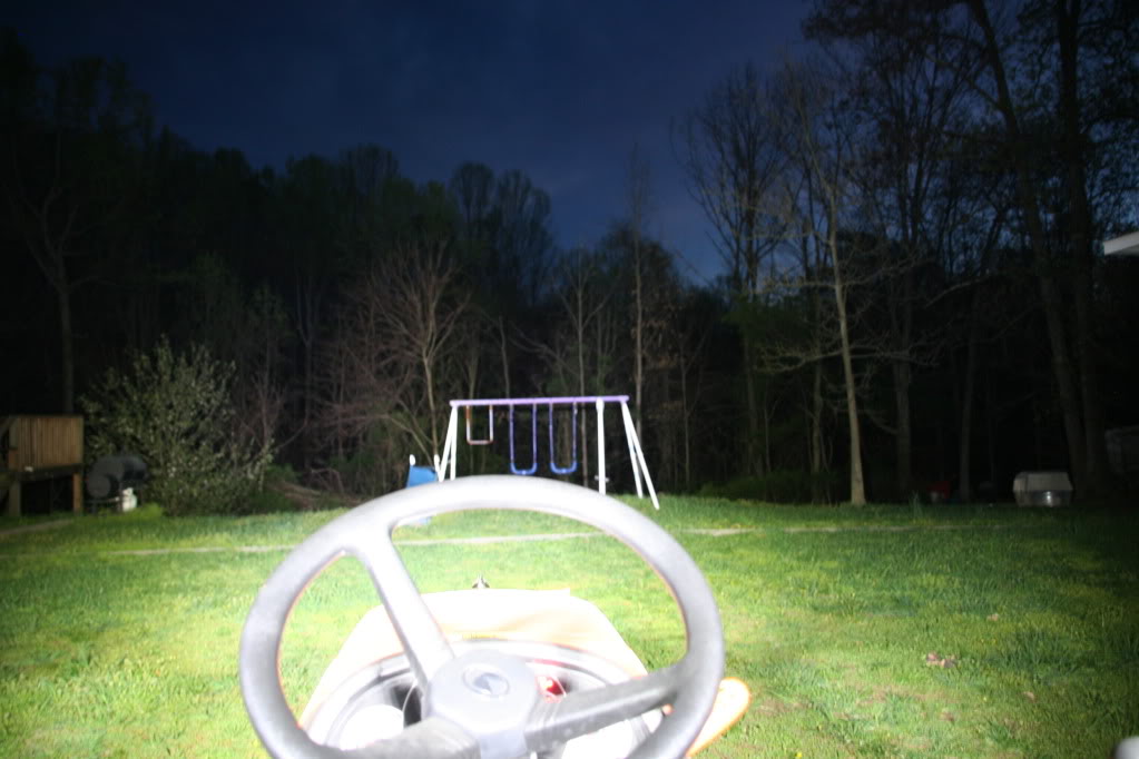

This is what I installed on my tractor. It is Grote led light and they are bright but also fairly expensive. The way I mounted them they turn forward or backwards.

Now that's what I'm looking for. How many watts are each light? Where did you purchase your them? Did you fab the mounting brackets?
Here is a link for the lights. Trilliant Cube 2500
I purchased these from a local parts store I deal with thru work. I made the mounting brackets and also on the brackets I drilled a 1/2" all metal locknut and welded it inside the bracket and ran the wire thru the hole so I could rotate the light with out having the wires get in the way.

Are these the wide flood or flood model?

Unless you have overhead clearance concerns, I'd seriously consider mounting them on top of the ROPS. Up there, they are out of your eyes and you aren't making shadows with your body. I used 2 of the basic 55W trapezoidal for out front and 2 floods in the rear. The are all mounted to a bar with magnetic feet so the whole bar can be removed if need be.

I understand your point, my question is that these lights only come in flood or wide flood. I was inquiring about which version was in the pics. I guess the flood could be considered their spotlight.
