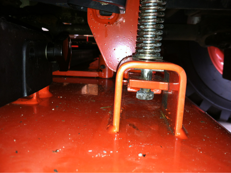

I think I may have the mower set up but I noticed the self balance linkage has about 1/3" play in it. Here is a photo of the left side
And here is the right side
Is this normal?
Thanks
