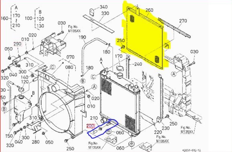

Jack there is a screen between the radiator and motor. You pull it out on top by the radiator cap.
   / BX25 overheating while bush hogging #14
Here is somebody else's pic
   / BX25 overheating while bush hogging #15
Your radiator is plugged with debris. Take a garden hose with a nozzle and spray thoroughly from both sides. Bush hogging kicks up the size and kind of dust that loves to cling to radiator fins. And as previous posters said, sharpen your blades and slow your ground speed.
