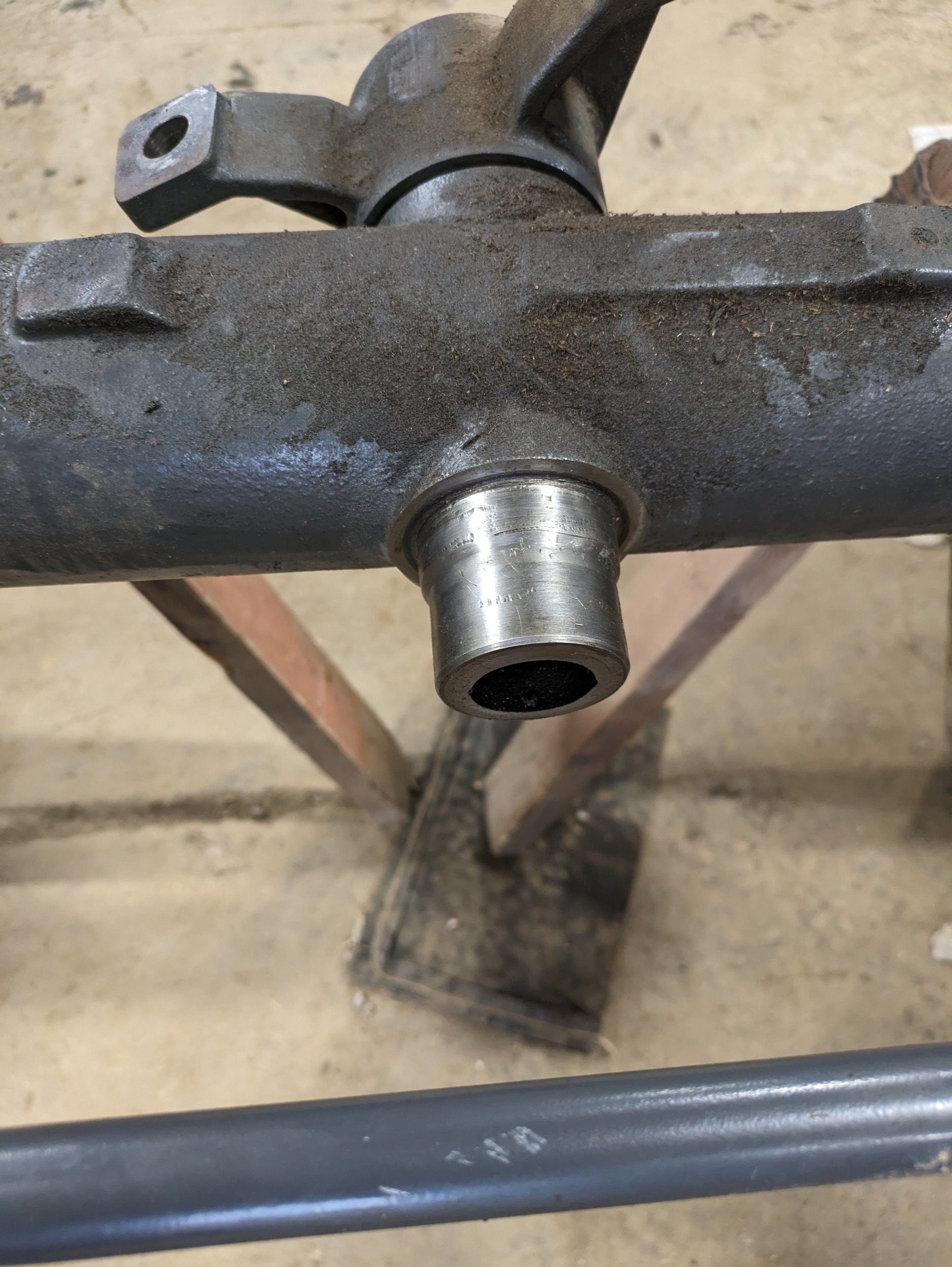

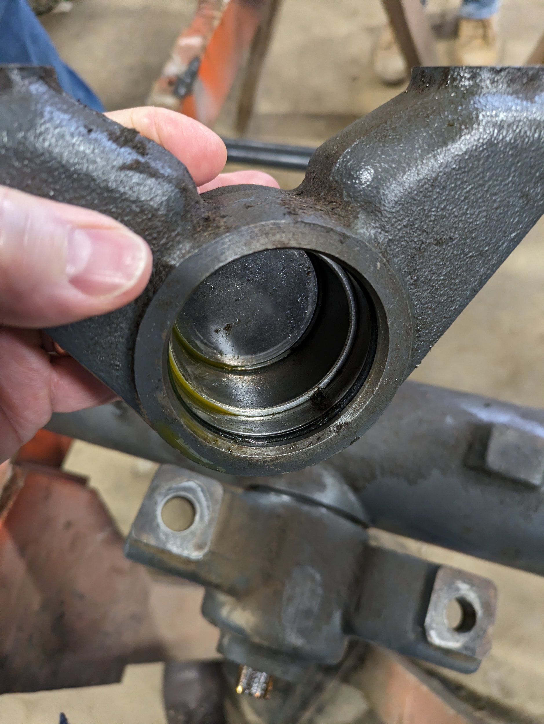

I went to the dealer today and saw the axle. These are a few pictures.

Didn’t see any mention of where the front axle is leaking FROM …
Given your pics above, is it from the axle center pivots ? (Rather than from the bevel gear case pivots on each wheel)
If so I can tell you there is a replaceable bushing in at least the front pivot.
I replaced that bushing in my B2910 @ around 2500 hours.

Thanks! The picture of the axle itself shows the scoring. I was told that this is why a speedi-sleeve would not work when attempted previously.

There is very limited movement in the front axle - yes the scoring is there, and could this be sanded smooth then insert some shims to tighen it up?
Here's the diagram and parts list - appears the housing at $735 is the expensive part - that's why maybe a machine shop and some bushings would be a less costly approach.

So the top of the bushing is where the wear occurs and I suspect the oil level is half way up the bushing requiring the oil to literally splash into the wear area when the tractor is running. Poor design I would think. Thin lubricant (hydraulic oil being anywhere from 10 to 30 weight) has poor ability to "hang" on a surface.
If you run on primarily level ground, I would assume no oil gets to the actual wear point.
I would agree with Carl_NH above, I would throw all three parts (front hanger as well) in my truck and head to a reputable machine shop for hopefully a cure.
