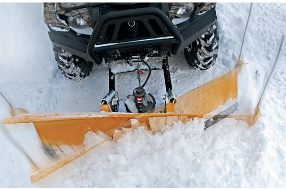

Well, the hard part is done and first test looks good.
I still need to address some "Stops" at the tips of the claws.
Most likely I will weld a couple pieces of angle to the bottom
of the Bucket. Things are VERY solid. You push on this thing and
it pushes the whole tractor, it does not give anywhere on the grapple
assembly or the plow assembly at all. A gentle hand on the controls
and treat it right and I think it will work well for light snow removal chores.
I have the throttle at about 1/2 way in this movie.
CLICK HERE for movie.

That is a slick little video. Where is the white stuff? Can you angle the blade?

Indeed the blade can be angled L or R, as advertised by WARN.
WARN has an accessory called a PROPIVOT that I can add
if I wish. One step at a time.
The white stuff is at my Ranchette in the PNW.

check looks like you are going to get your way...
Tonight a received a Warn ProPivot I found on Ebay.
It was advertised as an Open Box Special. I think all
the parts are here and a few scratches are not going
to sway me to return it so we will do the install.
Here are the basic parts that will allow me to power
angle / turn the blade from the drivers seat. It is
a very substantial unit weighing in at about 33lbs.
(Plus I can lift the plow and use the bucket)
The unit has a contactor that "should" be kept in a dry area
so I ordered up a small pelican box to throw that component into.
Should be the cats azz, wait, I mean the cats "meow" when down. ;-)
Additionally the "Stops" where the claw tips meet the bucket
have been fabricated and installed.
Pics coming soon, same Artisan time, same Artisan channel...
