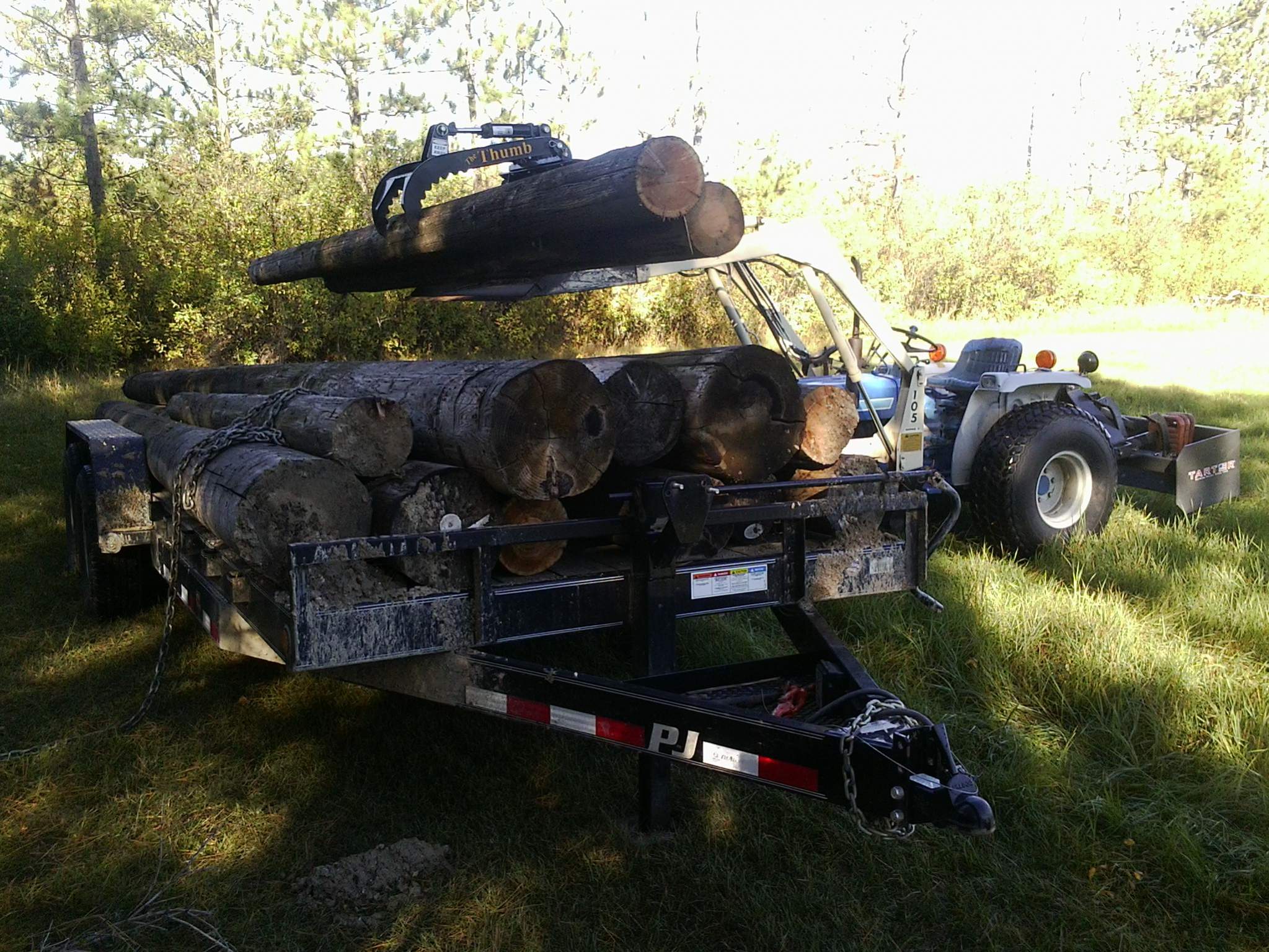

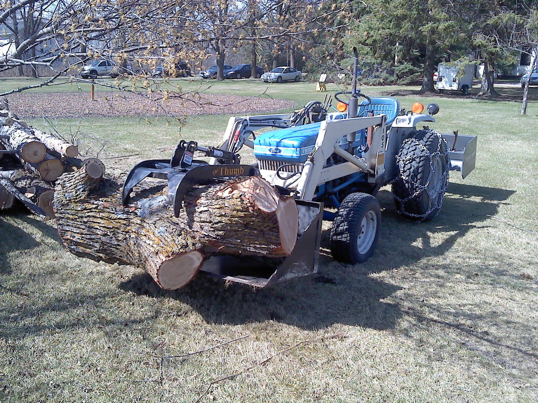

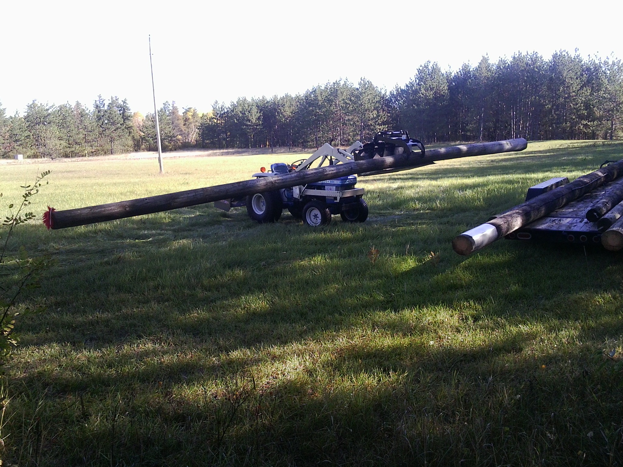

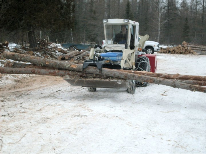

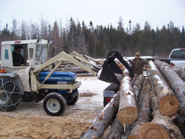

The Thumb is very adept at handling logs, both big and small. That's one of the jobs I really need my thumb to excel at, as I have absolutely no interest in manhandling those big, heavy, bulky items.
Joe
What you have is a grapple not a thumb. Thumbs go on a backhoe. Grapples go on the FEL.

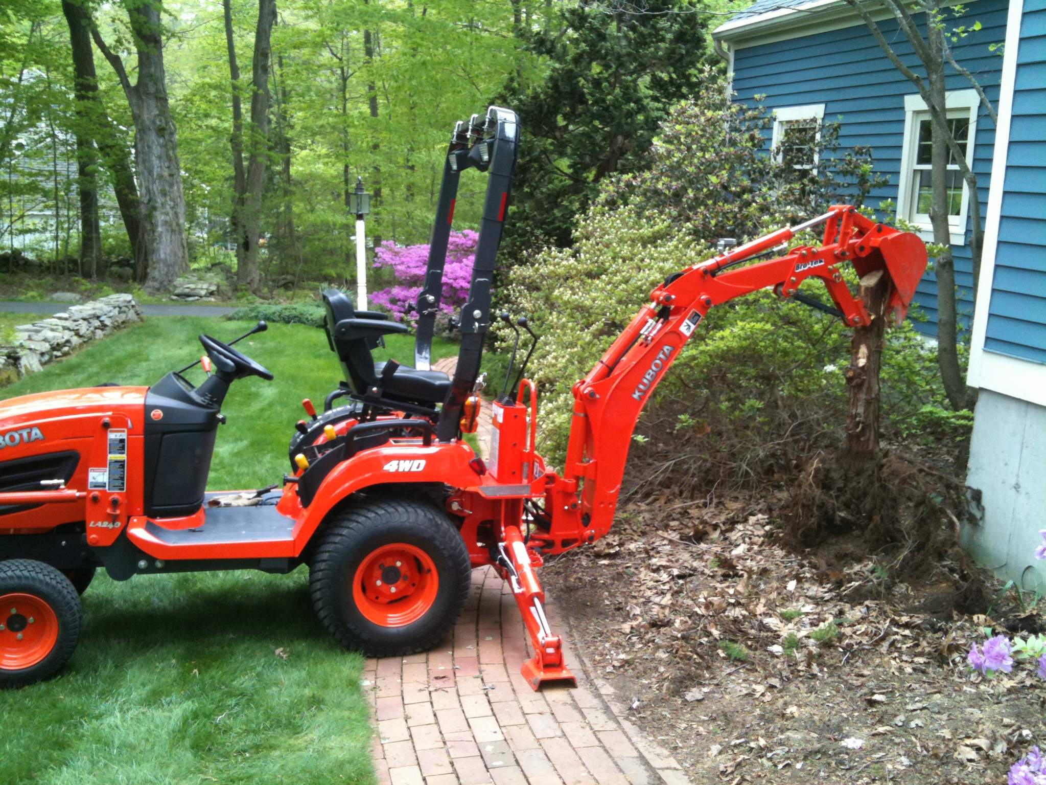

I should have referred to my current Avatar pic which shows my BX25 picking up a tree stump using the BH thumb. The shrubs in front of our house were overgrown after 20 years. Would have killed me to pull those all out with a pick and shovel. Anyway, here's a full res version of the pic. Threw in one using the thumb to move a good size rock too, though I'd probably do that now with the grapple.

Gary, I know what you are saying, but the product name IS 'The Thumb'. Not a BH thumb, but a Thumb nonetheless. :D
What he said! ;) Actually, the wording of the original post left me questioning which "thumb" the OP was referring to. I figured a few pics of my "thumb" handling some logs could still get a few gears turning as the OP ponders what might benefit his particular situation.
