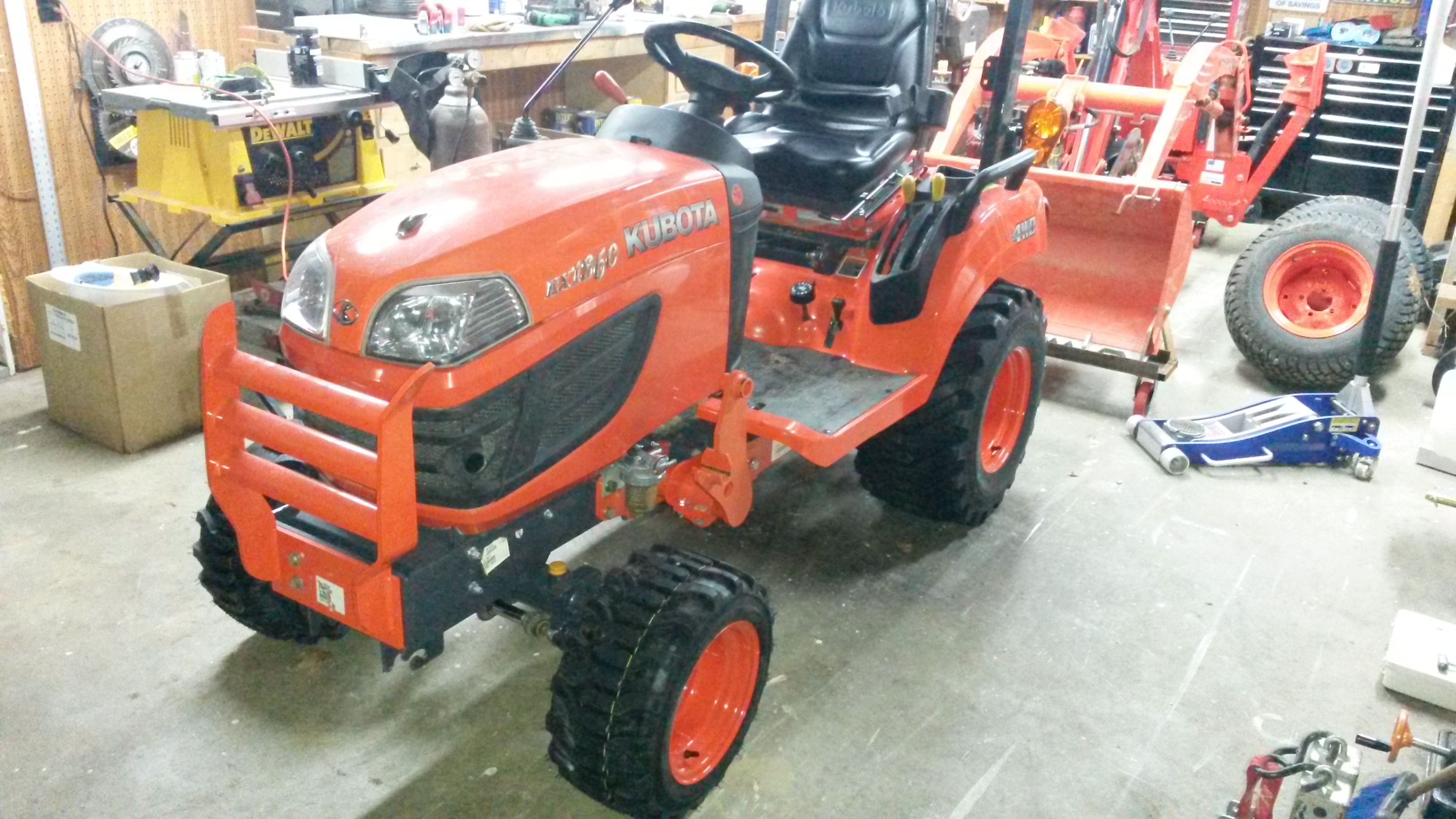

Incase anyone was interested, hard to find much about it. I needed more grip. 1482374913650.jpg
   / Bx25 tires on a bx1860
#2
I have the 48 inch mmm. Tires clear it, but barely rub the bolts on woods backhoe subframe.

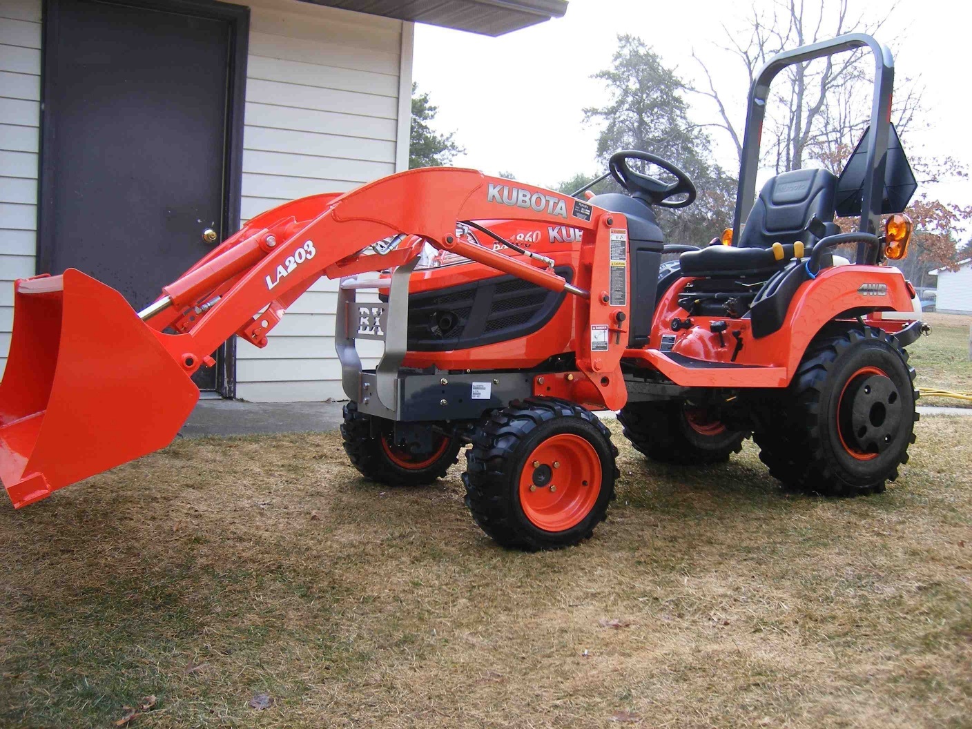

First thing I did on my BX18xx back 6 years ago. I enjoyed the mod. The fellow I sold that BX to a guy who wanted to add a 54" deck, so he bought a set of smaller original turfs off whole goods at Kubota for around $380 and used the smaller tires/wheels during mowing season and the larger tires/wheel set during fall firewood and winter snow fighting seasons.

I am missing something, so please give more details.
I though the BX tractors all used the same tire size. Does the BX25 use a larger tire size?
On my BX2200 I replaced the turf tires with bar tires, which are now foam filled and add great stability. But I don't think, but never checked, that the diameter is any different between the two tire styles.
So I guess I am asking, did you gain both a different tread design as well as a different tire diameter, when you switched tires? Or?
Thanks....Bill
   / Bx25 tires on a bx1860 #5
Bx18xx uses 24x12x12 rear, 16x7.50 front.
BX23xx, 26xx and 25 use 26x12x12 rear and 18x8.5 front.
The R4 style tire isn't available in the smaller size, only the R1 and R3.
