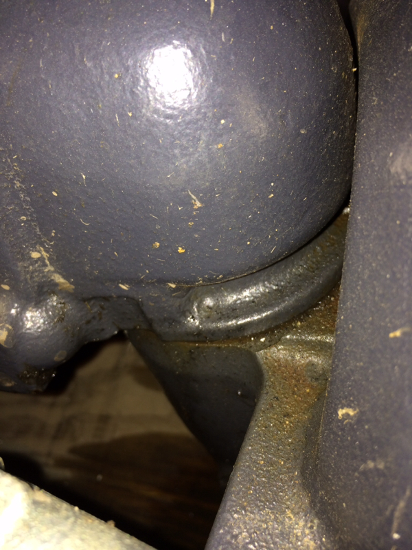

I appreciate the input and compliment. I have used the stump grinder for 2 years, so I am pretty confident the shaft was the correct length. I never loosened the slip clutch and adjusted it. I also have had many occasions where the grinder actually killed the engine. I never thought it would do what it did.....if I knew that, it would have adjusted it. This is my first tractor. I also didn't know that in order to get the PTO shaft to freewheel to connect the PTO shaft, that you had to move it to the mid mount PTO position. I was forever trying to align the shaft for connection. Even when I bitched to the dealer about how hard it was to connect the implement , the didn't tell me what I could be doing wrong........ Also, I picked up my tractor from the repair, drove it in the trailer and went to go get the stump grinder from the job site and found this when I opened the door........any ideas? No leaks when I dropped it off.......
   / BX25 trouble...... #29
Well that sucks. That joint is known for leaking. I've even seen a post where one of the parts had a crack. Mine has a very slight off and on again leak. Yours looks pretty bad. Check the front axle level first thing.
   / BX25 trouble...... #30
Looks like your axle seal went bad. I know there are other posts where there are details on replacing this seal.
