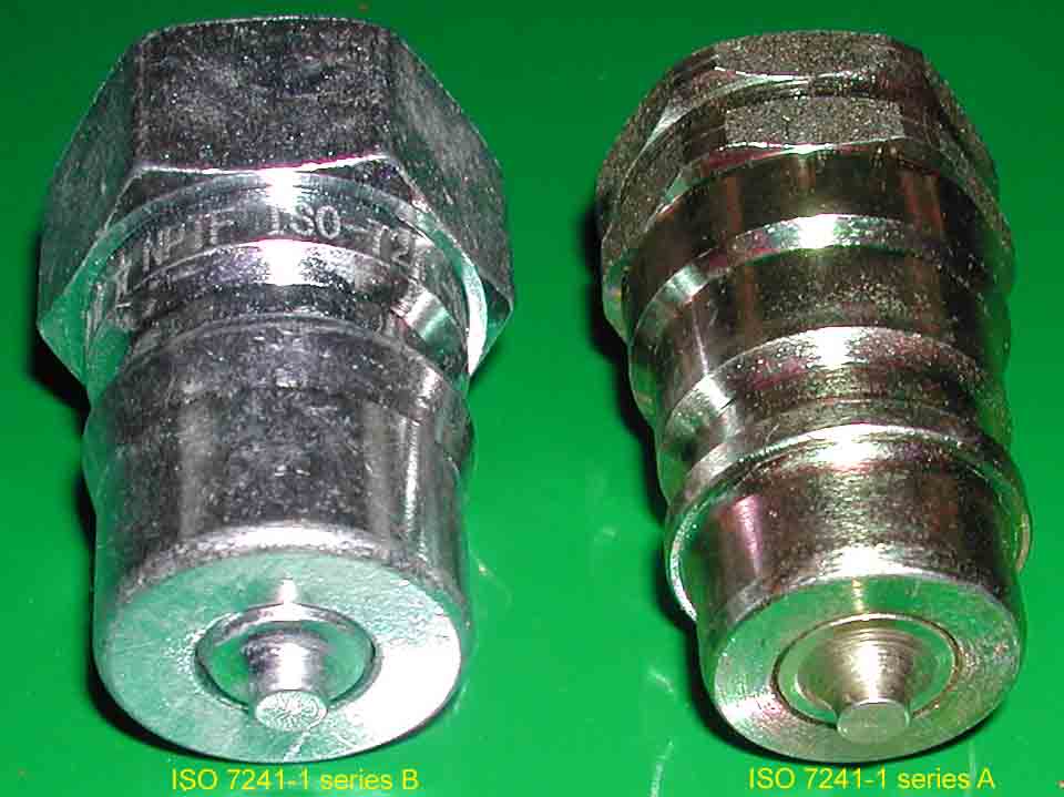

yes the fel and backhoe slow and no power. the backhoe seem like started get slow and now it take a sec.or two to respond . The fel won't lift the front end off the ground anymore and going into a pile you can't curl the bucket no power.
The tractor drives, mows, 3 ph works fine..
Just dont no hydraulics good enough I guess.
Thanks
   / BX25 weak hydraulics after removing BH #12
The stopper tit isnt centering itself when disconnected, its sitting cockeyed in its bore. The male plug closes in the proper manner when disconnected.
Sounds like you found the problem. I don't know what new Kubota
sub-CUTs are using for QA fittings these days, but my photo shows the
two major types you are likely to find on most tractors, ISO-A, and ISO-B.
You can get these anywhere....I have bought my last dozen or so pairs
from our pals at DiscountHydHose.com. Every major maufacturer makes
them, as far as I can tell. You can tell what Kubota uses just by comparing
to the pix.

Definitely double check the QD's, a piece of the o-ring can get extruded and block some or all of the fluid. You can check QD's by removing the QD set from the hose, and put the QD, male and female connected together into a bucket and check the output.

dfkrug: Looks like the fittings are standard 60 series parkers. Im going to pick up a set next time im at Princess Auto (or the dealer)
