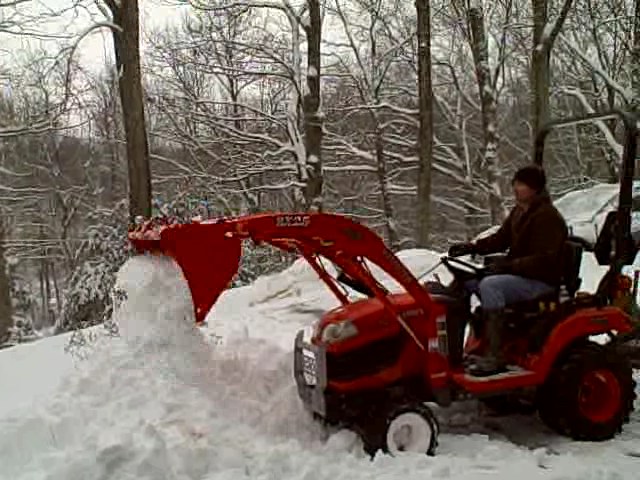

I take the battery out of my BX-25 for the winter. I bring it inside and put a charge on it once a month. It might be also a good idea to treat your diesel for winter use. In a pitch, you might have to move the tractor.
