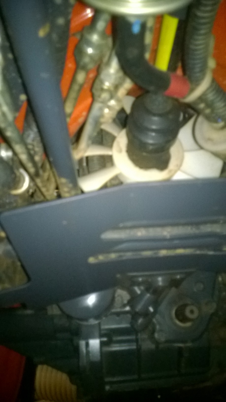

My BX2370-1 has a skid-plate/brush-guard under the HST fan. Is this something new? Would that fit a BX25D?
   / BX25D and UnderArmor #17
That little plate on the 2370-1 is an improvement but does not provide the level of protection needed. I will post a pic of this shortly. You need a full belly plate to cover your underside.
   / BX25D and UnderArmor #18
Here is the plate:
   / BX25D and UnderArmor #19
Here is the plate: <img src="http://www.tractorbynet.com/forums/files/kubota-owning-operating/446140-bx25d-underarmor-undercarriage-jpg"/>
The Bro Tek mid plate in combination with the rear plate is used in place of the stock guard.
