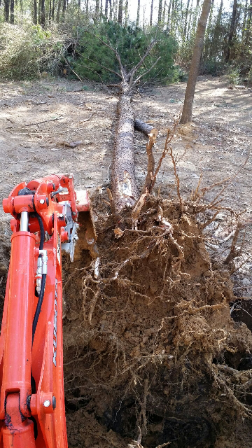

Just wait untill you get a big stump out of the ground!
I guess I should say a tree!
   / BX25D is now in the garage #25
Well that tree was not blown over. I dug it and pushed it over with the back hoe. What you dont see is that I was parked between two trees. If it came back it would lean against the other trees. Also the tree grew leaning about 10 degrees on the opposite side from where I pushed.
   / BX25D is now in the garage #26
How long did it take to get it down?

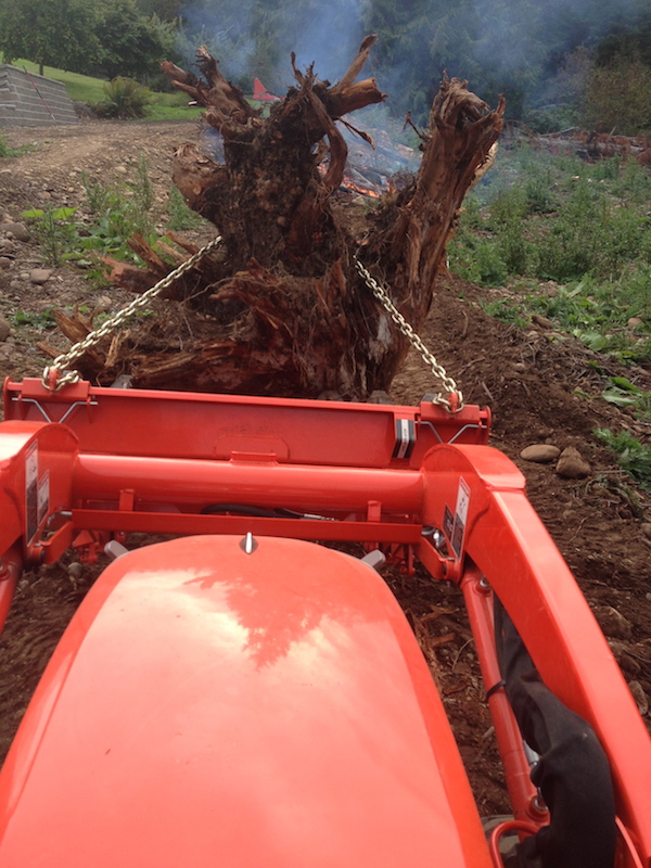

Oh Yeah! Going to the burn pile. Don't let anyone tell you a BX can't. It's the little tractor that can.
<img src="http://www.tractorbynet.com/forums/attachment.php?attachmentid=367174"/>
Nice tractor!
I don't think it's very good to pull with the loader bucket. Maybe better to chain to backhoe bucket if you don't have a tow point on the rear.
Happy tractoring!
   / BX25D is now in the garage #28
Nice tractor!

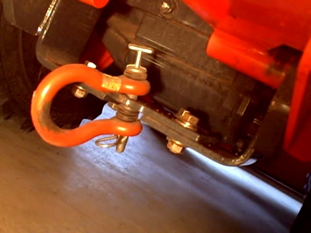

Not good to yank or tow with backhoe either. Hitch a chain to the frame.
   / BX25D is now in the garage #29
There ya go!

That part is in the book.....yea me I can not believe I RTFM. I am getting old.
