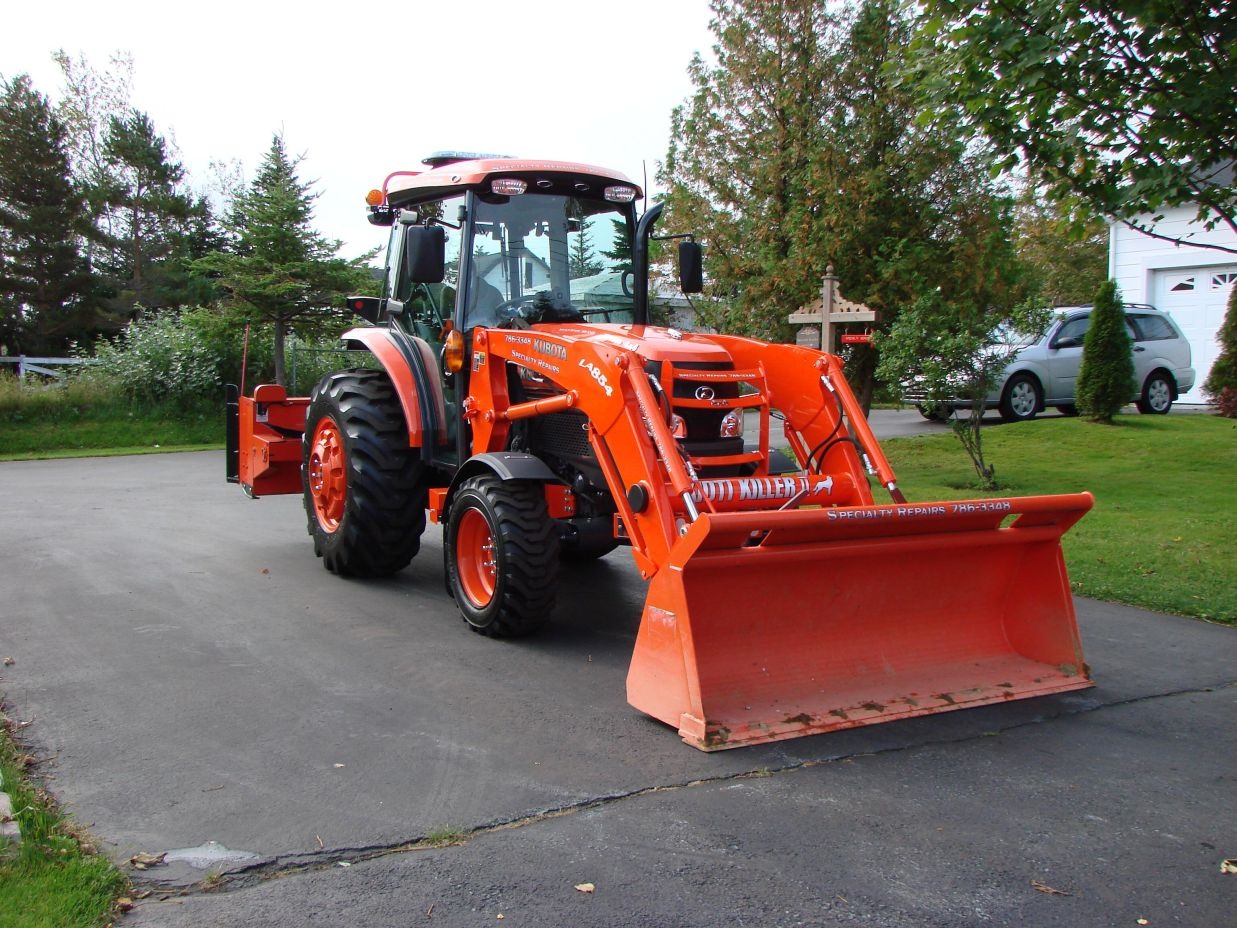

I'm calling this mod #1 although I already got a few others done but I'll post on them later.
This is a ripper tooth I fabricated. It's pretty well built from scrap around the shop. It weighs 36 lbs so that's not to bad considering the bucket weighs around 40 lbs. As you can see I also added a replaceable tooth. I figured it was better to do that rather than wear out the bottom of the tooth. I had planned to add the ripper tooth to the bucket but changed my mind because if I did it that way I would get the benefit from my thumb plus the change over from bucket to tooth is less than 5 minutes.
I guess the pictures will tell the story. In one photo you'll see a small shaft I machined. I threaded each end to hold the pin keepers in place that way I wouldn't have to use a nut on the inside to fasten the bolt plus the solid 3/4 shaft will add some strength to the mount. I made the tooth out of 1 plate and cut it with the Miller plasma. I welded it with the Millermatic 350 P in pulse mode and I included some photo's of how the welds look. I should have taken a few more photo's but when I'm doing something like this I sometimes get so involved in it I loose track of time and forget about the camera
Anyway you'll get the idea. I figured I'll use this on some tough ground and aiding in pulling tree roots. A big thank you to my lovely wife for designing and cutting the graphics. :thumbsup:

I'll call these lot of photo's a mini mod.
Don't worry. It will start to get more interesting in the next few pictures I post.
The one thing I see a lot of in the shop are guys wearing out the lip of there bucket due to the lack of a cutting edge. It's much cheaper to install a cutting edge than it is to repair a bucket and if installed properly you can reverse the cutting edge when the outer edge wears to the point of uselessness.
I couldn't get the right length of cutting edge so I went with this one and cut it to fit. As you can see I used a horizontal and saw and kept the cutting fluid on while it was doing the cutting. it was the only way to save the blade. I could have used a cut off saw but I don't find them to be very actuate and the band saw is dead on and clean as you can also see in the photo's. You'll notice I put a rubber gasket on the bottom of the bucket before I installed the cutting edge. It really wasn't necessary to do that but I had the rubber in the shop plus It will keep any debris from getting between the edge and the bottom of the bucket. I also didn't show drilling the holes in the bucket. I figure you've all done similar things to that before plus drilling is really "boring" lol.
This is just the start to the bucket mods and I'll be posting more in the coming week. At least now I won't be wearing out my bucket.
Hope you enjoy the photo's.

For me its not an issue because I use a fork lift or the QC forks on the tractor. It's hard to avoid bolts on a bolt on cutting edge and when the time comes to turn over the cutting edge I usually just cut the bolts off and replace them so daae to the bolts are a given and is expected. It takes about 20 minutes to remove the bolts, turn the cutting edge around and install new bolts. I still think its much better than wearing out the lip of the bucket which will take a day to repair and repaint. Even our 5740 has a bolt on cutting edge.
