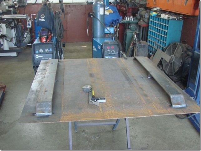

Thanks for the compliment. Here's a few pics and what I through together.
Took over 60 hours to complete but it should last a lifetime and then some.
Here's some of the features I built into it.
- Built out of 1/8th and 1/4 steel plating. Complete system weighs 1500 lbs.
- Custom machined hinges with grease nipples.
- Built in security system.
- Canarm fan for system cooling
- Double stainless steel latches both coded for the one key.
- Hydraulic struts to keep lid open.
- Fold down front section that acts as a loading ramp for the generator.
- Special locking system in floor to hold generator in place.
- Custom exhaust system with top flapper.
- Wireless remote start added.
- Snap-On L.E.D. light added.
- Floor mat that chemical resistant.
- All openings have restricters added to keep critters out.
- Sand basted to remove mill-scale, epoxy primed and painted.
- Custom graphics by Kathy (Wifey)
- G.P.S. Tracking on generator.
Very quiet operation. Video will be on our YouTube channel tomorrow.

How did you secure it to the concrete pad?

Thanks Papa. I made a mistake doing the video. I used a special directional mic to record because it was windy out but it also made the generator to appear loud which in fact it's whisper quiet. On the plus side with using the mic you can hear a fly burp. :laughing:
I had pre punched oblong holes on the lower skids and placed galvanized bolts in position in the form just before the cement pour as shown in the photos.
