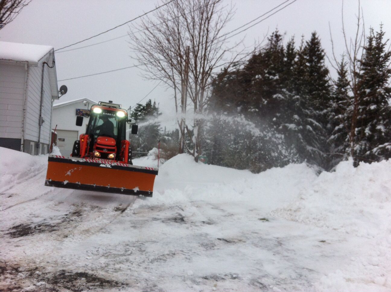

The Arctic blade has been working *really* well for me. I'm extremely happy with it, and I would recommend it in a heartbeat to anyone. I'm really glad I learned about it after seeing the Arctic installed on your L40, otherwise I probably would have never known about it. I also posted a few pictures in the snow removal forum of TBN in case you haven't seen them yet. Hopefully, I can take a video of the blade in action during the next storm (been meaning to, but I'm usually in too much of a hurry that I never get around to setting up the camera.)

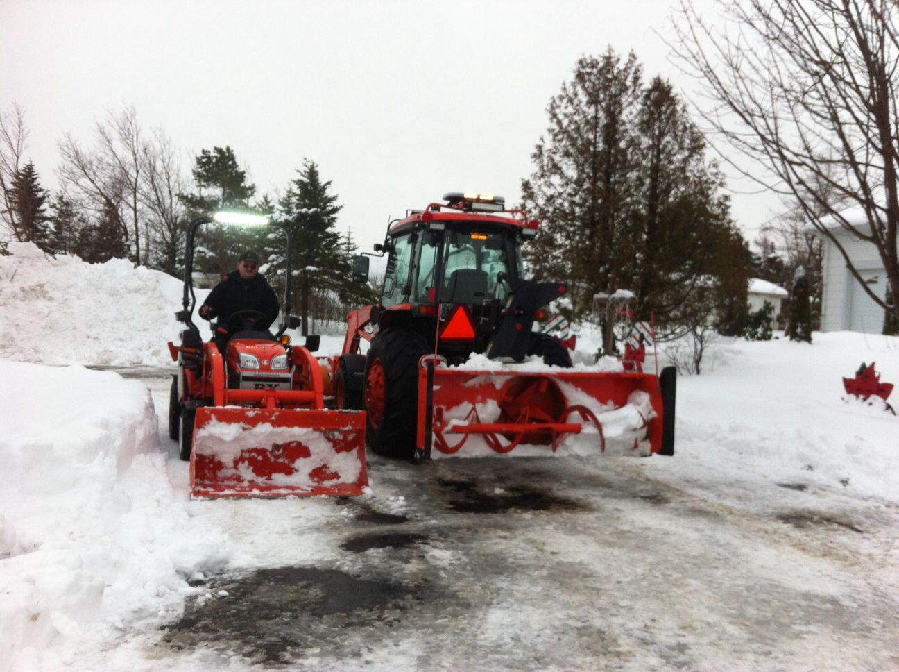

It looks to me as if you have wheel weights on your tractor. Are they a Kubota product or your fabrication?
I saw the two tractors and thought it looked like Papa Tractor and Baby Tractor, and was wondering where Mama Tractor was?
Those are Kubota wheel weights. They are stackable and they weigh 220 lbs each. There are four back there. Momma tractor can show up here any time
