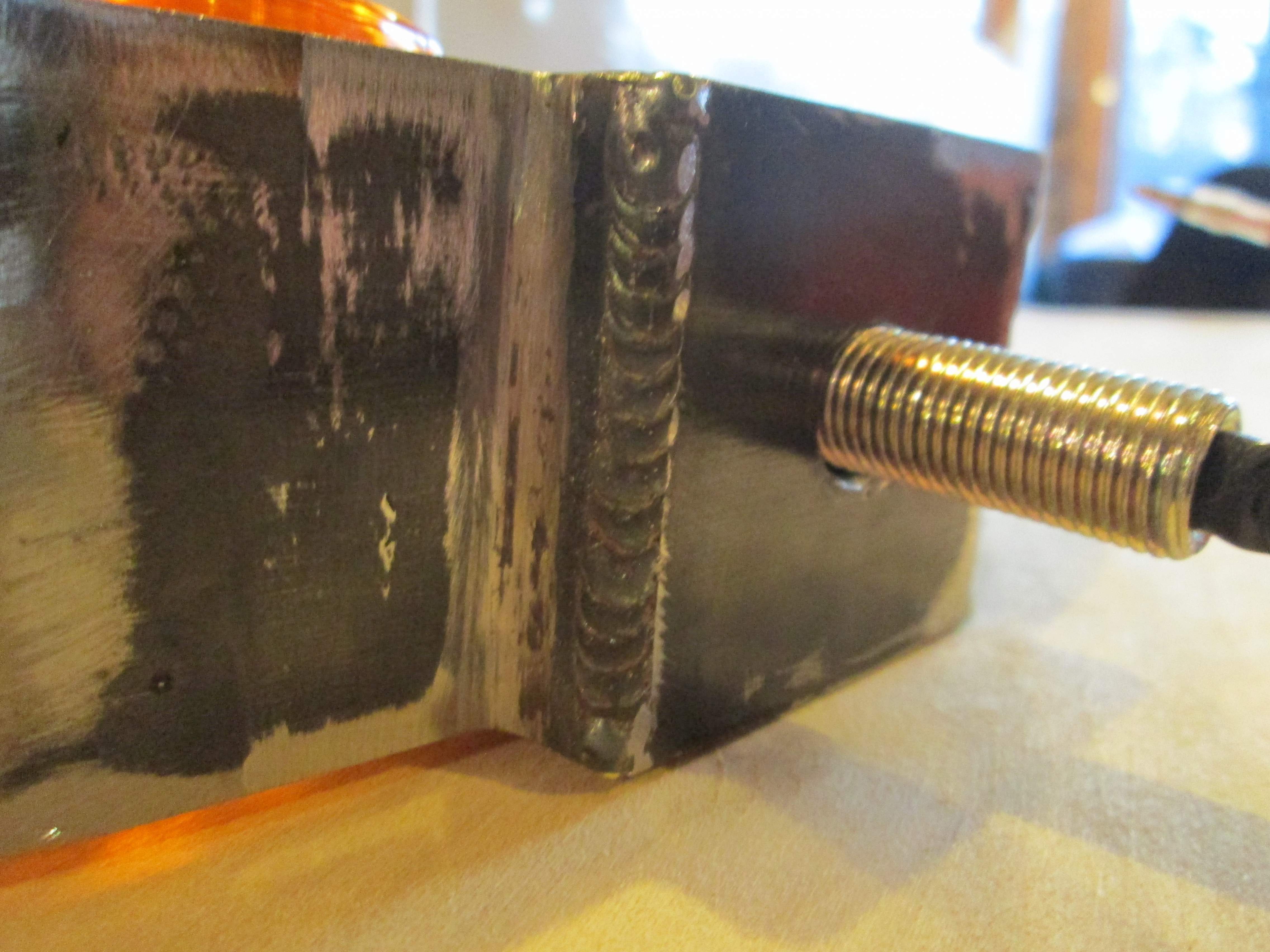

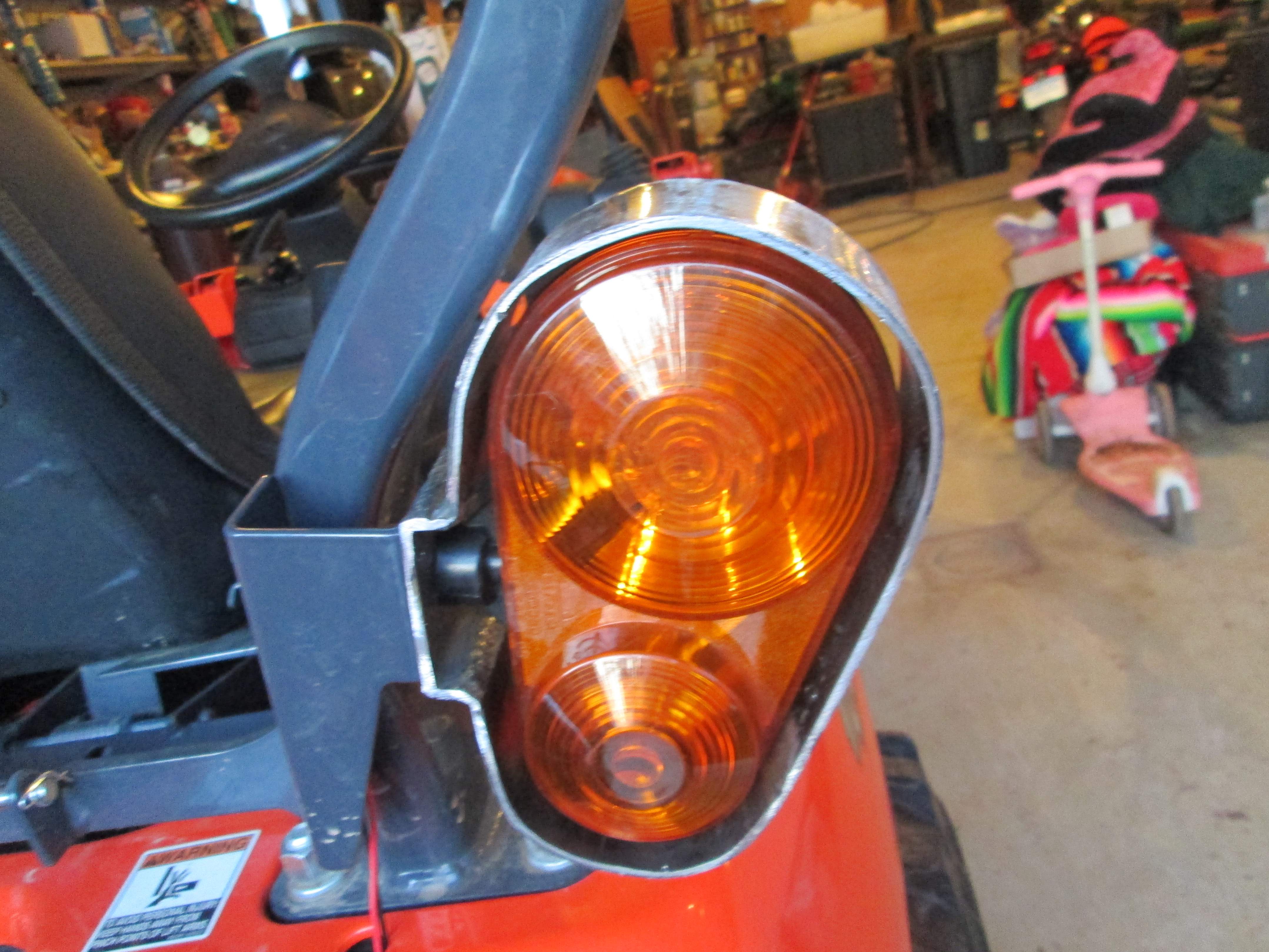

4 shorts, Excellent job on the light, low profile looks really good.
Not that I'm fusser then you, but is there a way you can use carriage bolts on the bottom of this light with the nuts on top, (or weld some blind studs on the metal base) if the backhoe lifts up the tractor or slams you around,(like it sometimes does) one of those exposed nuts could hit your head?
Not only will it give it a more finish look on the bottom but might also protect you from a trip for stitches.

The ROPS on these are very high so I doubt that will be an issue but I live 45 minutes from the city and that's where I need to go to pick up a 1/2" foam pad that will be attached to the bottom of the module. I would have had to really alter my design to use carriage bolts or even countersink bolts. When the foam pad is in place you'll never know there's a nut there other that the nut sitting in the seat :laughing:
I designed it this way to try and give it a cleaner more confined look. Correct me if I'm wrong but I've never seen one done like it before when it comes to ROPS lighting so I thought it would be a bit unique.

It looks really good. Sorry,I missed the part about the foam, I like the low profile. Really nice lights, fits the tractor just right.
