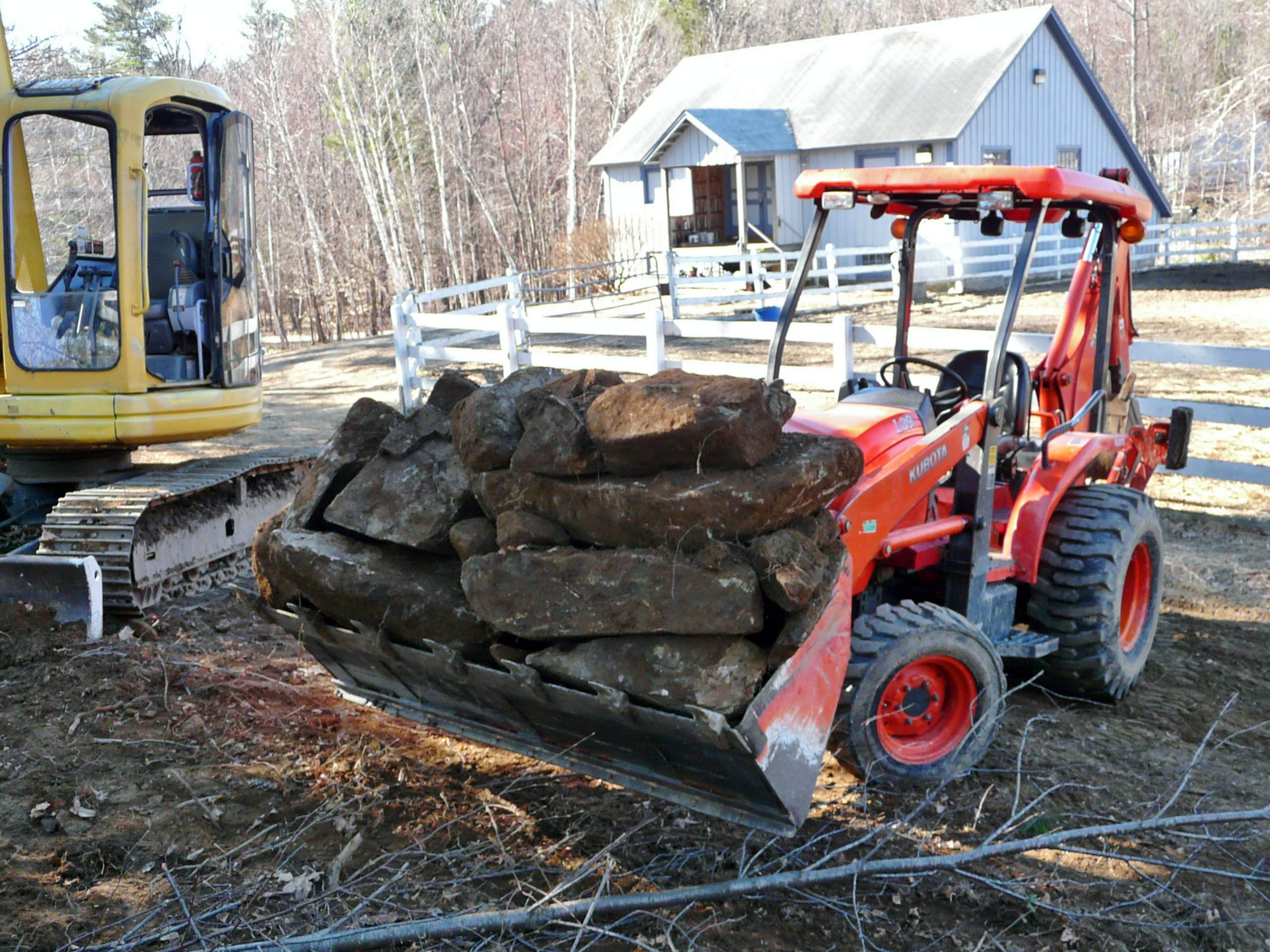

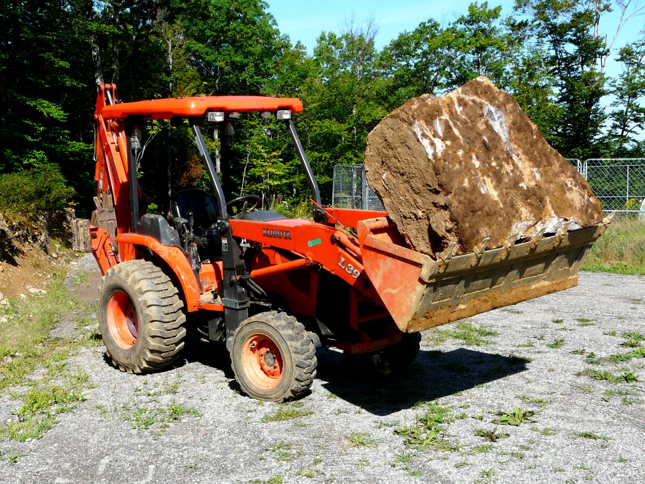

Please look at Photo's
These will lift about 3000# off ground or more.
That looks like a lot more than 3000# unless your rocks weigh much less per cubic foot than mine. Have you boosted up the pressure on your L39 tractor?
