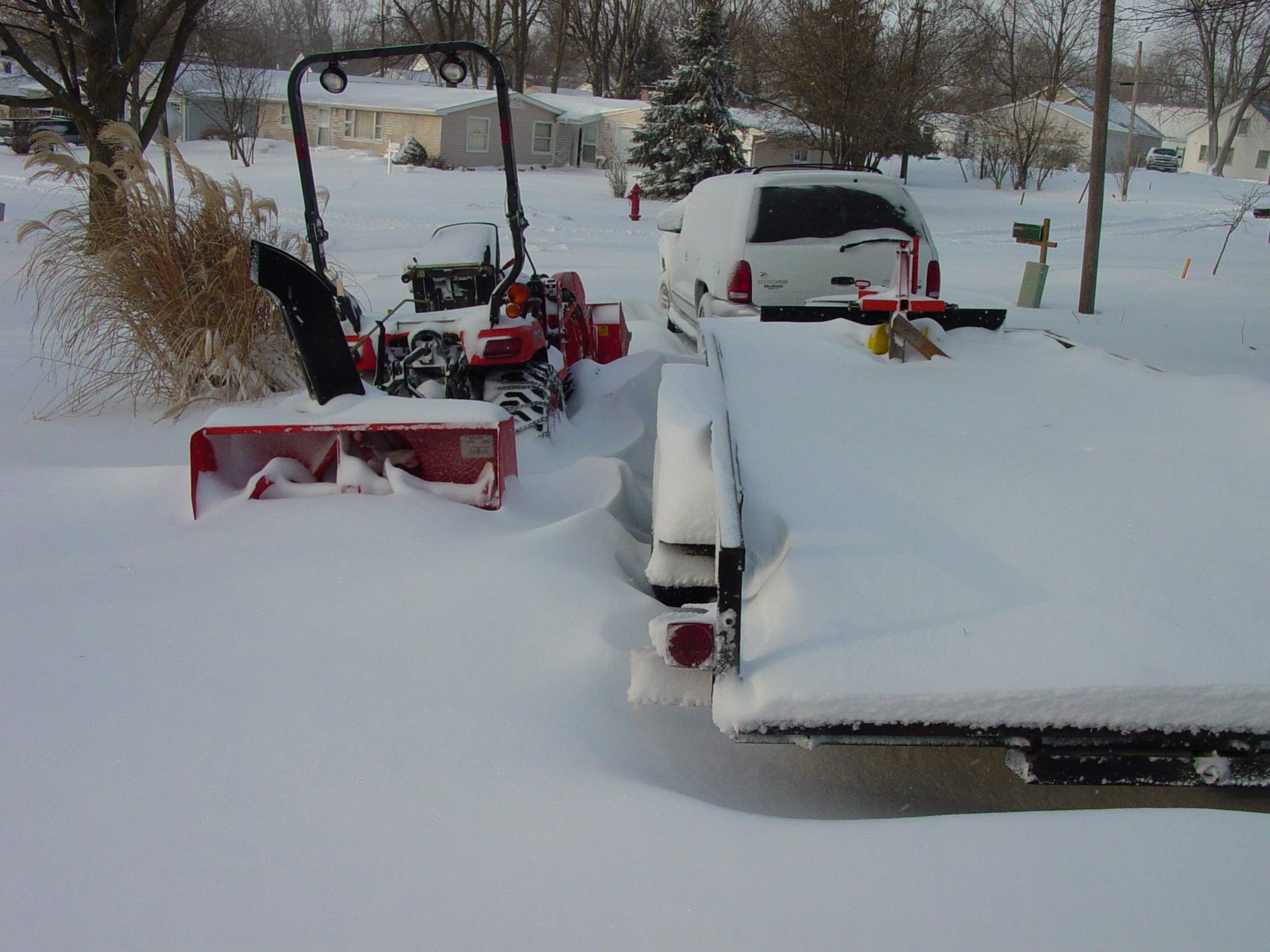

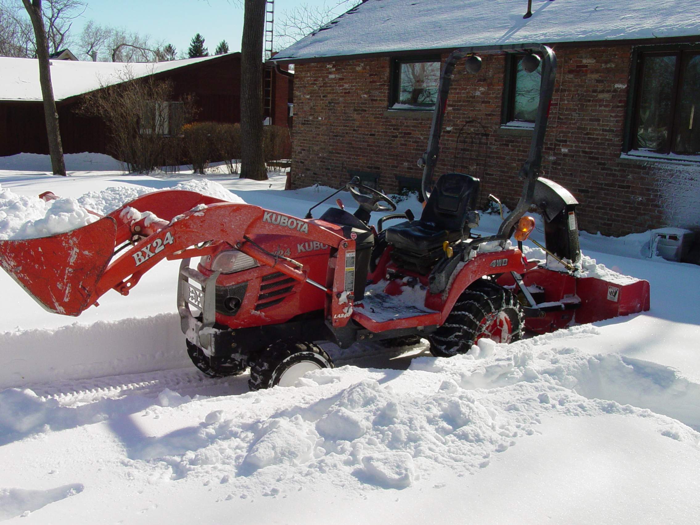

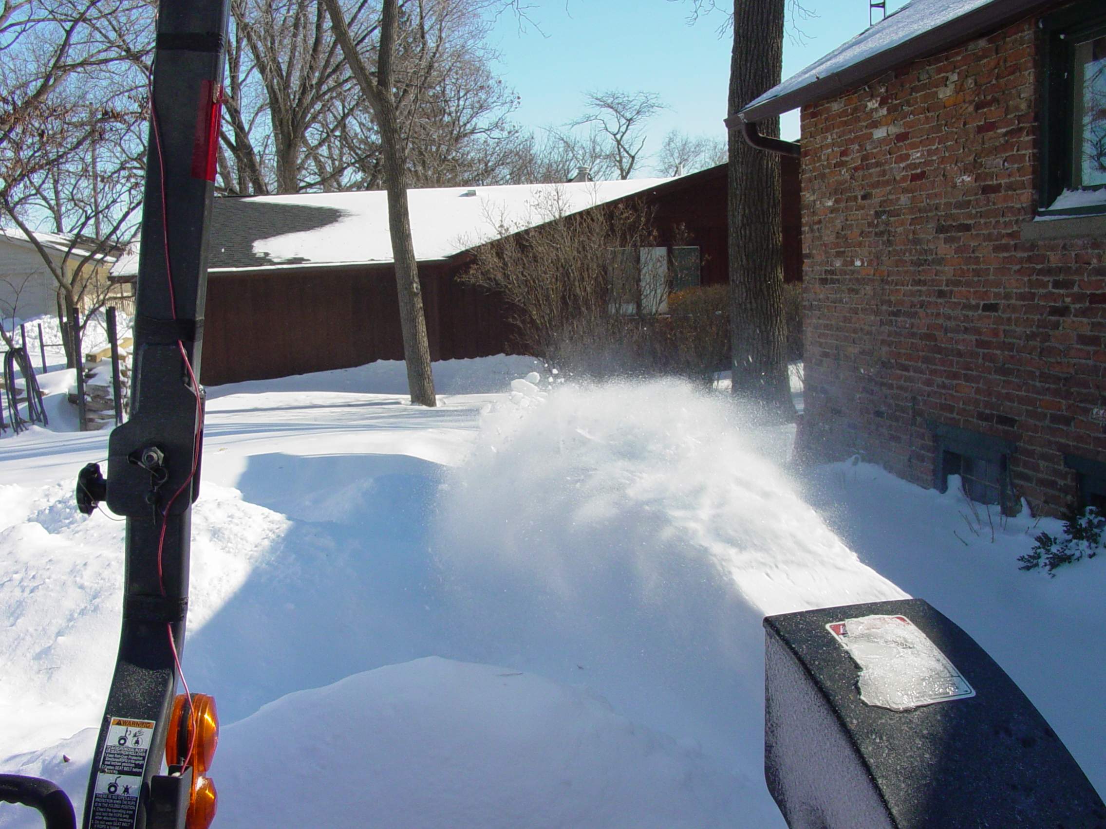

I have the BX2750 blower and it works great. I use as a rear mount, not as convenient maybe as front mount but a lot cheaper. I was in Bloomington, IL during this last blizzard to plow driveways, going through 3 & 4 foot drifts with no problems. I really believe that rear mount gives you better traction. Clear a driveway in 15 minutes! I would not spend extra money on front mounting, etc, not worth it.:)
