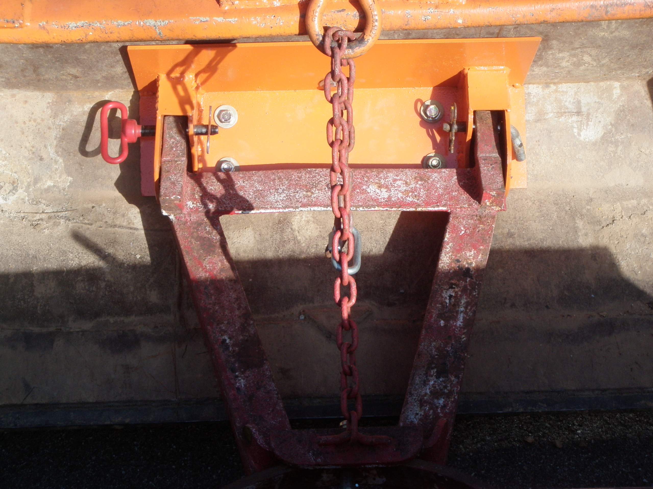

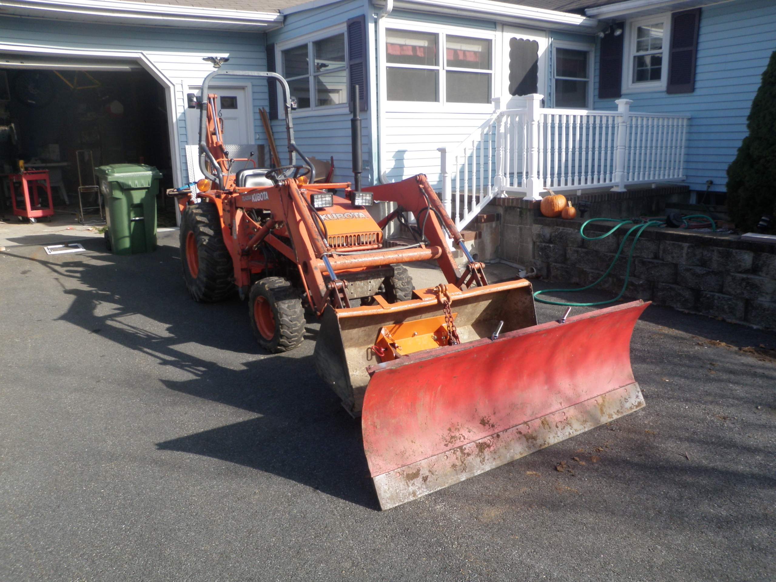

Seems overpriced to me....
Craigslist for a used 6' plow for less than $200 and cut to size, and even if you are not a welder, you could get a shop to make a braket for $100 or so...
Just a thought....

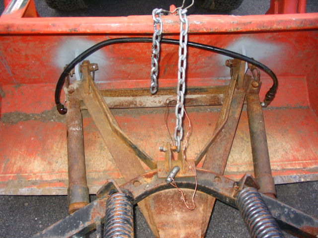

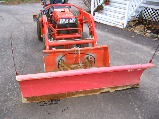

For that kind of money you can do alot more. This is my setup - I paid $50.00 for the plow (found it on craigslist) and have about $30.00 in plate and hardware. I am sure that is a great setup but that's a ton of money to spend on a bucket mount snow plow.
