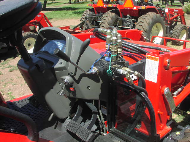

My last load of Branson's came in a few days ago and the mount for the loader valve has been completely redesigned. You should start seeing these on dealers lots soon. It is an improvement.
/ C-40 Loader #9
Dave,
Please don't keep us waiting. What has changed? Pictures of old and new, if you get a chance, sure would be helpful.

Here is a picture of the current loader valve mounting system on a Branson. My next post will show the new mount. The current mount works fine, but this is better.
/ C-40 Loader #11
Here is a picture of the latest mount system.
/ C-40 Loader #12
MUCH better /forums/images/graemlins/cool.gif
I assume the joystick no longer hits the throttle....
Mark
/ C-40 Loader #13
</font><font color="blue" class="small">( I assume the joystick no longer hits the throttle.... )</font>
It never did, for anyone who took the time to loosen the lock nut and adjust the stick's position.

Dave, do you know if the hoses were lengthened with the mount redesign?
SnowRidge
/ C-40 Loader #15
</font><font color="blue" class="small">( loosen the lock nut and adjust the stick's position)</font>
Aaahhh! /forums/images/graemlins/smile.gif I never knew you could do that. The dealer who I shopped didn't know that either. I'm glad there is an easy fix.

No, I never did. It's not that much of a problem that it was worth it to me to fix. The new system is more of an improvement because of its overall location, it looks like to me. The current joystick requires a bit too much of a reach for short folks like me (5'8"). Now tall people, it looks like, might bonk their knees on it! Just goes to show, engineering is not as easy as it might seem.
/ C-40 Loader #20
WOW! That is much better!! One thing I like about Century/Branson is there is no reluctance to correct problems or even annoyances (as in this case) as they arise!
