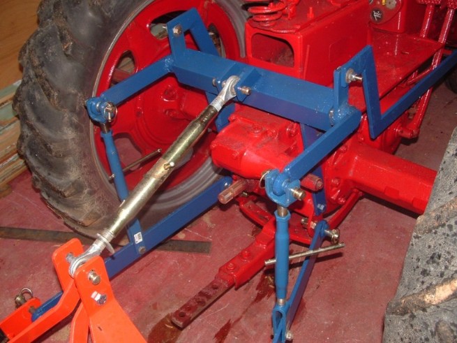

Well, as promised here are some pics of the 3PH. I finished it today and hooked my box blade up and started when the rain also started. It seems to work great, except it is a little too fast unless you really take your time with the control. Here is a pic from the back

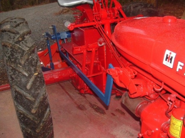

I had to run 2 lift bars from the touch control back to the rockshaft and they needed to be offset down so they wouldn't be in the way of your feet when driving the tractor. I used 2 X 1/2" flat bar. The factory rear lift uses 2 straight 7/8" rods, so I figured the flat bar would be ok.

   / C-Farmall
#28

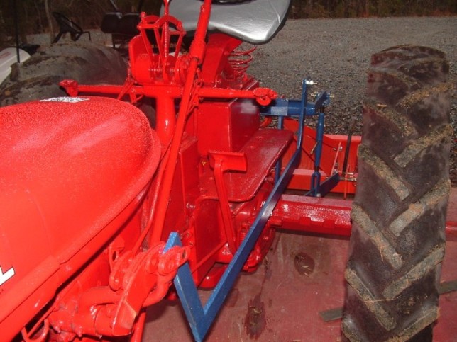

I had to make my rockshaft. I used 2" sch 40 pipe. It lifts from each side so the pipe is a lot stronger than needed, but that's what I had.

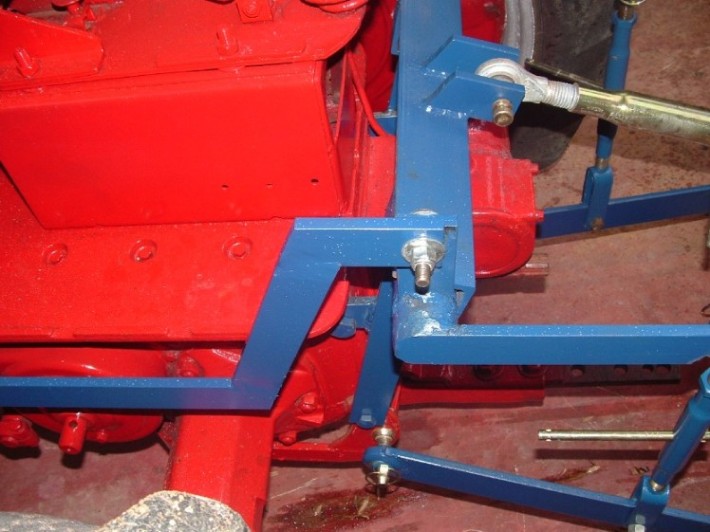

I kept a close watch on the cost and I have 98.00 in the steel, plus a couple pieces that were laying around. The weld on drawbar ends were 24.00 from Valu-bilt. The adjustable lift arms were the most expensive thing I bought. Those, and the pins and a couple grade 8 bolts were 92.00. Total cost in the 3PH was 214.00 I already had some blue paint, so that isn't factored in. All in all I am pleased whit it, it looks good and seems to work good, I'll get used to the speed of it and am pretty happy.
This is the left side lift arm and you can see it doesn't get in the way of mounting, or of the clutch . Later, Nat
