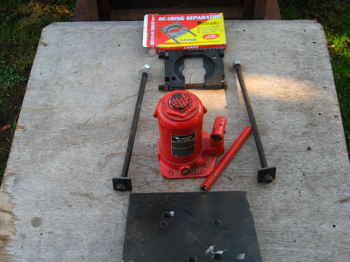

If you get a chance, I'd like to see a picture of your crank pulley, puller, if you don't mind...
What brand of jack..?? Walkers used to be the only ones that would still jack horizontally. Still have them, and probably a couple of them made in the 50's. But way too big for that. Smallest is a 5 tonner.

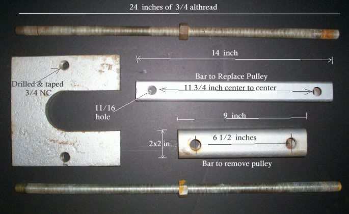

Years ago, I made a more or less backer out of a couple pieces of 1/8" X 2" angle, and bolted together, spanning the pulley. Then used a big two jaw puller, and also made a like 2" spacer slug out of 1" round stock, with a dimple drilled in it to center the puller, for when I ran out of threads...
Po' people got po' ways..., LOL...
   / C trike new project
#17

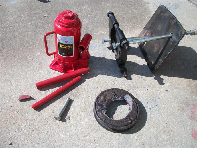

I used a 16 ton.. and a 4 ton.. 4 ton did nada..
they are harbor freight jacks. worked fine.
as long as oil level is over the intake for the small cyl.. it should work.

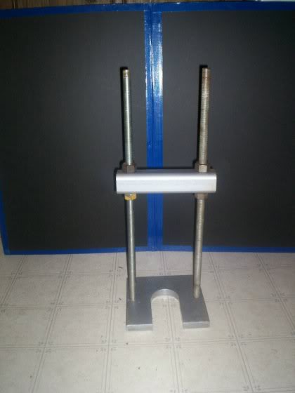

ok, 1st pic is my puller.. basically a large bearing splitter, and then 2 long bolts to a piece of plate, and a jack between them. this piloted on a gr8 bolt screwed into the end of the crank.
I built mine based ont he pics that follow it .. ideas that other 'C' owners sent me when they pulled or installed their pulleys.
at least 1 pic shows a pusher not a puller, as to reinstall.. some show a C plate instead of bearing spliteer.
one shows the exact bearing splitter I used.. pittsburgh.. etc..
basically.. everyone is/was using bottle jacks to pull the A-B-C pullies..
mine actually broke the pulley as it was jb welded on... :(

OUCH...!!
Thanks for the pics, I appreciate it..!!
A buddy of mine had his neighbor, a retired machinest make a, like bearing splitter, but it fit the taper on the back of the pulley. That way, your pretty well pulling all across the back face. He made more, and they sold a number of them on the Cub site, and epay...

i had this bearing splitter fit pretty good to the taper on back. if you look at the break onthe face of pulley flange.. it broke 'out' of the front of the pulley hub.. taper went with it!
jb weld is some good stuff apparrently when applied to an already keyed and interferenced fit shaft/hub :(
