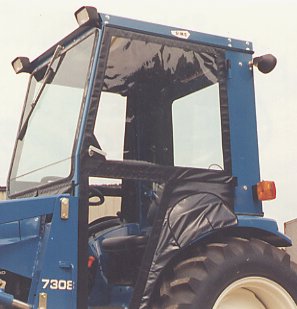

I have a NH tc33d that I am looking to buy a soft side cab for. The NH dealer sells a cab made by the Original Tractor Cab Company. with a hard roof, glass front window, and soft sides and rear panel. Does anyone have any experience with this brand cab?

The cab is more of a solid top windbreaker and it would help some to keep you out of the wind I don't consider it a cab at all, a cab you can put heat into.

The main reason for the cab would be to keep me out of the wind/snow when using the snow blower so it would only be used in the winter months. As far as heat in the cab, the dealer told me there was an optional heater available "for an extra cost". I have seen 12 volt heaters elsewhere at a more reasonable cost. I was wondering if anyone had that brand cab and if they were happy with it.
   / Cab & Blower question #5
Ah, okay, then yes a soft-sided cab sounds like it would be perfect for your needs. For heaters, yes, they typically run as an "optional" feature to buy extra with the cab...along with all the other options like radio, A/C, extra wipers and lights, etc. How much were they asking for the heater?
As far as the brand-name cabs, each cab manufacturer will have their own unique style and look. Like I said, I don't have any personal experiencing using their tractor cabs, but here's an idea of what the different major manufacturer's soft-sided cabs look like.
Soft-Sided Original Tractor Cab:
(This isn't the TC33D, but I couldn't find a picture for it. I assume it would be similar design. Though, the dealer probably showed you what it looked like, anyway.)

I have an Original Cab mounted on a JD2305 It is tight and with the glass
windshield you can have a wiper on it. I am quite satisfied with it::) and don't find that a heater is necessary. You would want to put mirrors on it though since the corners restrict your view quite a little. Since I am an old goat turning the neck around is a little difficult. The price was right and I'm gald I got it but will have to remove it when the warn weather comes. 10 inches plus this last snow and sleet.:

Electric heaters in this area don't work! When cabs are loose a 13000 btu heater won't be enough on a cold day to unzip your jacket much less to possibly remove it like in a good cab.

How much were they asking for the heater? I was told it was around a 300.00 option.
It is tight and with the glass windshield you can have a wiper on it. Yes, It does have a hand operated wiper, electric optional.

You're right, 300 is on the high side, but you're going to be up in that 200-300 range for a cab heater.
I'll do a little promo here *whistle* and just give you some numbers on a Sims cab for your model.
NH TC33D Soft-Sided Cab
$1895 base price -
Comes with:
> left hand steel-framed vinyl door and right hand curtain
> electric front-windshield assembly
> front glass windshield (tinted safety glass)
> rear vinyl with poly window
And the heater (optional, as can be expected) runs about $229 if bought with a cab. Of course, you can get all sorts of other optional stuff with it. More info on the cab and features here.
But, when all is said and done, I'm sure you'll be happy with your cab whichever route you take. When it comes to the major aftermarket cab brands, most are typically of good quality. The deciding factor for most people comes with price and style.
