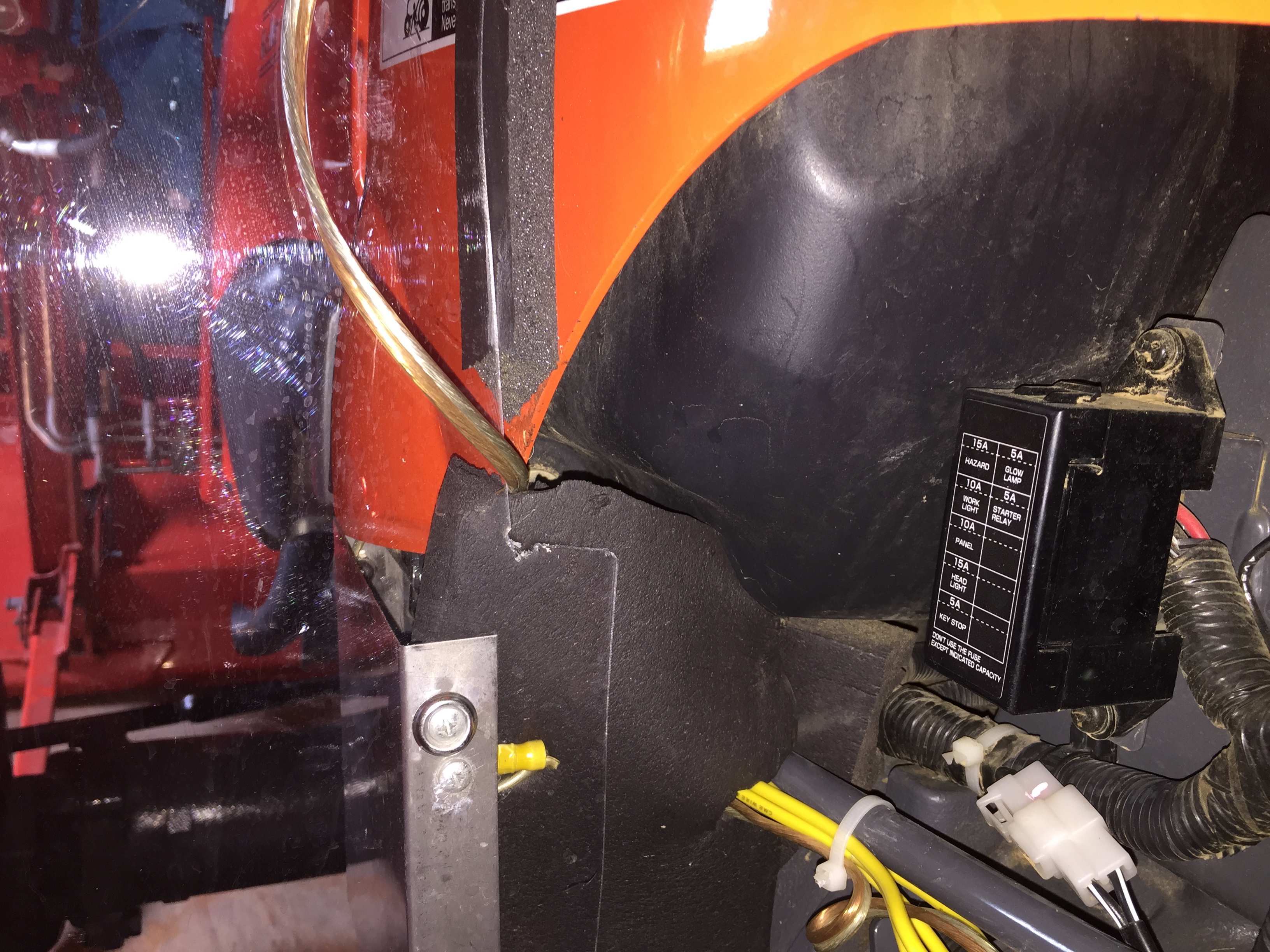

...........................I need to seal up the gaps around my legs, though, wind got in there pretty easily and made for cold toes.....................
My cab didn't have too many gaps, but the front wall took some extra work. I made the initial front (below the glass) from strips of the thick plastic material used for big doors on refrigerated rooms that forklifts drive through. They had gaps and the plastic yellowed after a while.
In the pictures is the current version made of Lexan. I coped it around the body, trying to leave a 3/8" +/- gap between the Lexan and the sheet metal. Then I got some closed cell foam gasket material with adhesive on one side and stuck it on the metal. The edge of the Lexan just touches the gasket and that worked well. The hardest part was between the floor and the back of the engine compartment. Much of it was easy enough to close off with cut-out pieces of flat Armaflex. The left side was a little challenging, but adding a small piece of U-bent stainless provided a place to fasten an end of the Lexan plus hold a larger piece of Armaflex. A quick fix could be as simple as stuffing gaps with pieces of Armaflex pipe insulation.

Mine has no gaps at all except for the legs. I think some pond liner rubber is in order.

I like that a LOT. Very nice work. Great visibility. Good job!!!!
