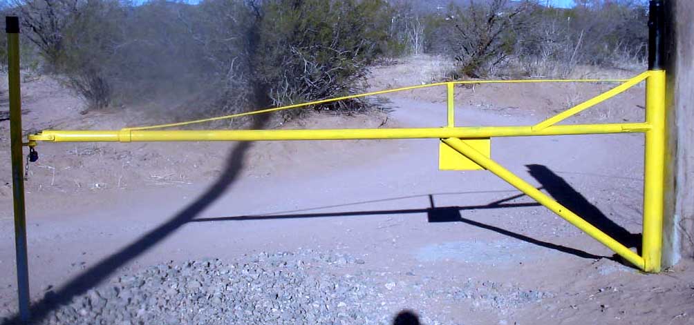

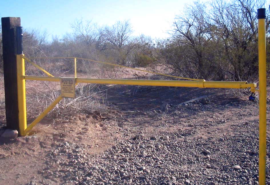

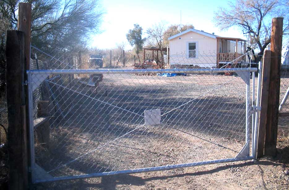

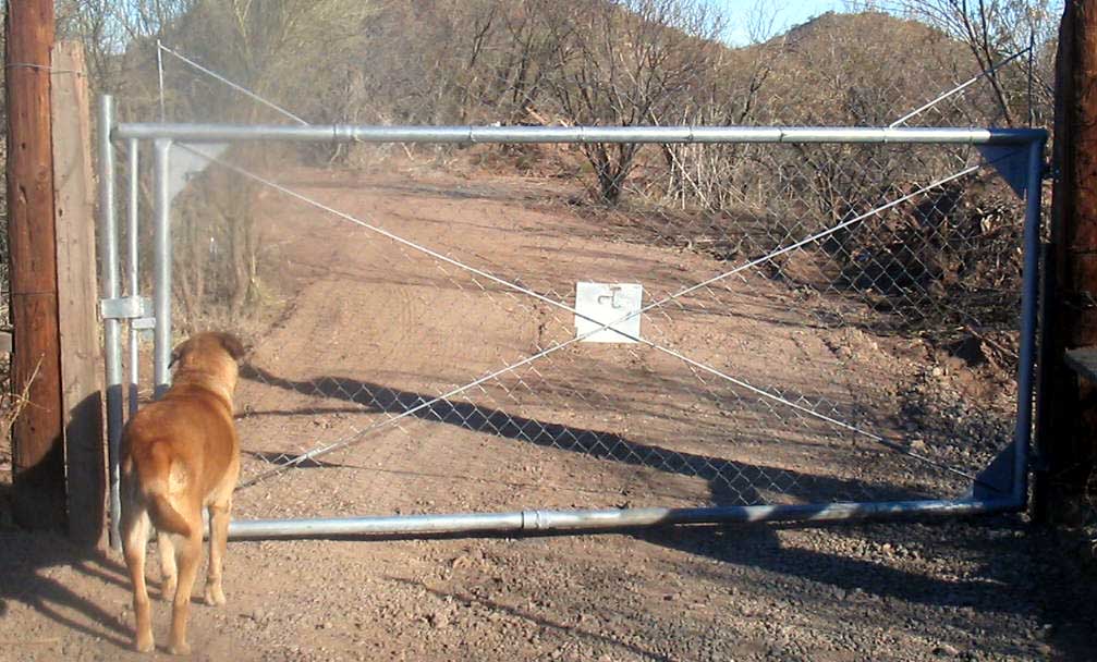

Here are pictures of 2 gates that I built and hung on my place. The silver gate is way to heavy to lift off, main frame is 2" pipe. Yellow gate can not be lifted off and is also very heavy, again all made out water pipe. Lock and latch are attached. Lock could be cut, but in 4 years no one has tried. Some drunk or idiot did run into the back side of the yellow gate and deformed it about 10". Am sure it hurt his car / truck more than the gate.:laughing:
More details and close up pictures if you are interested.
