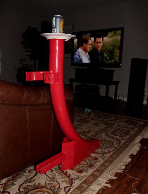

Wow, thanks for the replies. I'm going to check on that because I would rather do it right the first time. (Provided I could AFFORD it! LOL!)PLUS I still may get to use that first pipelayer I purchased. And to think I turned it into a drink holder in the man cave. I think there may be a market for "Tractor Implements as Furniture."
Oh no he di-int!
Deerherd, I think you just earned yourself a huge wad of street cred with that post.
Just passed some coffee thru my nose.
