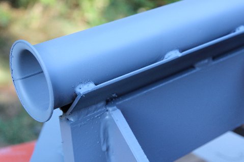

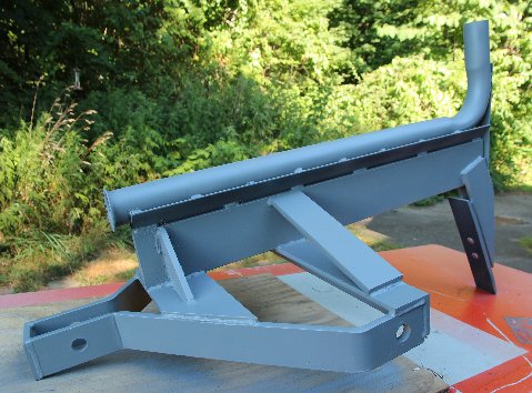

Deerherd, there was an old post from a fellow that used his small CUT to lay some 1 inch poly tubing for his wife's gardens. I couldn't find the thread right now but will post it tomorrow if I can find it since it has some good pictures. He used a middle buster and bought a 2 inch 90 degree electrical conduit elbow (about 10 bucks) and attached it to the middle buster, facing rearward, with a couple of band clamps. He did make an initial pass to bring up any rocks he ran into and then fed the pipe in. He laid several hundred feet of pipe and barely disturbed the surface. I would think this method would work equally as well for you with your cable and you could use a smaller diameter elbow. I ran about 60 feet of 1 inch poly pipe myself using this setup but one of the band clamps broke near the end of the run. I will be laying more pipe this way but will weld a bracket on the elbow so I can clamp it to the middle buster.

Thanks for your reply and I'm making one up similar to what you described and as soon as it's done I will post some pictures. I picked up a sub soiler at tractor supply for $179 and some 2" angle iron for about $20. The angle iron is being welded into an "L" shape with the long end of the "L" being welded to the subsoiler shank at the point of the angle iron, making a V behind the subsoiler. The short leg of the "L" will support the last 4-6" of pipe that will be at the bottom of the trench. I am getting a muffler shop to bend a piece of 2" pipe to fit into this "L" bracket and flare the top so the cable doesn't get snagged when feeding it in. Some primer and a couple coats of orange paint and it should be good to go. Hopefully it will be done this week.
Thanks for everyone help and I did check with the cable company and there is no fiber optic possibillity in the near future.

Here it is with the primer, I should have it painted with the proper color orange in a day or so. Hopefully I will try it in the next week or two and I'll let you know how it works.
