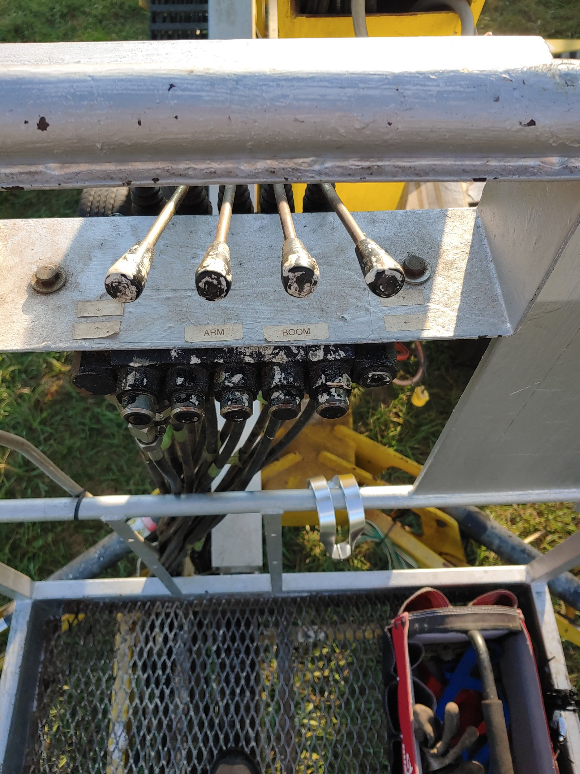

Here's the controls layout, the lever labeled boom corresponds to cylinder A in the diagram I posted above, the lever labeled arm corresponds to cylinder B. You can't see it in the photo, but there's a small lever that allows manual operation of the leveling cylinder. Inline with my toe at the bottom of the photo is the leveling cylinder, but it's hard to see through the expanded metal floor of the cage.
Here's a video of cylinders A and B operating independently. I notice that using cylinder A doesn't cause the cage to go out of level, so the leveling cylinder doesn't have to operate. I guess that's because of the geometry they chose. The cage leveling cylinder only needs to operate when cylinder B is used to raise the upper arm.

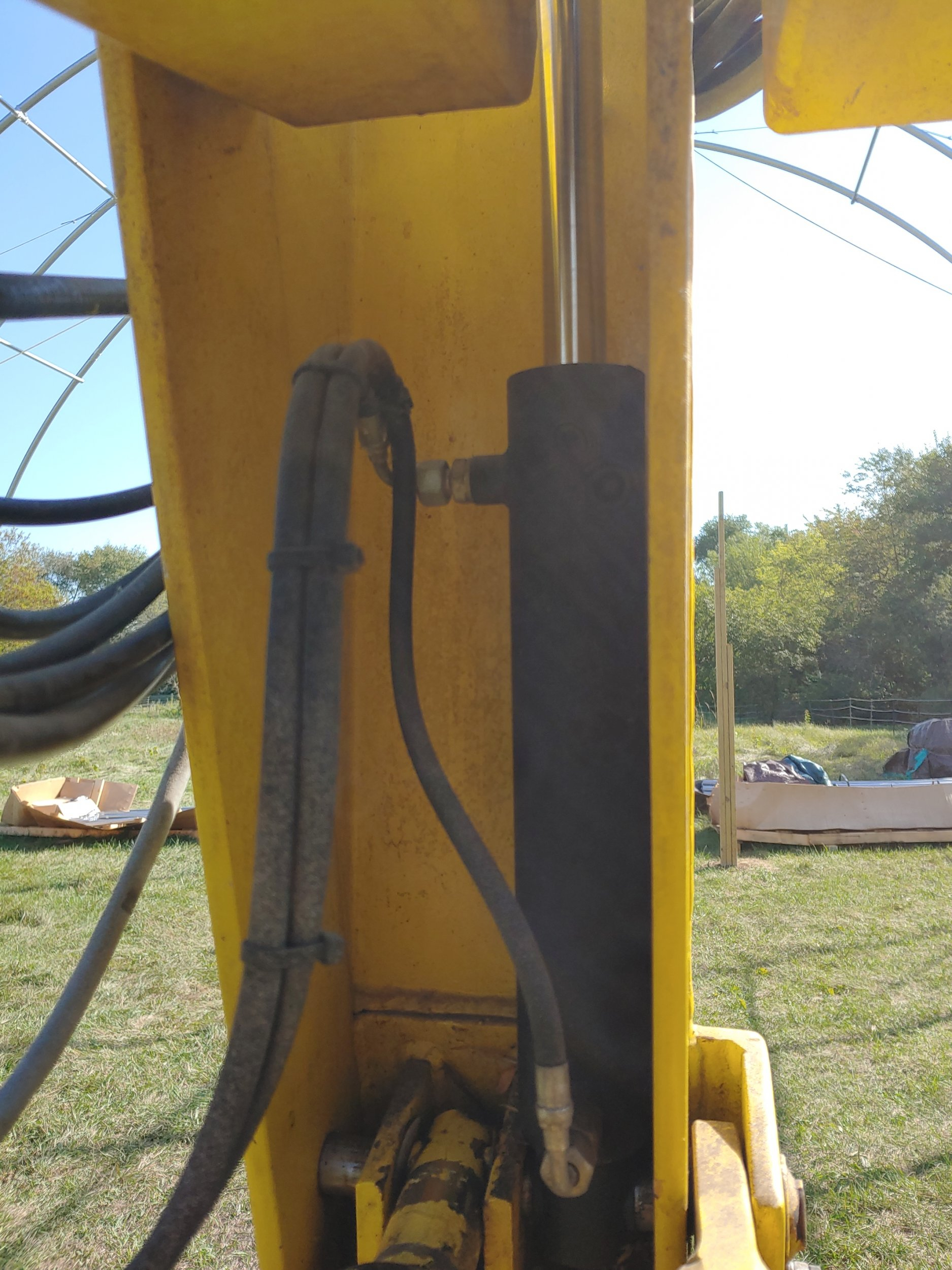

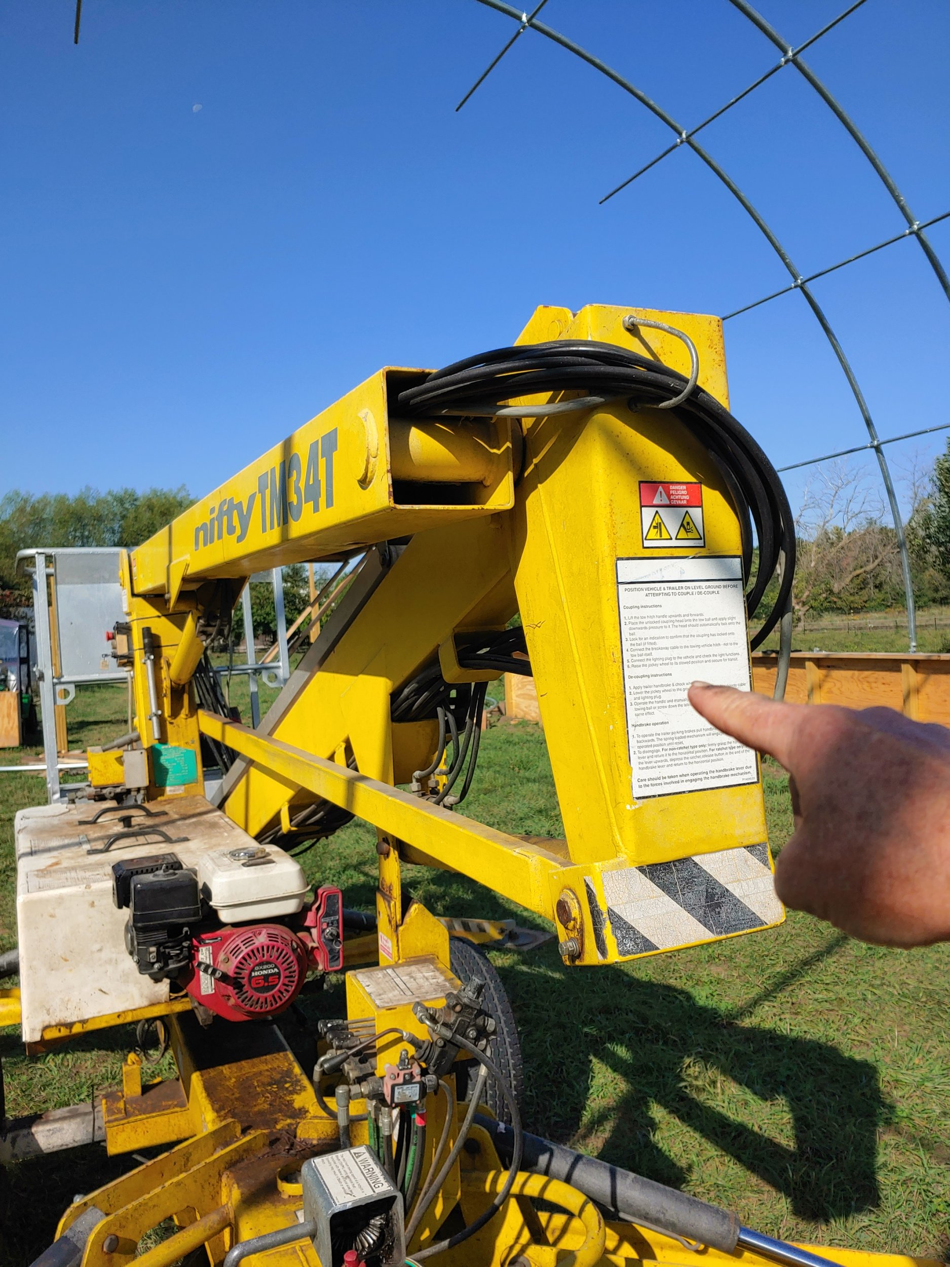

Ok, I found the knuckle cylinder by tracing hydraulic line. It's behind the label I'm pointing to in this photo.
And here's the cylinder in it's hiding place.
   / Cage leveling on aerial lift #26
There it is.. The only other way that I know off doing this is with a leveling valve, but those are hard to adjust right and usually cause a lot of 'jerkyness' because they use by-passing check valves controlled by springs, thus the reason for the cylinder setup.

So now I understand what's going on, I also found where the leveling cylinder and knuckle cylinder are T'd together so it all fits with the schematic.
Maybe I should start a new thread, but the problem I have is an ongoing need to purge air through the leveling cylinder, so I assume the system is sucking air somewhere. How do I go about finding a leak in a system with so many paths back to dump? I've had this problem since I got it 10 years ago but it seems to be getting worse. I've replaced the hydraulic oil and filter which allowed me to inspect the large hoses connecting the oil reservoir to the pump, that all seems in good condition.

That sneaky bast**rd hiding in there!! 🤣 To be fair, the manual was not very clear on the location of that cylinder either.
Being that you have a valve to control the basket, should be a matter of just cycling the cylinders a couple of times and it should take the air out on the leveling/knuckle circuit.

Mystery solved. Its all starting to make sense now.
Return oil usually results in a leak and not a point in which you get air in the system. Rather a suction line from the tank to pump (if its not a submerged pump) is a source for air. But that would also cause air and jerkeyness in the other hydraulic functions.
I agree that the simplest method is to operate the basket cylinder fully both directions a couple of times and see if it starts acting better. This would best be done from the ground controls if you have a ground control for the basket
