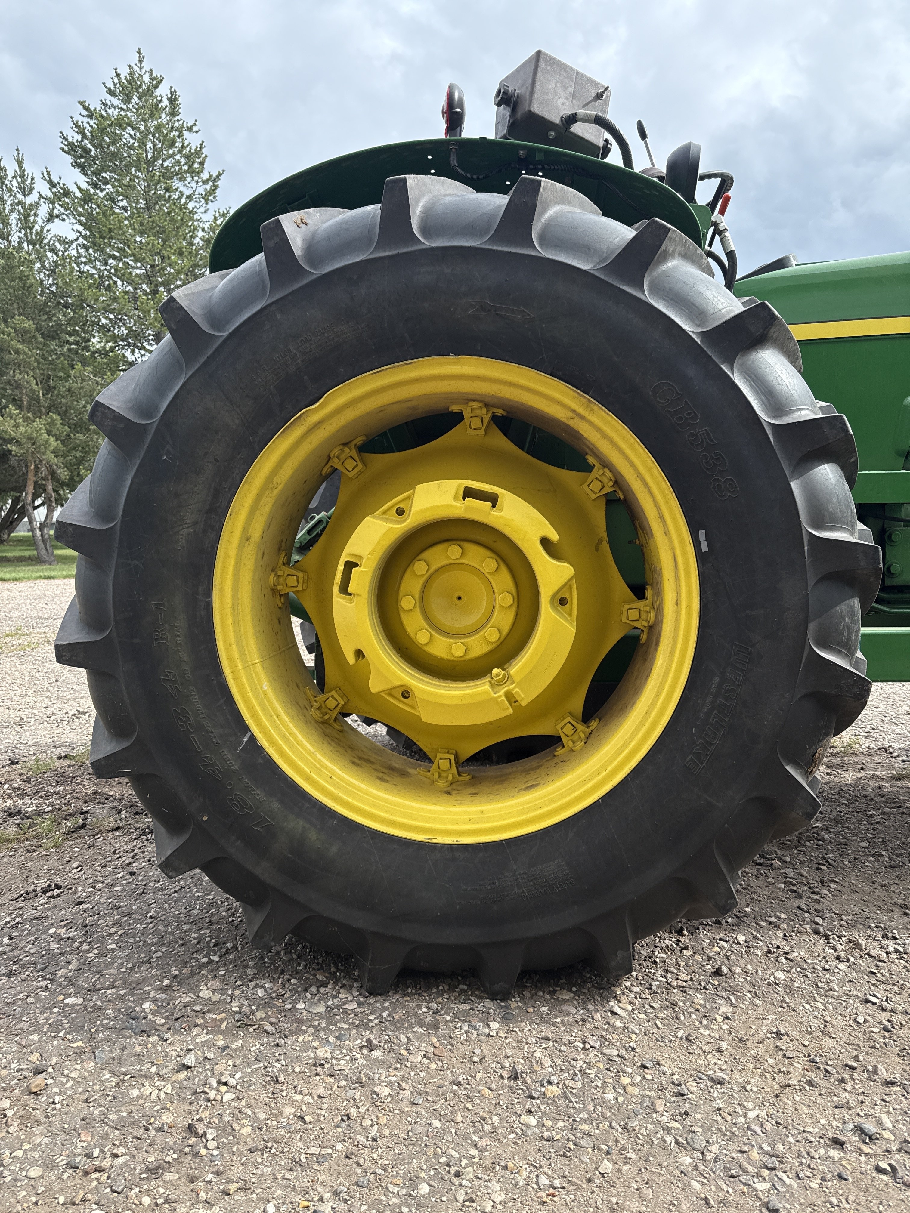

Just checking my rear tires on the tractor today. They don’t look particularly low… But I’m only reading 1 pound on each of the tires. They are filled with calcium. So I’m questioning whether or not my gauge is working properly, though two gauges showed the same thing. Not too familiar with calcium tires… Do you add air pressure the same way you always would? I just don’t want to fill them to a catastrophic blowing point. They just don’t look that flat to me.

Agree don’t look under inflated in that picture. We ran similar pressure with fluid vs without. I would suspect 12 - 15 PSI for a tire that size depending on load it is carrying.
with stem at 12 o-clock try blowing a little air to see if possible core was sticking or plugged.

Napa or Milton Brands are the best quality & makes a springloaded air gauge specifically for fluid filled.

Not a clue as to why your gauge is reading 1 psi as that tire clearly has more then 1 psi in it.
Is it possible your gauge is reading in bar? ! bar is equal to about 14.5 psi.
