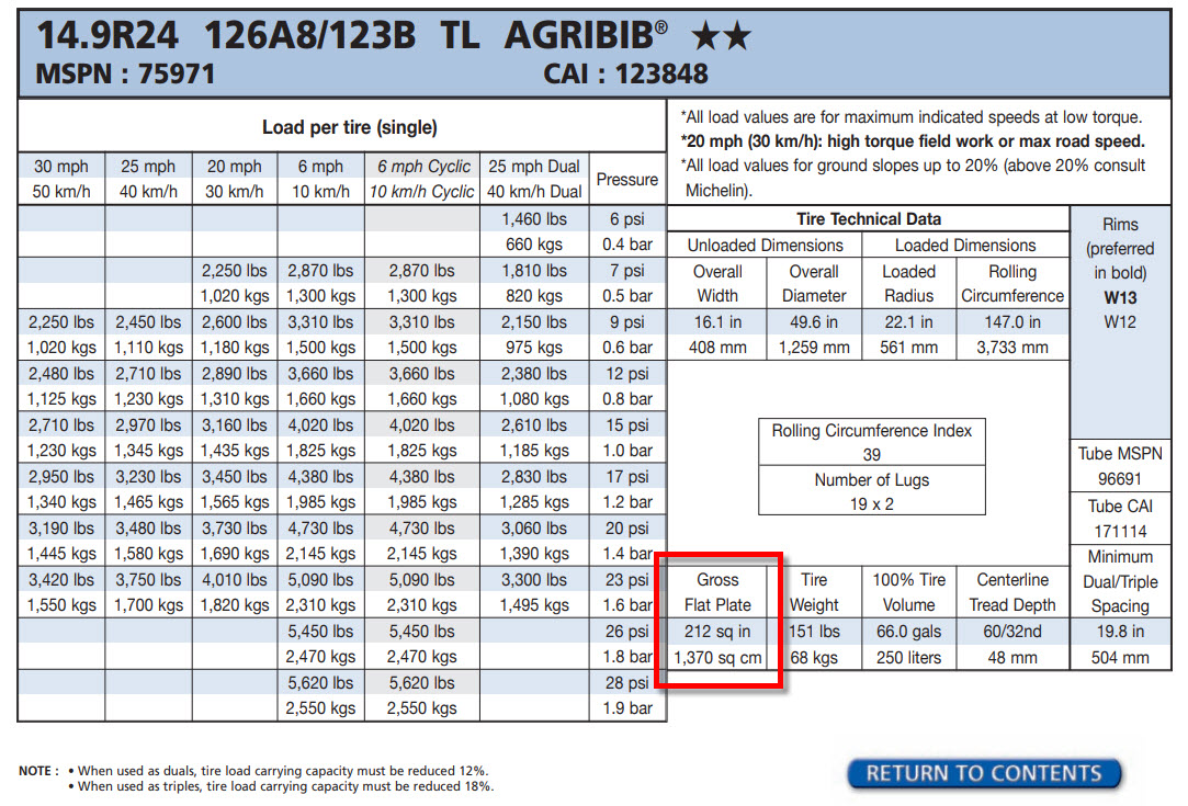

How much tire area is in contact with the ground will depend on inflation pressure and how soft the ground is, but for an average, use this resource:
http://www.ntstractortires.com/assets/uploads/pdf/tires/MichelinData.pdf
Example:
When I did a "sanity check" of the 212 sq. in. number shown in that example it works out to a contact patch rectangle 16" wide by 13" long, which is longer than I would have expected. More explanation of "flat plate area" here:

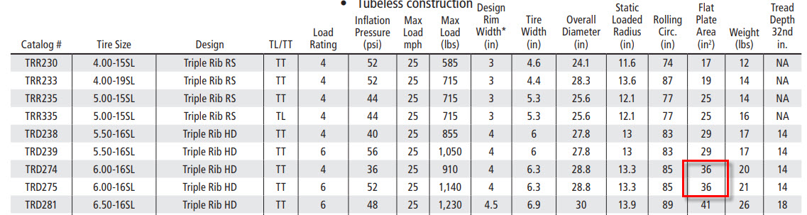

I couldn't find a 6-16 tire in that Michelin resource, so here's another one that does have that tire size:
http://www.ntstractortires.com/assets/uploads/pdf/tires/GoodyearData.pdf
