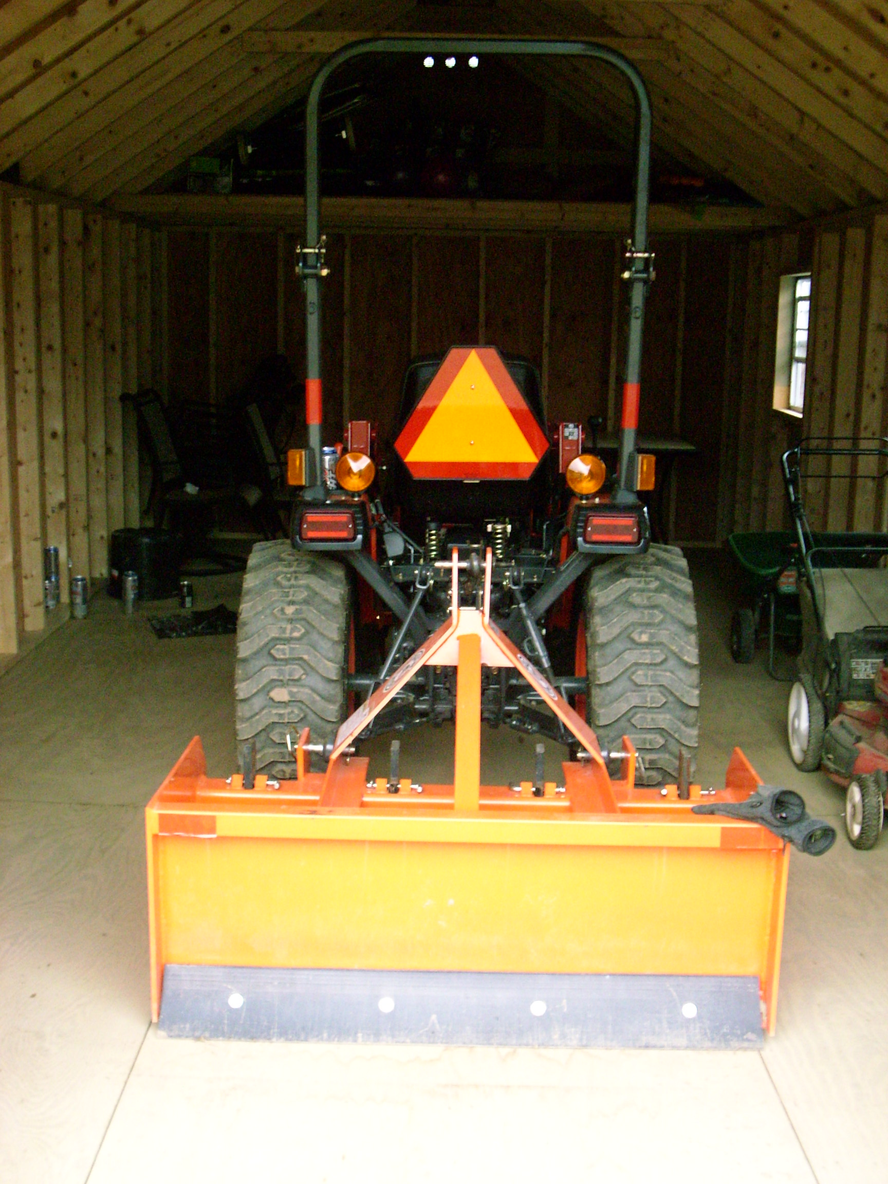

How big is the floor and how will it be supported? Once you have the joists sized (think span tables) will it be worth decking it with 1" x 6" t&g and covering that with 1/2" ply or osb.
Check your building code for calculations and include the tractor weight as point loads (under tires) and dead load (floor area).
I have a wooden floor that is 2x8 joists 12" oc with a span of 10' decked with 2x6 and I drive/park my L3400 with FEL and tiller attached (I can't recall the weight but it must be around 3000) with no issues whatsoever.

Good info - critical question, though - what's the unsupported span of the 2X6's?
Good question I should have been more specific. The floor is also constructed w/ 5 4x4 skids for extra support as well so the max unsupported span in my pole barn is probably around 30" all lumber is also pressure treated.

Wow. Unless I read this wrong, it sounds like you're parking on a lumber pile!
2x6 at 6" oc with 30" span decked with 1" screwed and glued. You could park a cement truck in there.:D

:D:D You are reading this correctly. I really wanted concrete originally but at the time we built this (last fall 07) concrete prices were outragous (even getting a discount from a buddy) and here in my area the concrete unions were also on strike at the time so I didnt want to wait. I spent a little extra for the floor material but IMHO well well worth it for my peace of mind. Still turned out way less than the price for concrete and as mentioned in my other post I could easily drive a truck on it w/ no problem, See Pic.
