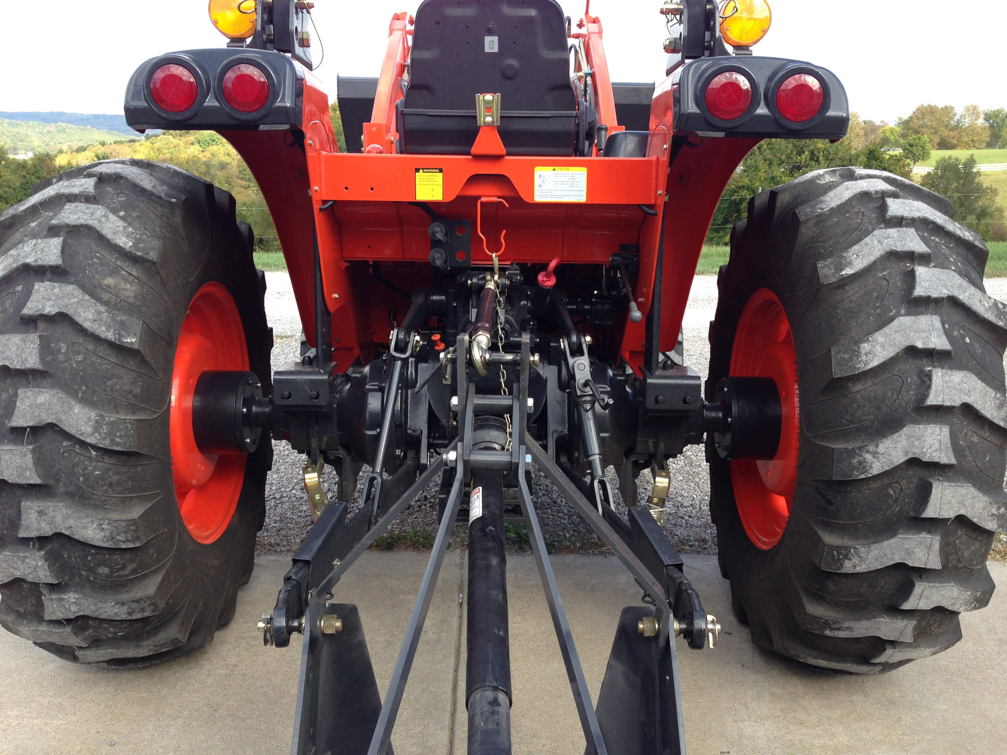

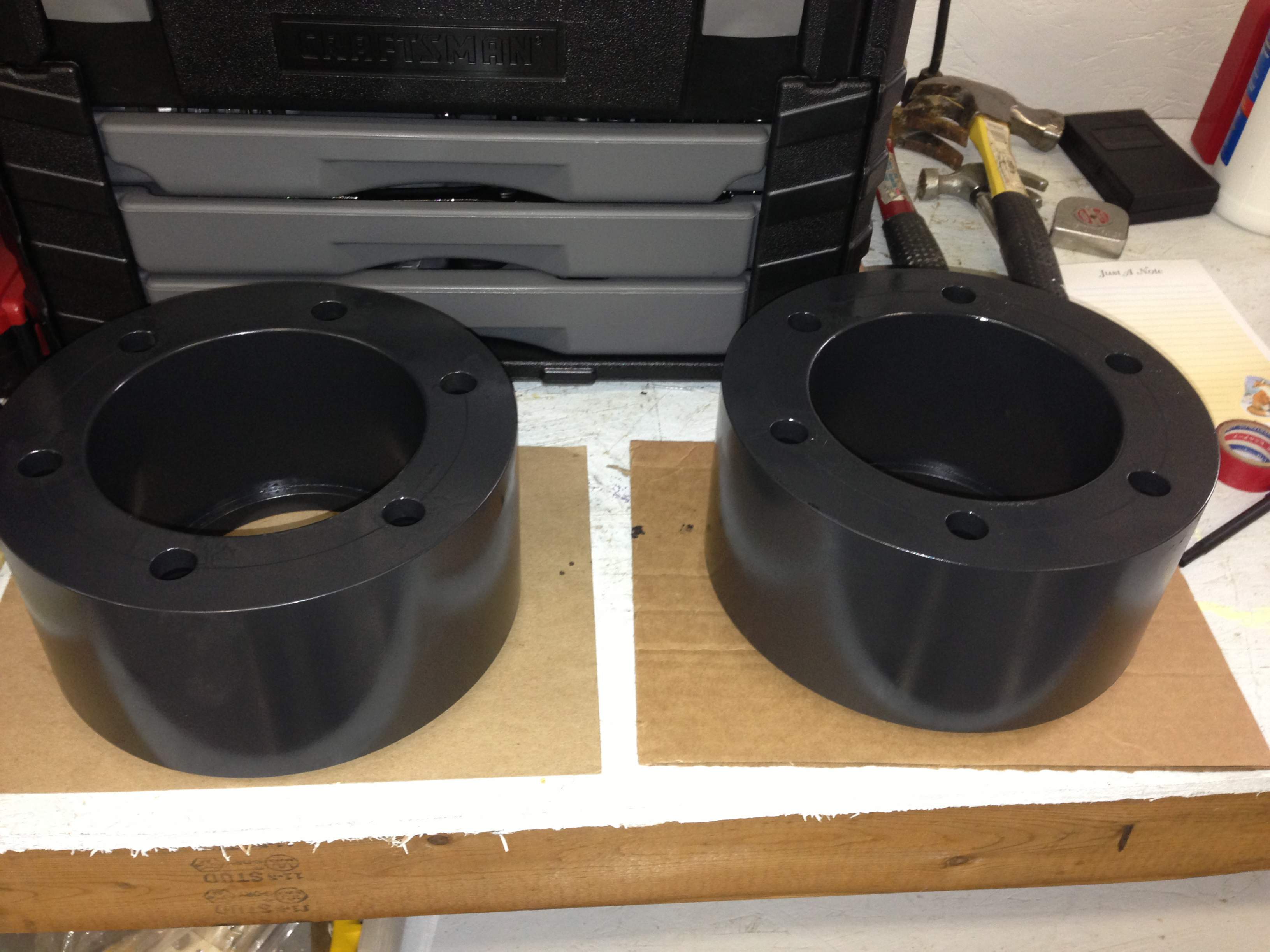

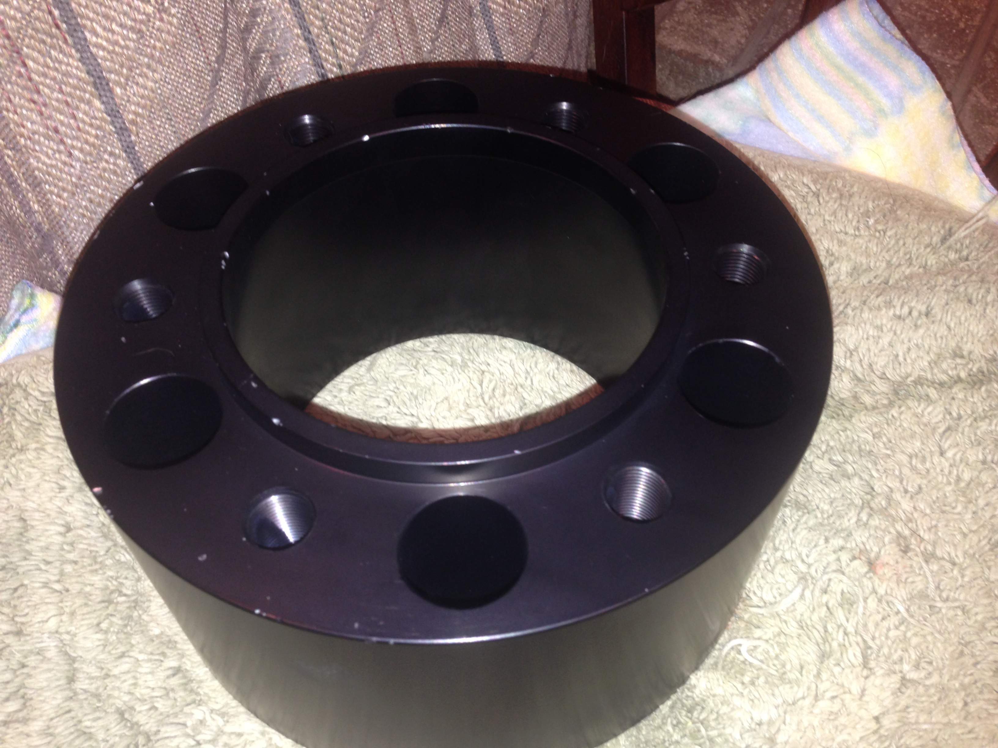

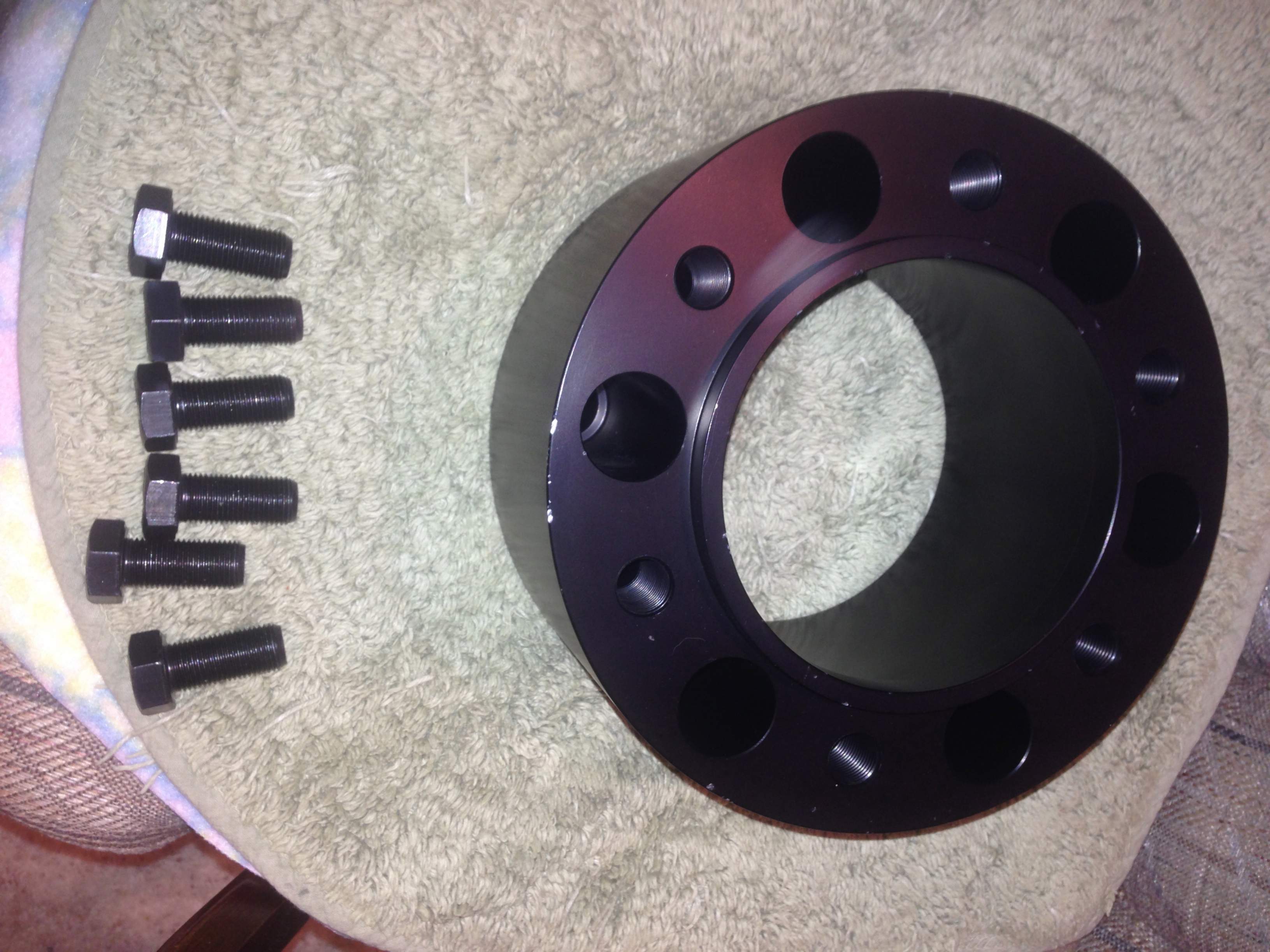

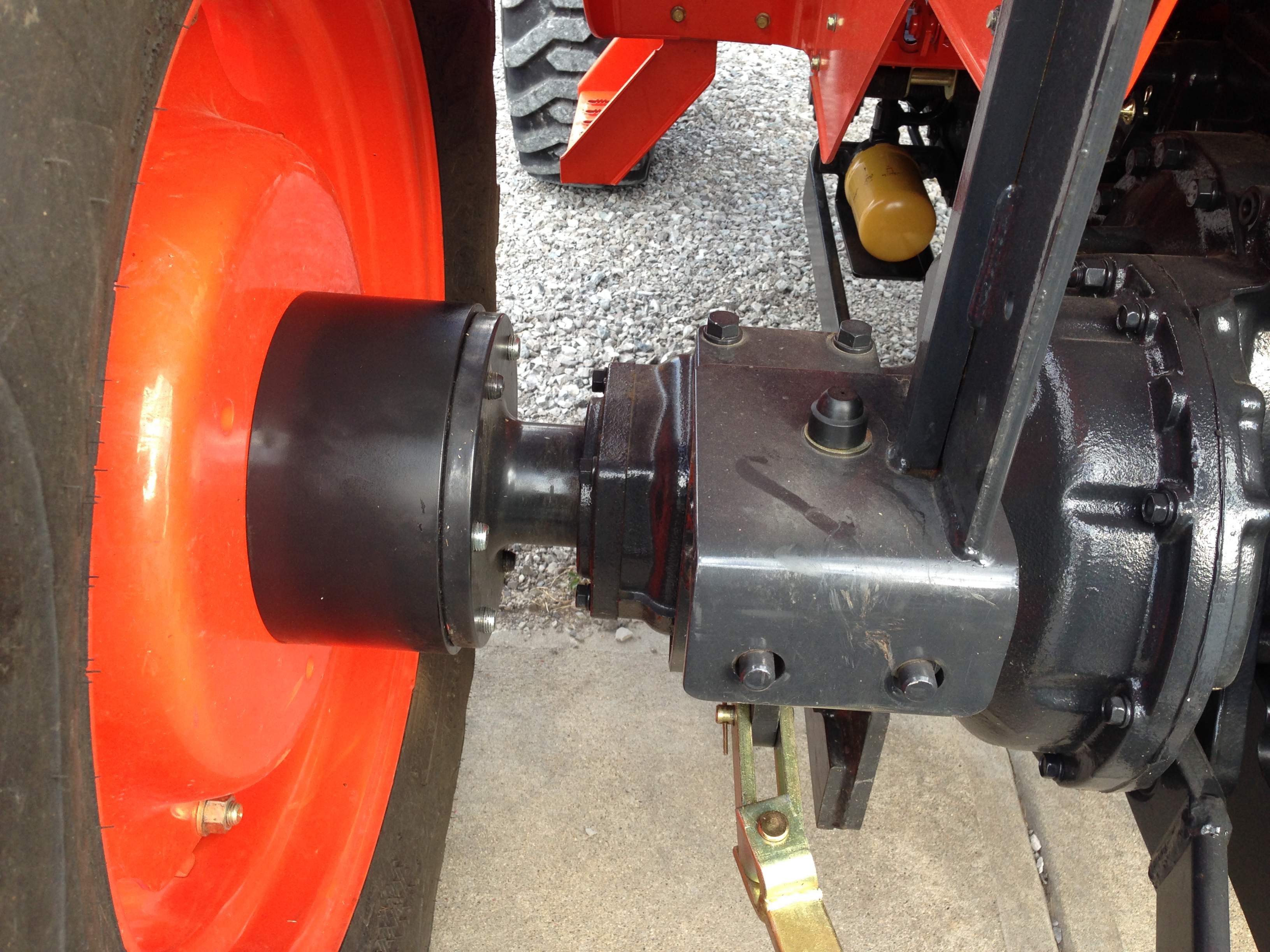

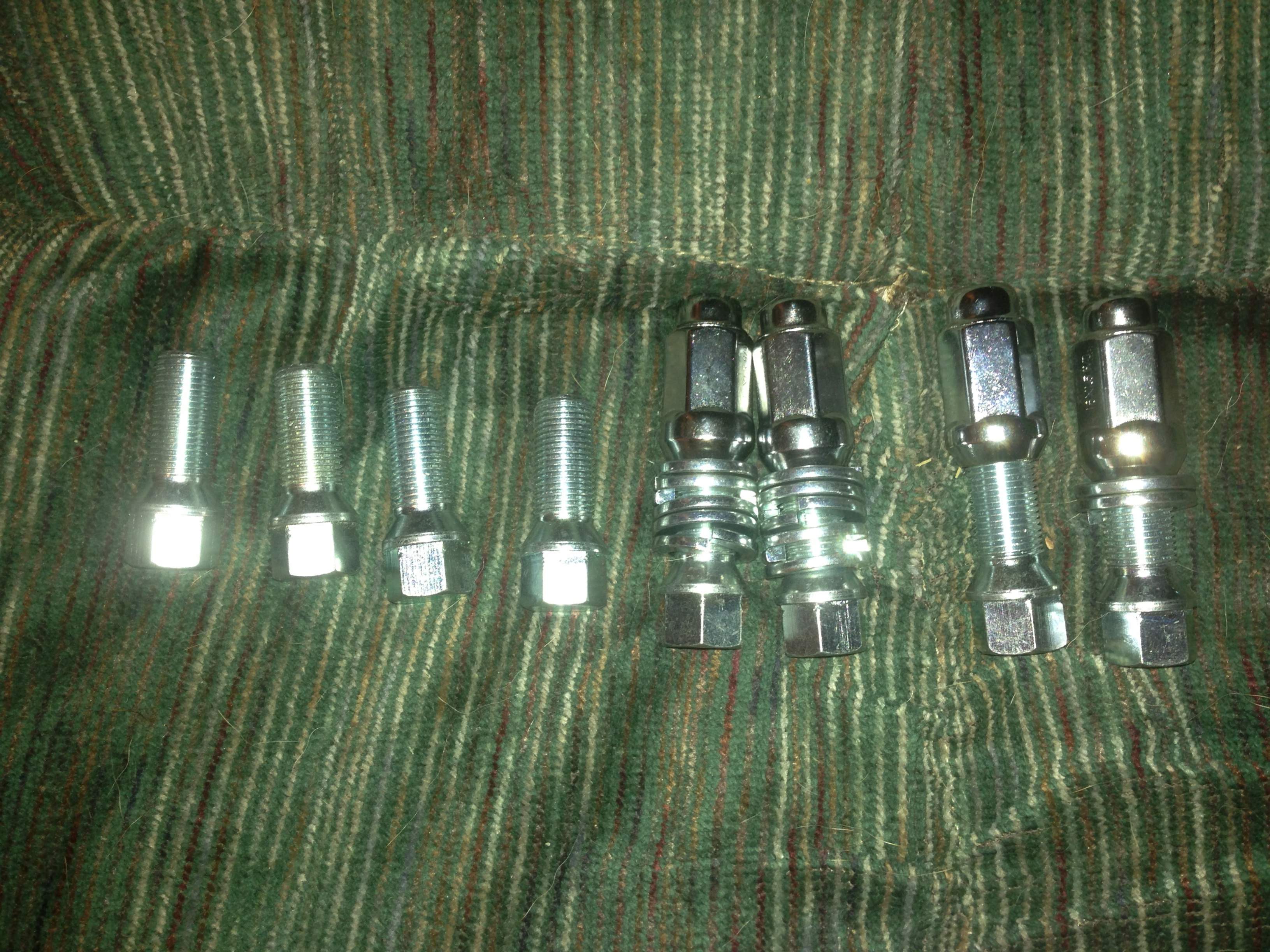

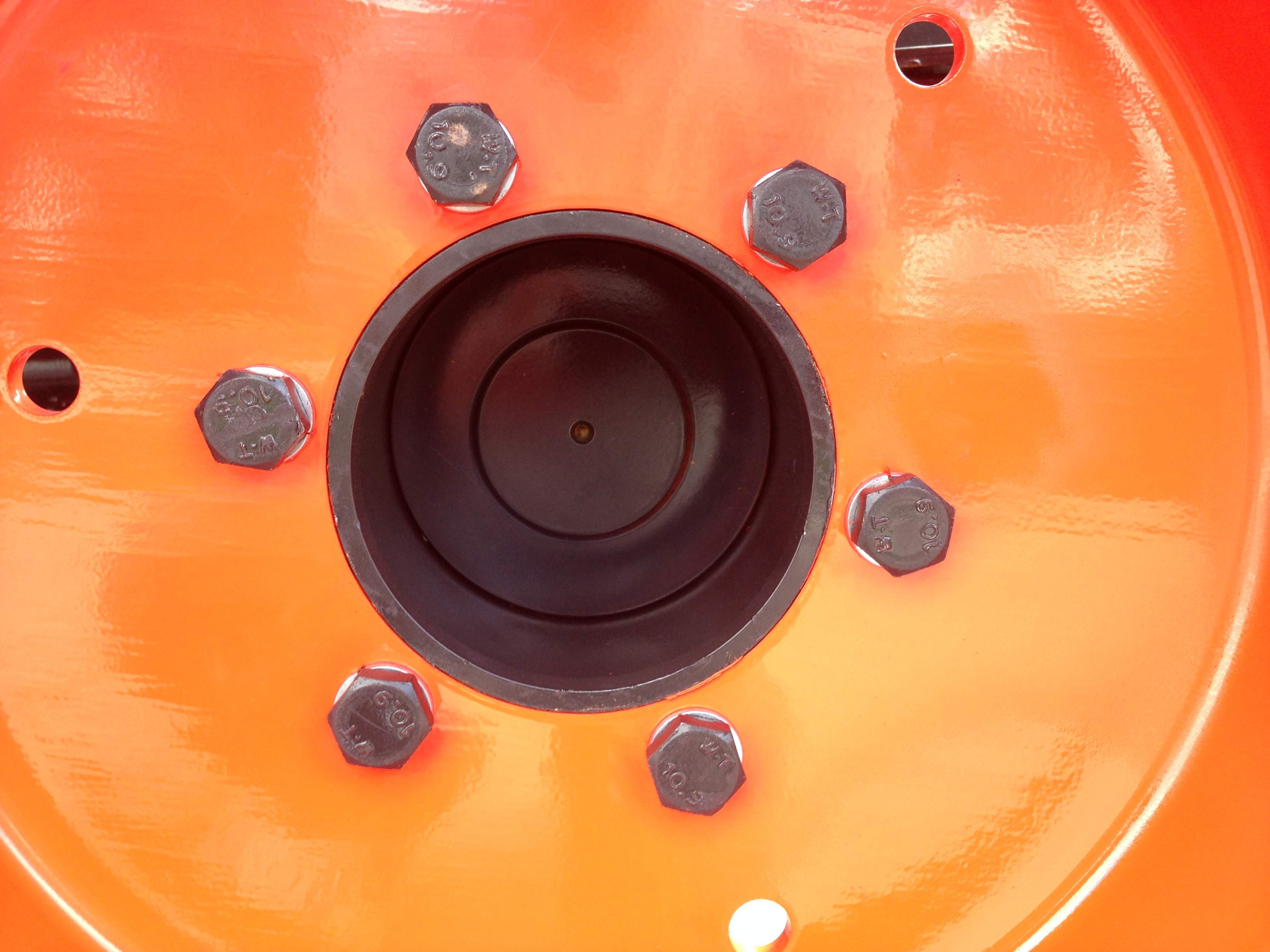

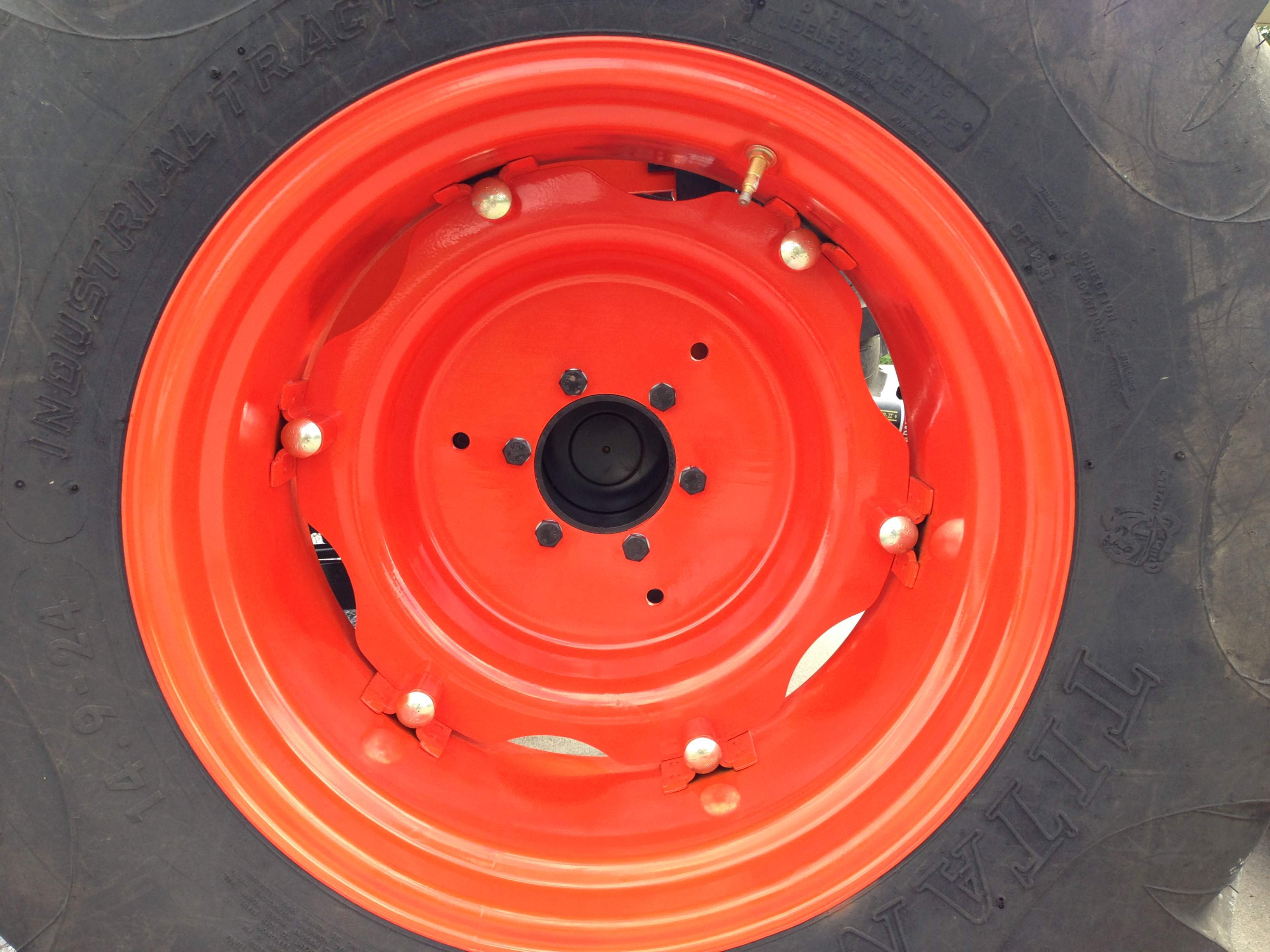

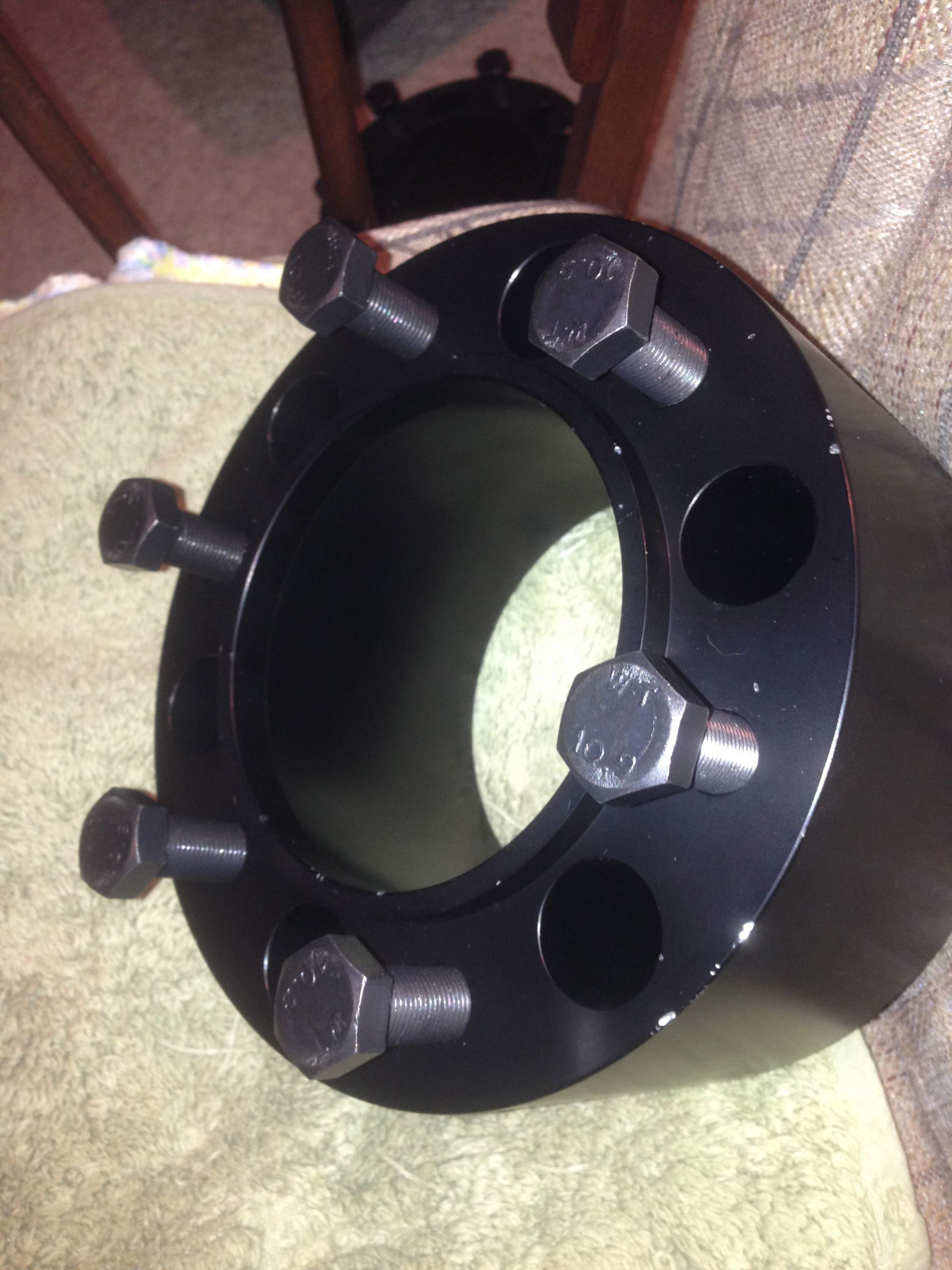

The promised photos with the 4 inch rear spacers.
IMG_0630.jpgIMG_0631.jpgIMG_0632.jpgIMG_0633.jpgIMG_0634.jpgIMG_0635.jpgIMG_0636.jpgIMG_0637.jpgIMG_0640.jpgIMG_0641.jpg
   / Calculating Your Predicted Rollover Angle #38
I'd be a concerned about that 5"? thru-bolt design. You might be luck and It might last forever for you , it might not. Normally you short bolt a spacer from the back to an axle hub and then short bolt the wheel to the front of the spacer, it's a much stronger design. Hitting a jarring bump, could put heavy racking force on those long bolts. Lets us know how it holds up.
#39
DarkBlack,
Thanks for pointing out that long bolts would not be as strong. I hadn't given it any real thought. From the beginning of my negotiations with Motorsport-Tech I was informed they would send me all the bolt hardware. When it got here I didn't have an intuitive understanding of how it would all go together. A phone call to Lenny the owner and he explained it to me.
I threw the pictures up in a hurry today. I should have explained how the bolts provided by Motorsport-Tech work. They gave me six stainless steel bolts per wheel to attach the spacer to the hub through drilled out holes big enough for the bolt heads to fit, and six of the black bolts in the photo per wheel to attach the wheel to the spacer. So all the bolts are pretty much the original length of the stock set up. Here they are painted before installation.

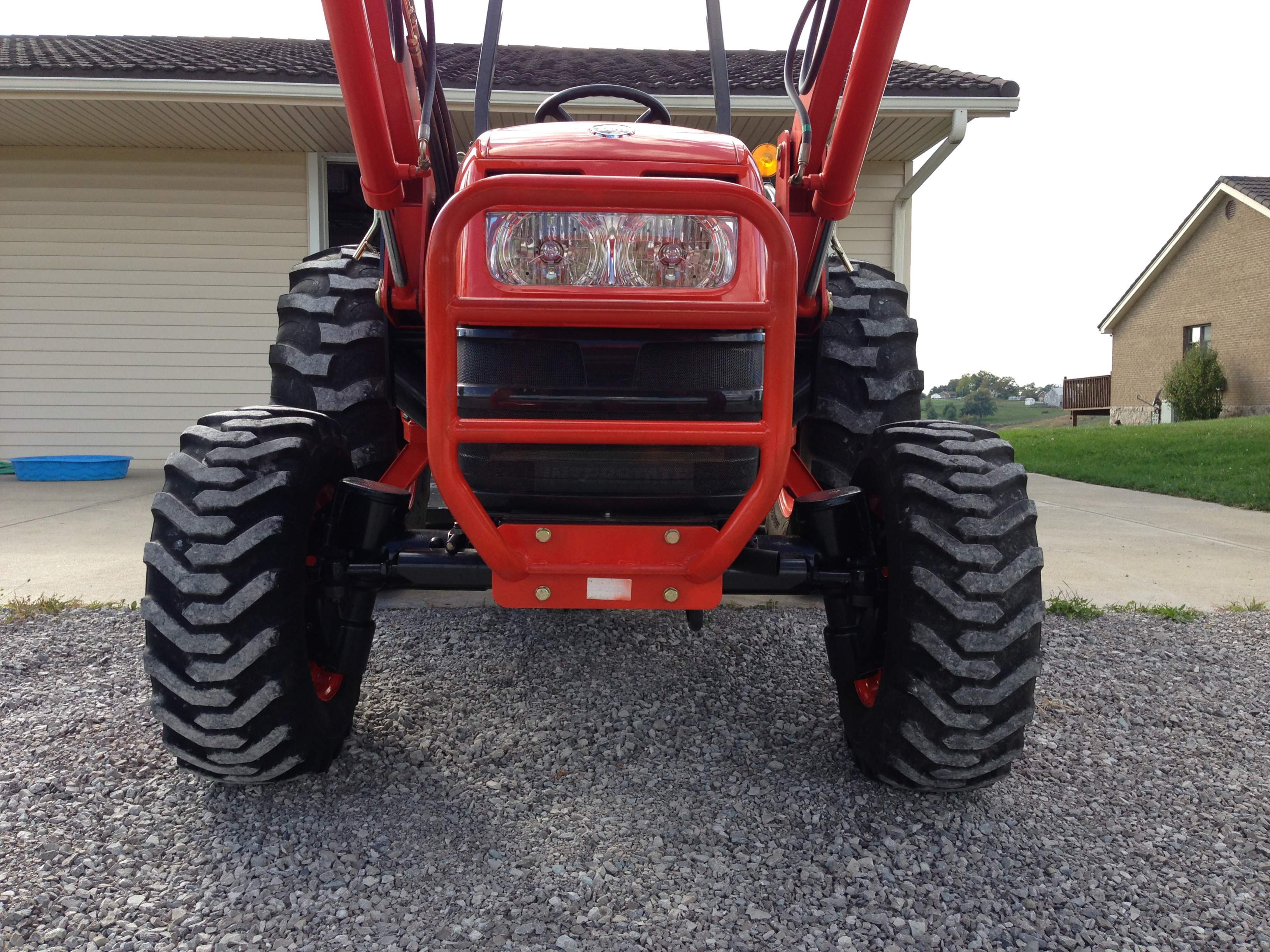

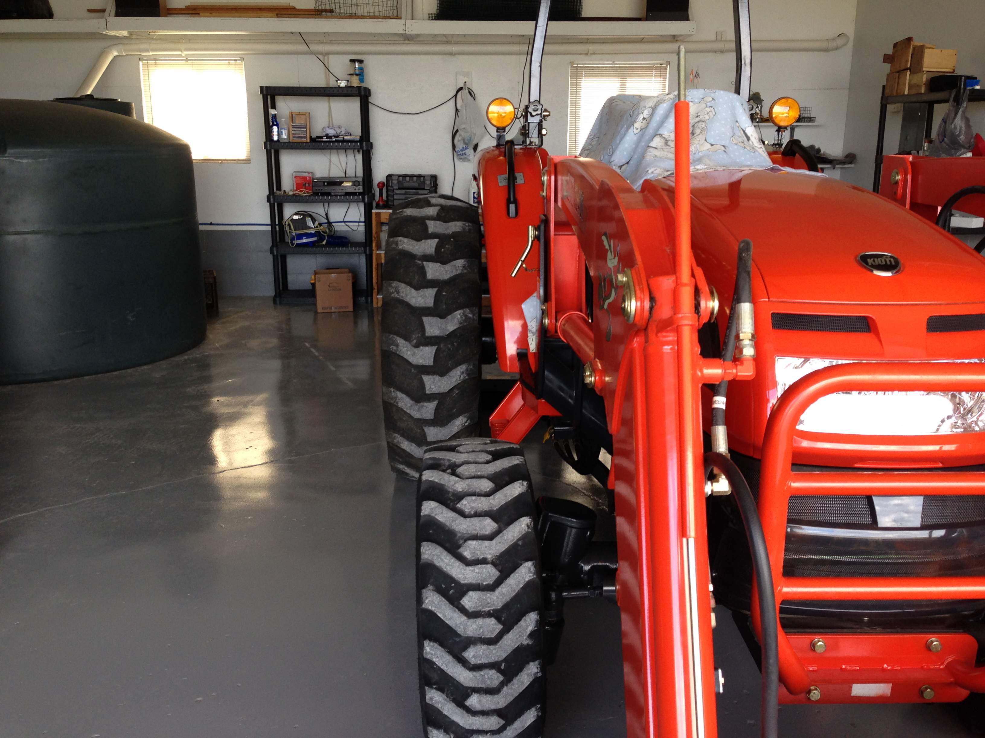

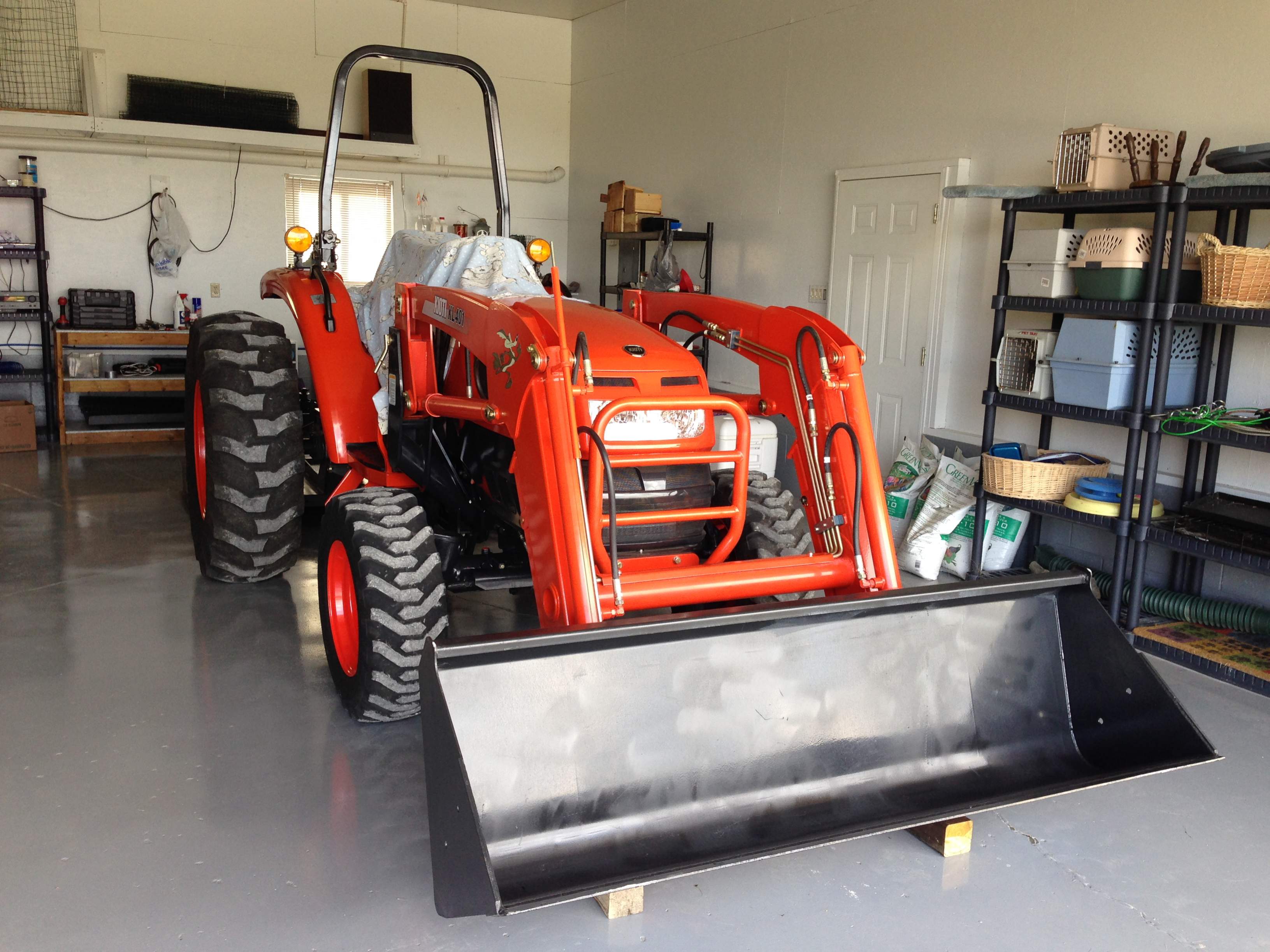

And here is me and some of the hardware the day the spacers arrived! The weeds on the hillside have no chance against me now! A close examination shows there are some scratches in the anodizing layer on one of the spacers - in fact there photos were sent to Lenny to show him how they were scratched. This unusual slight damage was from a few of the bolts getting loose in the box - they were in plastic bags which must have torn during shipping. When I mentioned this to Lenny he immediately offered to make me another spacer, which I declined as I was always going to paint them. I was in high obsessive compulsive mode regarding combating any future corrosion, but the small scratches were not going to make a difference to my tractor - which I'm lucky enough to keep in a detached garage. They painted perfectly. I mentioned it in my OP, but Motorsport-Tech impressed me totally with their eagerness to stand behind their workmanship.
