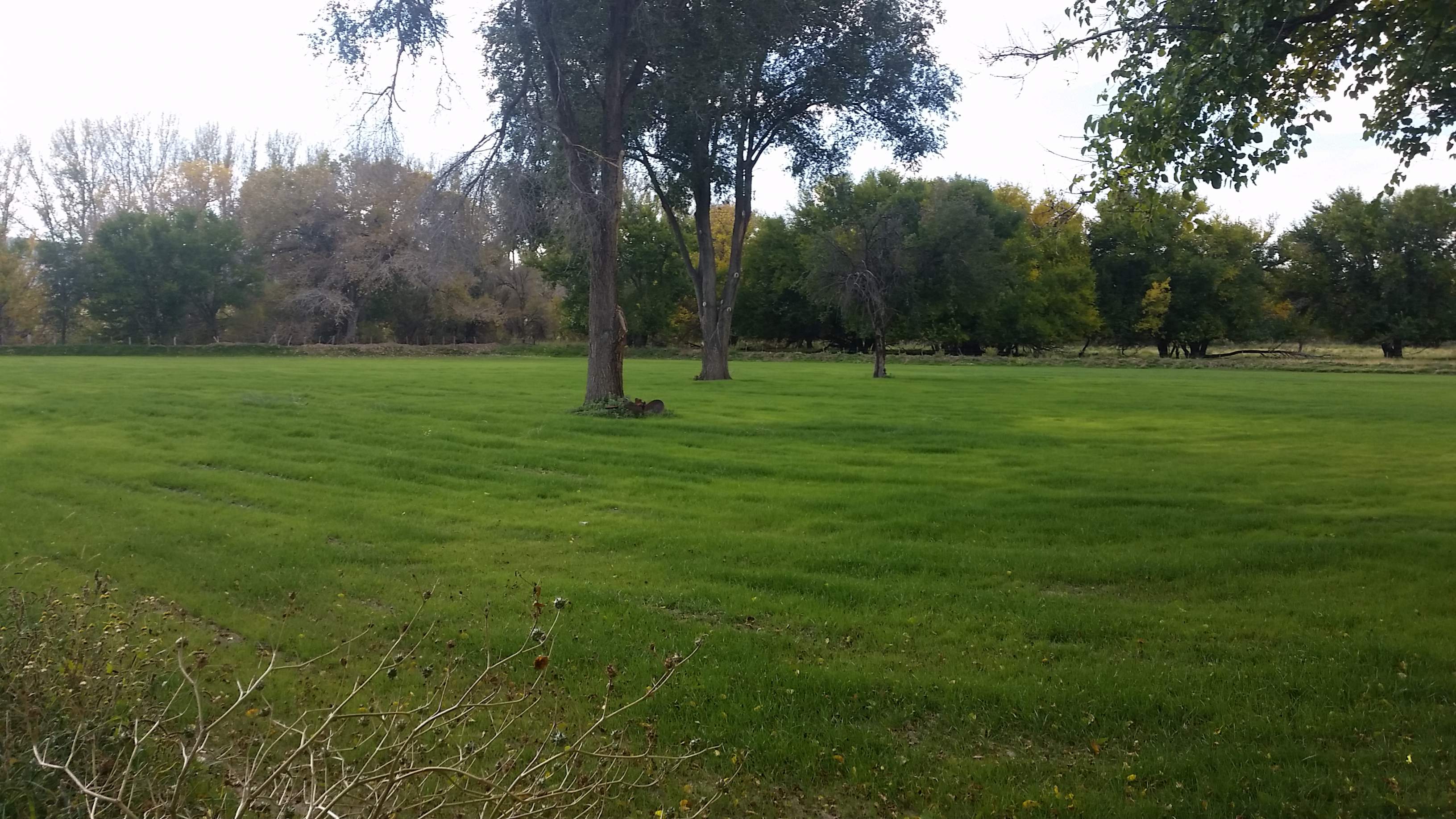

The light application with multiple passes is my preferred method, helps get a uniform seed bed. ^^^^^
I find it hard to simplify this as different seeds and different fertilizers have various distance of throw and flow out the hopper at different rates. Some of the heavy fertilizers may throw 50 ft while a small seed may be thrown only 15 to 20 ft. Lots of variables so I get out of the seat and check the swath width and density on every job. Since seeding and fertilizing goes so quickly a little more time spent seems to be the best bang for the buck.
Here are some time lapse pics, the field was planted on 9 11 14 the first picture is 9 19 14, the second and third are 9 23 14, forth is 10 15 14, fifth and six are 11 02 14.

Something else I have done before is to use 12" white self stick tile in a few spots in the field. With the adhesive turned up the seeds stick to it and I can take these home and get a good idea of the amount of seed density per square ft.
