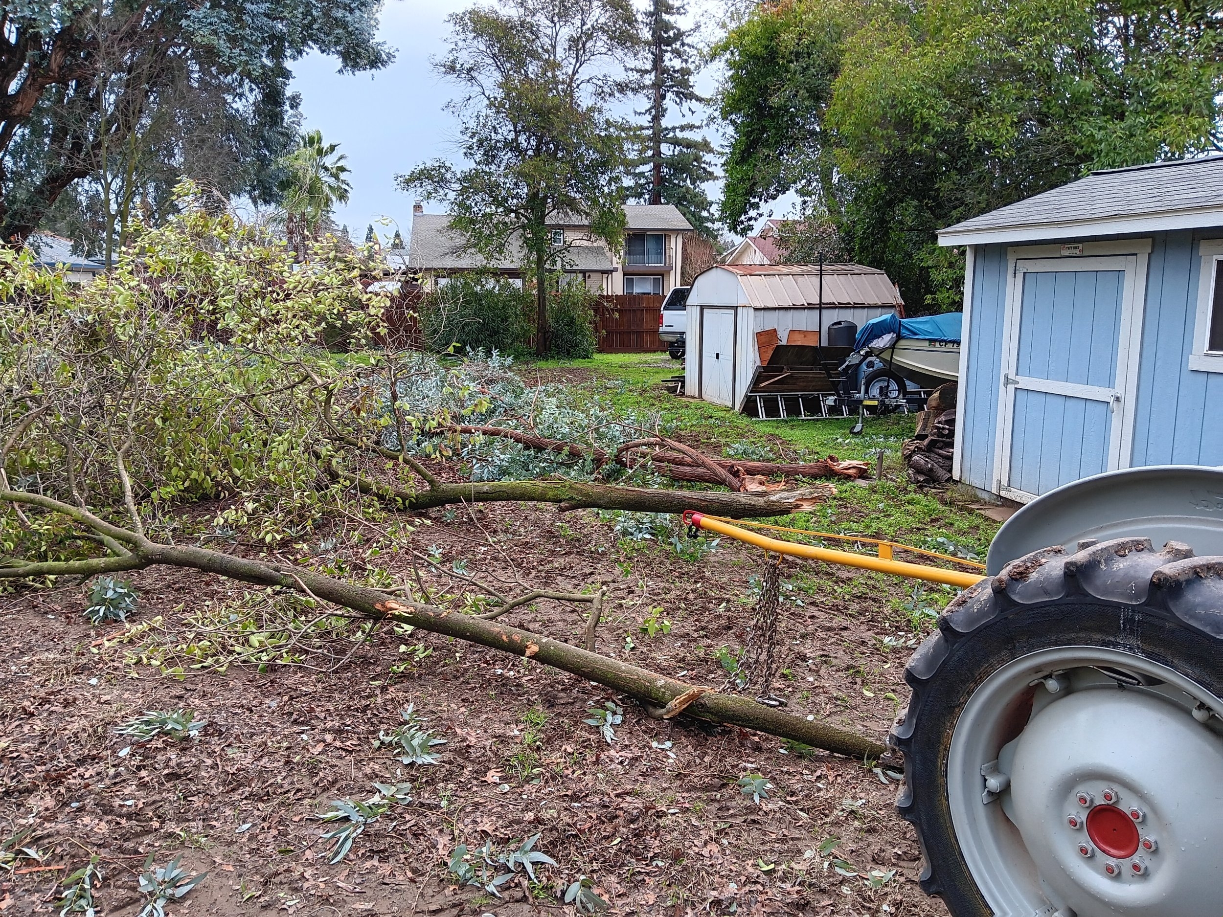

We had quite a wind event here just east of Sacramento yesterday with 60+mph winds.
Power was out for more than 6 hours, but was back on by 10 PM. I had some fence sections blow out; had 2 limbs snapped off my Eucalyptus tree, and 2 more off a nearby Modesto Ash.
Fortunately, I had just finished building a boom pole for my Ford 601, and it worked like a champ to relocate the downed branches.
