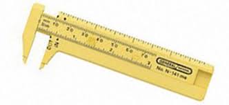

This was the only one I had for years, made of wood :eek:
Now I have a $5.00 HF digital, not sure if that is even moving up :laughing:

I just happen to have a caliper just like yours. It's fine for checking fractional diameters....and it's collectable.
