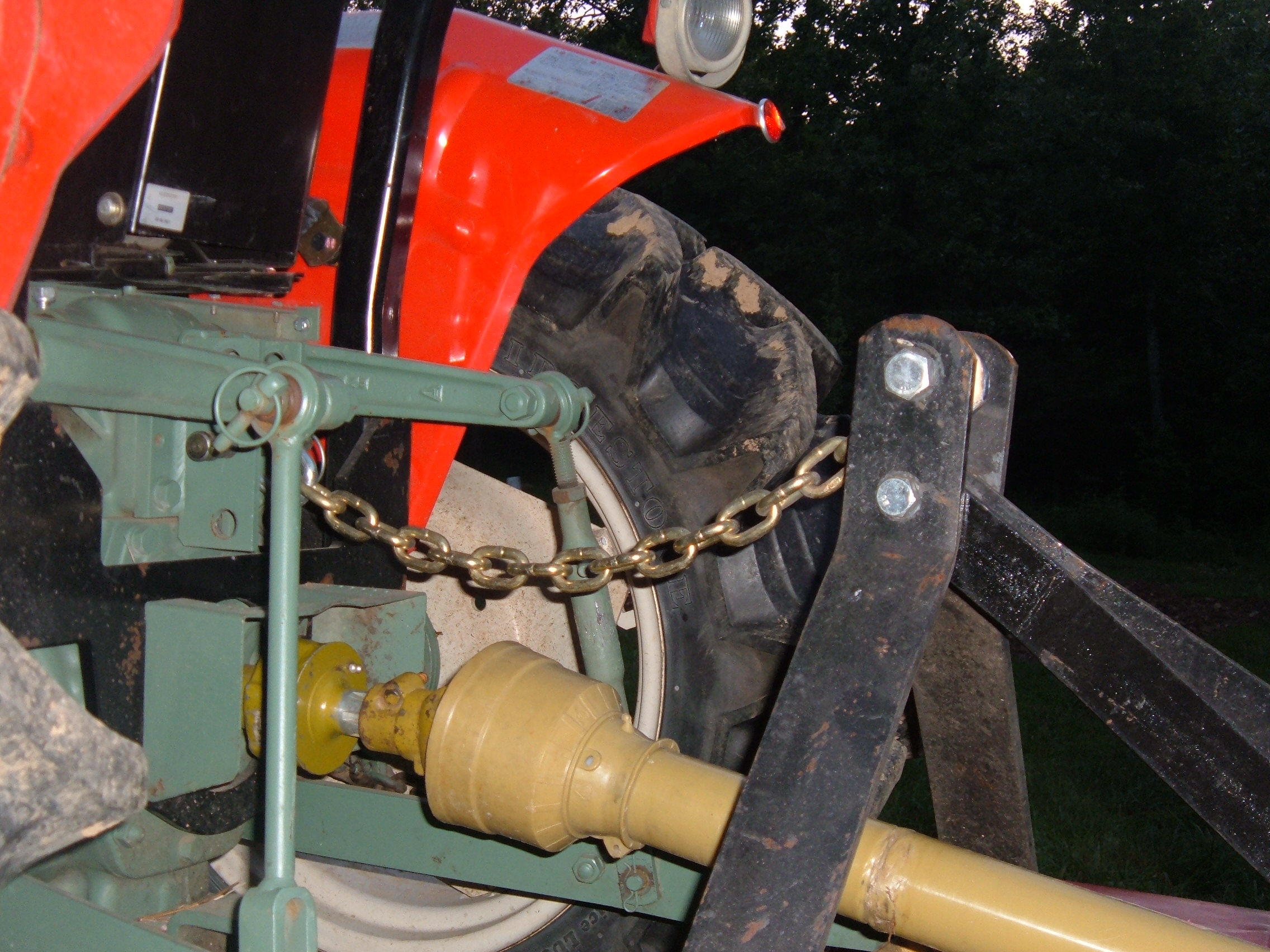

Not my best paint job but it will serve its purpose I guess. It took 2 spray cans of orange, and ¼ of white for my YM’s sheet metal to become protected from the elements. I’ll buff and touch up later, if/when necessary.
The new swing chain is in and after adjusting both there was no more hitting of the tires with my “poor man’s scoop”, bush hog, and box blade. But I did move the lift pins on the inside of all my implements and that solved the “banging”.
My bush hog cuts well but the ground scuffing continues no matter how much I try adjusting it. I’ve not tried the chain idea yet, need to think about it some more, but my unit seems very heavy and don’t know if I’ll ever be able to avoid ground scuffing with the hilly terrain I have to deal with. But at least the results of my first peas, and corn crop planting are already visible, it’ll help keep the critters fed….and maybe some of this food will trickle down to us :D

"My bush hog cuts well but the ground scuffing continues no matter how much I try adjusting it. I’ve not tried the chain idea yet, need to think about it some more, but my unit seems very heavy and don’t know if I’ll ever be able to avoid ground scuffing with the hilly terrain I have to deal with."
Just mow with your toplink removed, same effect.
   / Call me Mr. Lucky
#24
Norm, I'll try it again but mine is indeed one heavy bush hog, tried to lift it a bit without the top link and all it did was tilt. I think the back wheels will have to be adjusted a bit higher but that'll be difficult since all the bolts are rusted to immobility.
   / Call me Mr. Lucky #25
I'm totally confused by what you are saying. Weight is not a factor. The only purpose for your toplink is for lifting the rear wheel of the cutter for transport, otherwise it serves no function, only restricts the up/down movement of the cutter in your case. Your rear wheels totally support the rear of the mower and your lower lift arms support the front. Your toplink does nothing. (EDIT), I should add, the toplink does obviously limit the in/out movement of your driveshaft in extreme movements.

norm, next weekend I'll try your suggestion, and take pictures of the results, with & without the top link connected while operating the lift. I may be confusing the tilting results I got last weekend with the box blade. Getting senile in my old age :)
   / Call me Mr. Lucky #27
"with & without the top link connected while operating the lift."
We're definitely missing something here. You don't operate the lift while mowing, just "set it and forget it", as the guy on TV says, front about 1" lower than the rear, unless you want to transport the mower.

Norm, setting and forgetting was my first instinct but that’s how the land scarring occurred. Again as soon as I get some free time I’ll play with it enough to figure out what the best connect alternative will be.
