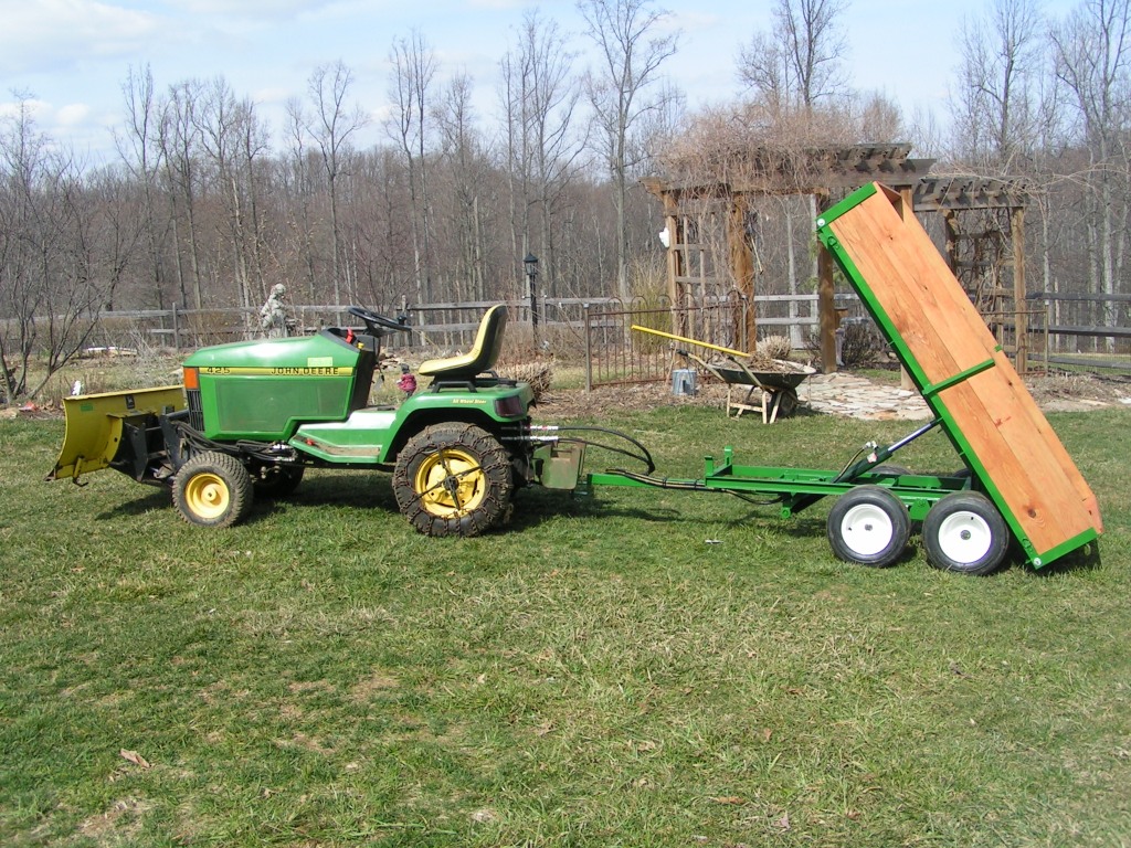

I knew you had both. Just wanted to hear why you liked it better. I have an "old" 425 AWS that I also mow and snow plow with. I have a bigger Kioti CK25 that I bought 3 years ago. When the guy delivered it he said: "I guess you won't be using that Deere to move snow anymore." To which, I replied: "Oh yes I will, that little Deere will plow circles around that big tractor in the tight spaces that I have to work in."
And I'm still convinced of this. I wish it had 4WD like the X749. I was asking because I thought I might want to replace it with a subcut, like the 2305. But, like you, the size of the garden tractor is just way more nimble. Maybe when I wear out the 425 an X749 might be in my future. Just not sure it'll ever wear out, 15 years and counting.
