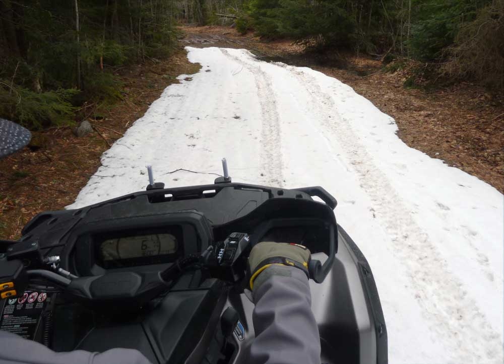

On the road;
1) I would bush hog about a 16 ft path if possible; and use loppers, chain saw, battery pole saw to clear a 12 ft tall path, 12 ft vertically. So you can see what your working with. I assume its either platted road, or a legal easement; atleast 20 ft wide, so, hate me if you want, but OnX, BaseMap, ect should be "good enough" to stay in the easement/road.
2) identify the Bad areas, and just how much Has to have something done, to get a 4wd normal truck in/out.
3) price that those Bad areas out. Keep in mind, you really only Need 8 ft of width in those areas, and there are often, "alternative, cheaper" ways to deal with them. Keep in mind, your money could be destroyed next time they do a major logging job in there, so "nice" isn't the goal.
