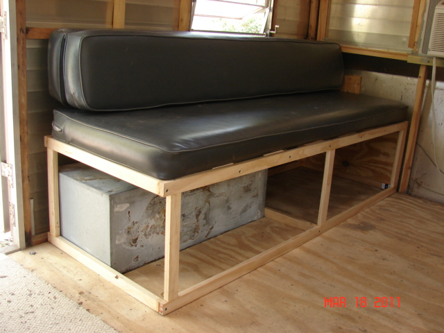

Today I made the decision to pull the kitchenette seats and fold out couch/bed structures due to weight concerns suggested. I will re-build couch using 1" x 2" and possibly the bench seats. I am considering just using comfortable folding chairs/cushions and table in place of kichenette seats for additional weight reduction, cost, building time, and simplicity. Its just me using camper so no need to get carried away. Keep them folded on floor during travel and a quick 1 min. setup at destination. Use them out side if weather is nice. I can carry original seat/bed cushions in PU, fold chairs and table, and sleep 1 -2 simiarly spartan people on the floor if needed. Also, I can build seats at another time if wanted and be on the camp sooner.
I 'll paint the stuff I built with good exterior paint and use them as yard tables around my residence camp fire site. That will preserve my lost build time and expense while putting them to good use.

Radioman, I replaced that clunky 2 x 4 stuff you mentioned to reduce weight. I think it will be a lot lighter. Here 's pix along with build start on kitchen counter/cabinet. I can 't do anything about 2 x 's used from body framing, but the wood is a very light weight low density variety. Gonna go with folding stuff for dinette table/seating area to further reduce weight. I don 't need the cushioned bench seats.

That looks like a 3500lb axle, so your original loaded weight would be around 3000lbs. Mine was....
I'd switch to a 7 pin plug (you will need it for the brakes anyway) and add a 12v battery (Optima preferred) on the tongue. Hook up your wiring so the battery is on the ignition side of your key so it charges whenever the truck is running. The 7 pin plugs have a standard wiring connection that is shown on the plug. That way you can also hook up to anyone elses trailer and all your lights/brakes will work. They could also tow your trailer in a pinch.
Unplug the trailer when you camp so you don't kill your truck battery....

I know we talked about weighing it in the brakes thread, but if you can lift the tongue easily - while claiming to be small, weak, aging and getting weaker (-:
Then I suggest when you load up those water jugs you put them as far forward as you reasonably can.
It sounds to me like it might be tongue light - and will therefore probably be sway prone.
