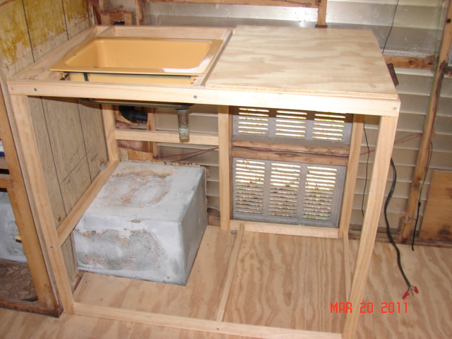

Got Galley/Sink ruffed in.

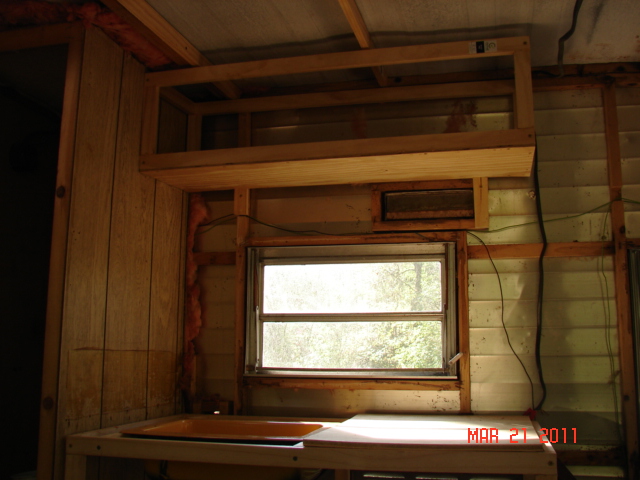

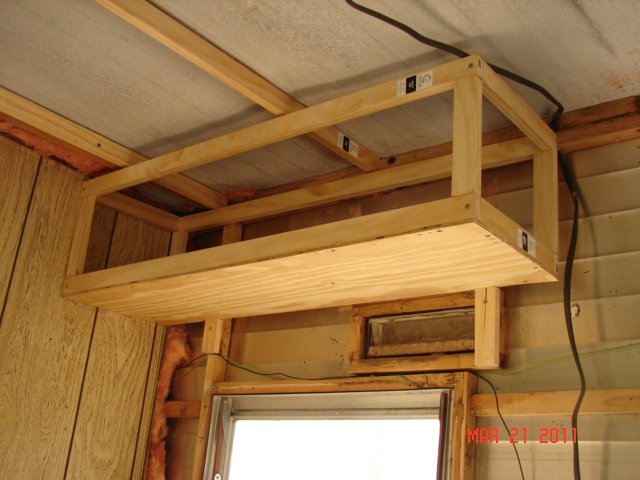

Overhead Galley cabinet is framed and ruffed in place. I 've saved the original stove top heat vent ( not in pic. ) for installation.
