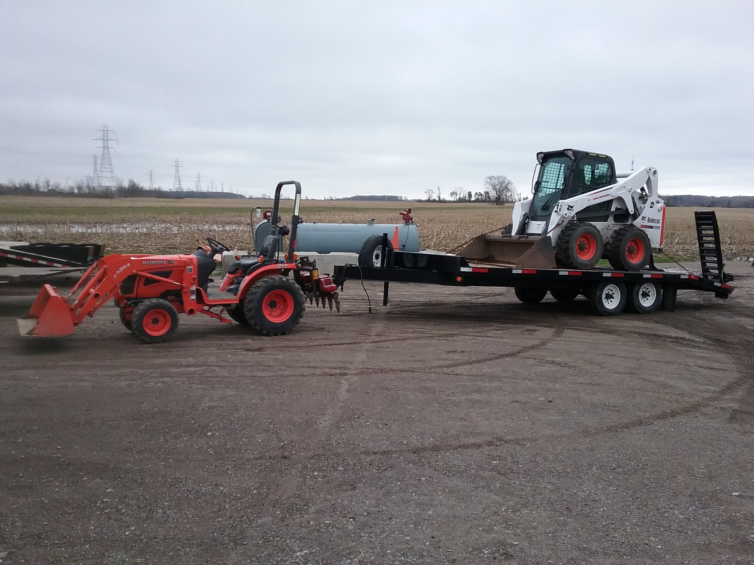

As they say, a picture is worth 1000 words. I use either a little tiny b2920 or an l3200 to jockey trailers around without issue. Heres about 11000lbs getting towed around by a 1500lb tractor. Its just very important to stop and turn slowly. We could go round and round about how steep the hill are and how slick and deep the mud is, but the definitive answer always will be that it depends.

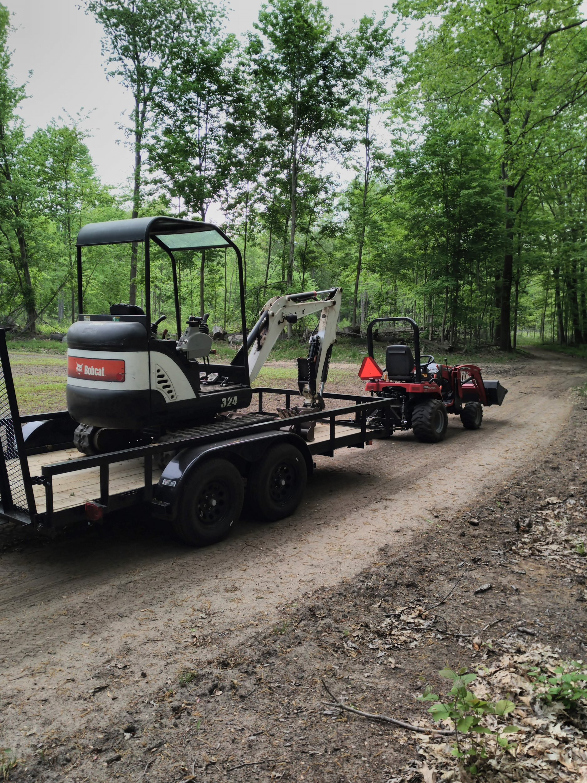

This little 22horse Massey pulls the mini through the woods all the time. Even the little guys can do it.

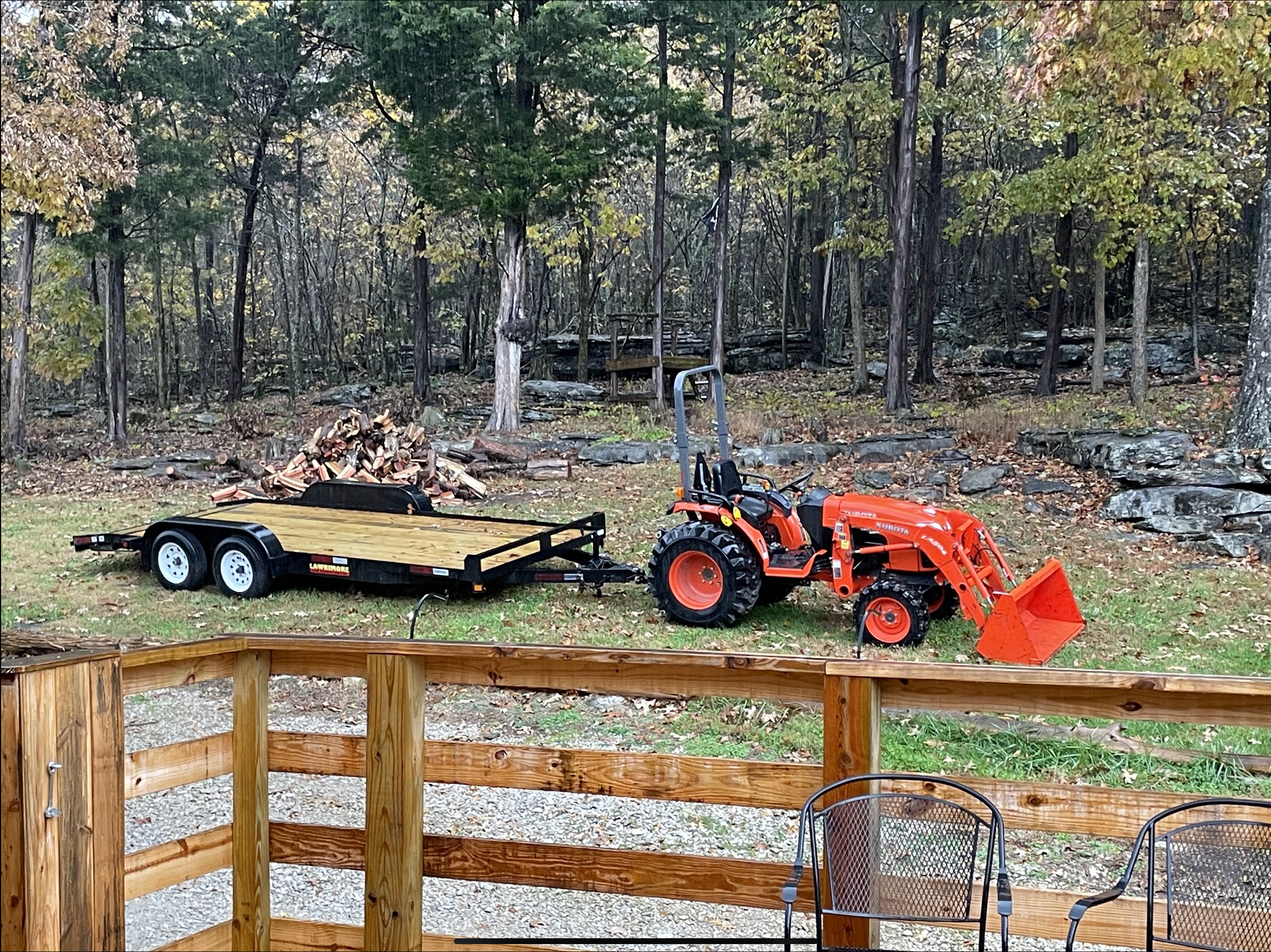

Absolutely - My Doolittle Tilt bed Ezloader weighs 3700 lbs. I move it all the time with the tractor. It can get the trailer in parking places that the truck cannot.

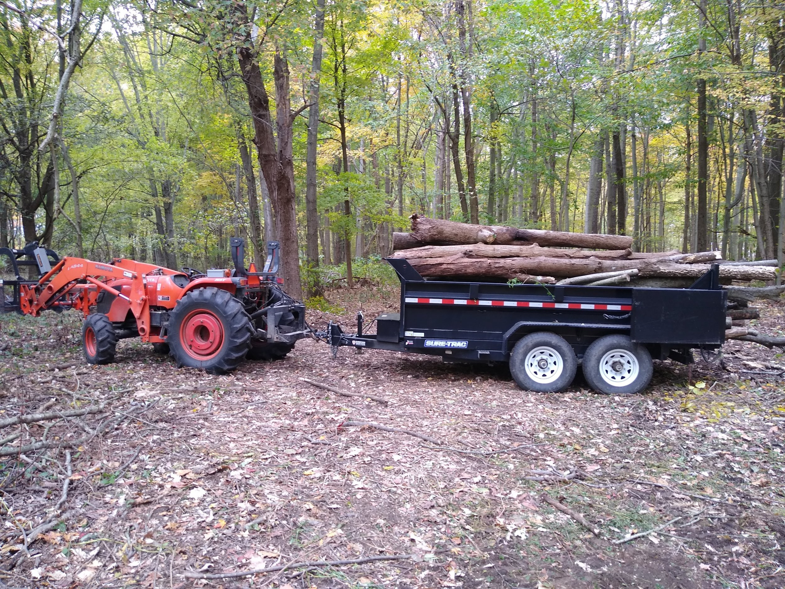

I haul a 12k dump trailer with about two cord of logs behind either a L3400 or MX5100.
Also use the MX to pull a 12k 22' equipment trailer with a 8000# mini ex around the fields when doing drainage repairs.
Terrain is everything. Most people I know don't set a trailer up for brakes on a tractor. So going down any kind of grade can be sketchy if you have a 11000# load behind a 2500# tractor.

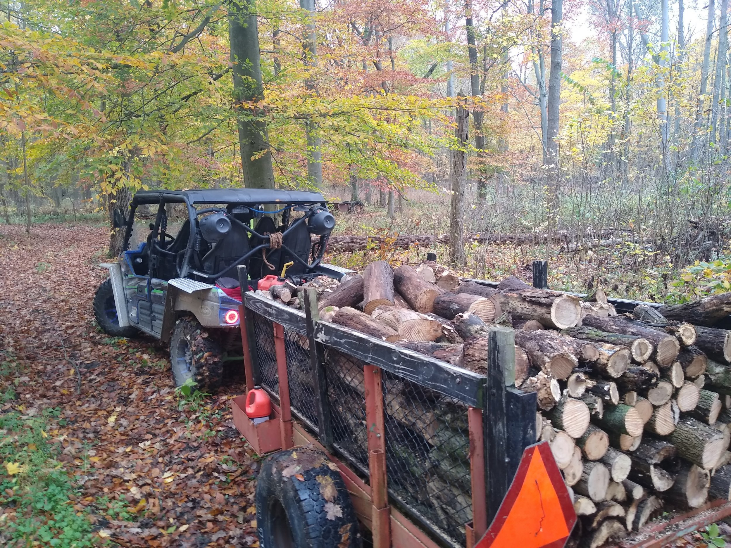

Heck my little sxs can even pull a half cord trailer of firewood. This is a homemade trailer 8' long, 4-1/2' wide and 2' sides
