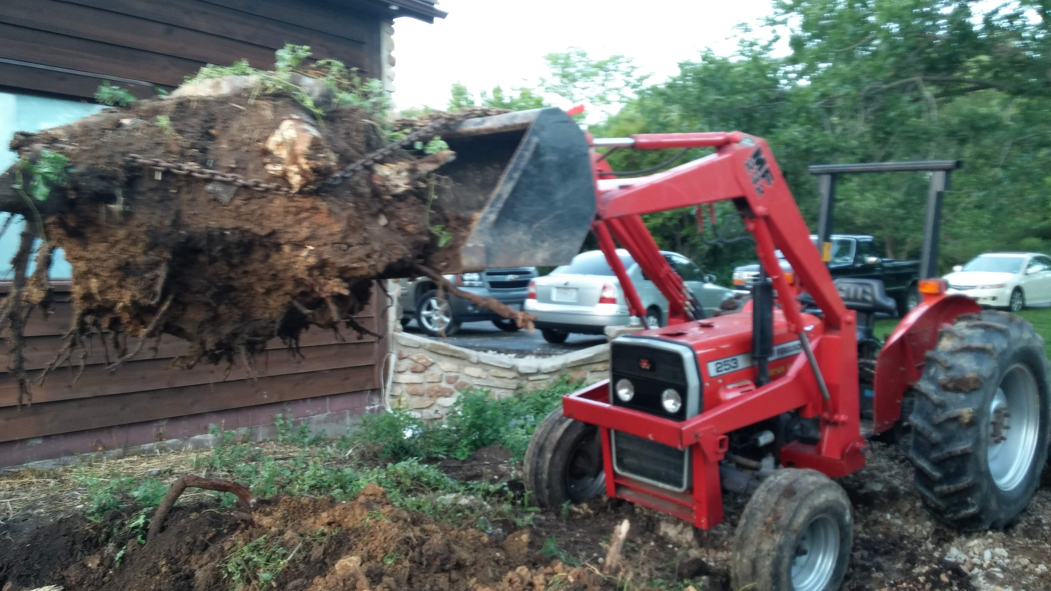

fisheye,
I have a small backhoe attachment (John Deere 46) mounted to a small 4WD tractor Yanmar YM2210D. I have used my backhoe for digging out stumps, digging a foundation through tree roots, setting large fence posts, digging up concrete driveway pads ...... I could keep going, the backhoe attachment is probably one of the most useful things that I have ever bought. I would buy it again in a second. However, it is small and does not do large jobs quickly. If you have the time, and as long as the backhoe has the reach and depth that you are wanting to accomplish, I would think you would be pleased if you are a do it yourselfer.
One word of caution, even though I am amazed at what can be accomplished with my little backhoe, if you have large/heavy boulders, the little guy does not have the hydraulic force necessary to do what the big dogs do, so depending on your individual situation, a small backhoe should work for you as long as you have determined that your job is within the capabilities of the backhoe unit.
I just dug out a good sized stump a couple of weeks ago with my backhoe, the tree was about 24" diameter, and the root ball was about 6 feet in diameter. As you can see in the pic, some of the roots were big and the little backhoe got through them with some work. Just to give you an idea of time needed for a small backhoe, this stump took about 2 hours to dig out. I estimated the weight of this to be about 2500 lbs. So with some time, the little backhoes still can get the work done.
