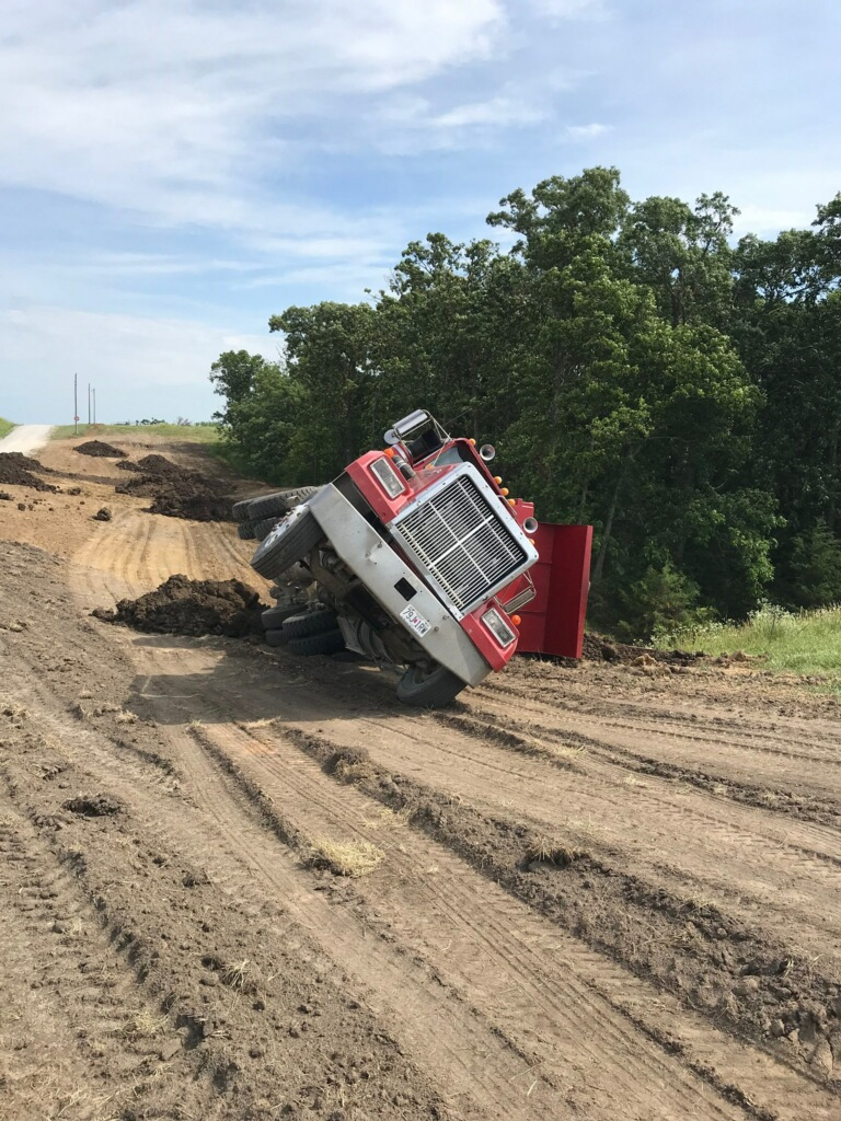

Heres a very expensive rollover

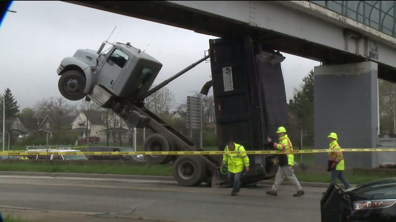

Don't forget to let the bed down after you dump. We had a guy here, took off with the bed up. Took out all the power lines and red lights in town on his route. But, when he hit the river bridge, the I beam shut him down. That is why insurance is costly.
