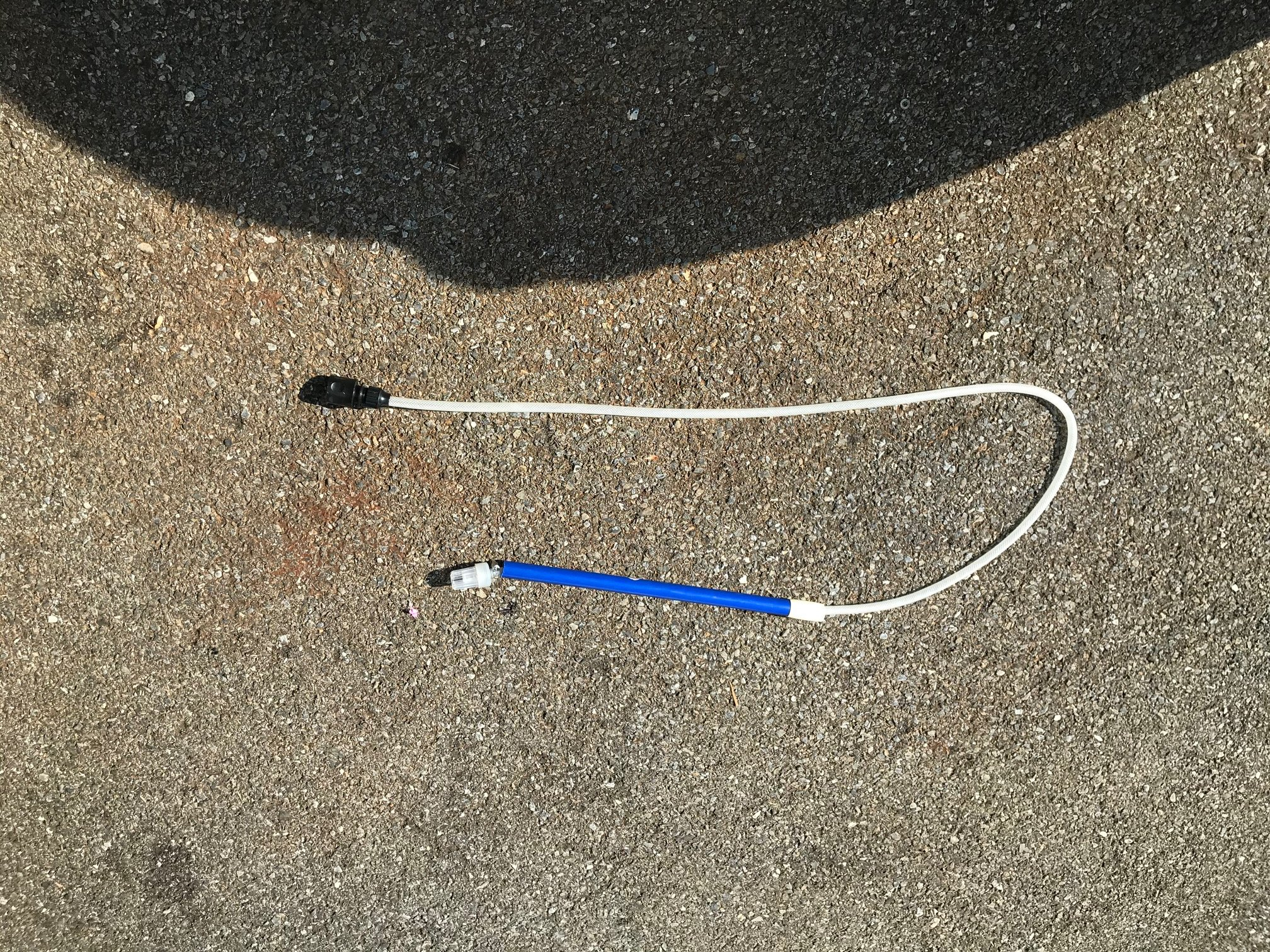

Doubt that it's a recommended use, but last week I used a DeWalt 20V pressure washer to spray Liquid Sevin where I couldn't reach the height needed with the regular sprayers. Made up a short hose with the strainer on the end to drop into a 2-1/2 gallon jug. The blue sleeve is part of an old broom handle to keep the strainer from floating up. Used the 0 degree tip from my real pressure washer.
Real long story about the Japanese beetles and our linden tree, but the systemic pesticides weren't working. One time I did fab a long extension for the regular garden sprayer. Another time I made up a pressurized tank from an empty R22 tank. Once I borrowed a bucket truck. This is by far the easiest method. A good still morning and you're in business.
I bought the little DeWalt "pressure washer" (quotes because 550# doesn't qualify as a real one) to do the Kubota in Winter after travelling on the salted roads. Much easier to fill a 5 gallon bucket and use it than to drag frozen hoses around. A local hardware store had the complete kit for $99. That's like buying a battery and getting the rest for free.
